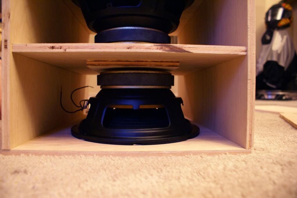

Construction photos of halfinator:
Inching my way along, but the pieces are slowly fitting together. Takes a lot of freggin planning ahead just to build a rectangle! I had no idea.

Seems to be quite a gap on the 2nd picture. Any idea why that is? Is the sides 300x300mm (11 13/16" x 11 13/16")?
Saturnus, the overall dimensions of the box are 295mm x 544mm. I am using the halfinator 2013 sketchup design by Rubenn. It seemed to have the correct updates from what I could tell (such as separate L & R instead of holes, two reflex ports, etc)

Actually, right now I have it at 555mm. I could be misled here, but I made it a little longer as from what I could tell, erring on the side of too large is better than too small. I can cut away if it's necessary, though!

I'm afraid that drawing is incorrect and too big. And your drivers will neither fit nor work as intended.
Use the original drawing of the full Boominator and just cut one speaker section off and add as much room for electronics as you need. Some use it for a passive speaker to be pole mounted so they cut the electronics compartment completely.
If you want to separate the two sides, despite my recommendation not to, and instead make sure your mp3/aac files or sources in general is either mono, or joint stereo compressed which will make them mono in the bass region (this is the normal setting for mp3/aac compression and almost all mp3/aac files you buy/find on the internet will be in that format already), then you add 12mm to the length of the speaker section and remove the handle/port. That is all that is required apart from the obvious adding of 2 round ports instead of the handle/port.
In addition, it might be a good idea to pad the center brace with felt in that case as it now doesn't function as a diffuser but will instead reflect midrange frequencies back into the speaker cone.

EDIT: It's not a major disaster as it means making all the pieces, except the ends, smaller, and the end pieces can now fit on the outside instead of the inside if you're running out of room for electronics.
EDIT2: I also have to note that due to slightly changed dimensions of the GW1058 since I last bought some (in 2004 or 2005) it is necessary to route out some of the bulge on the back about 3mm in depth, or use 9mm pieces instead of 12mm pieces.

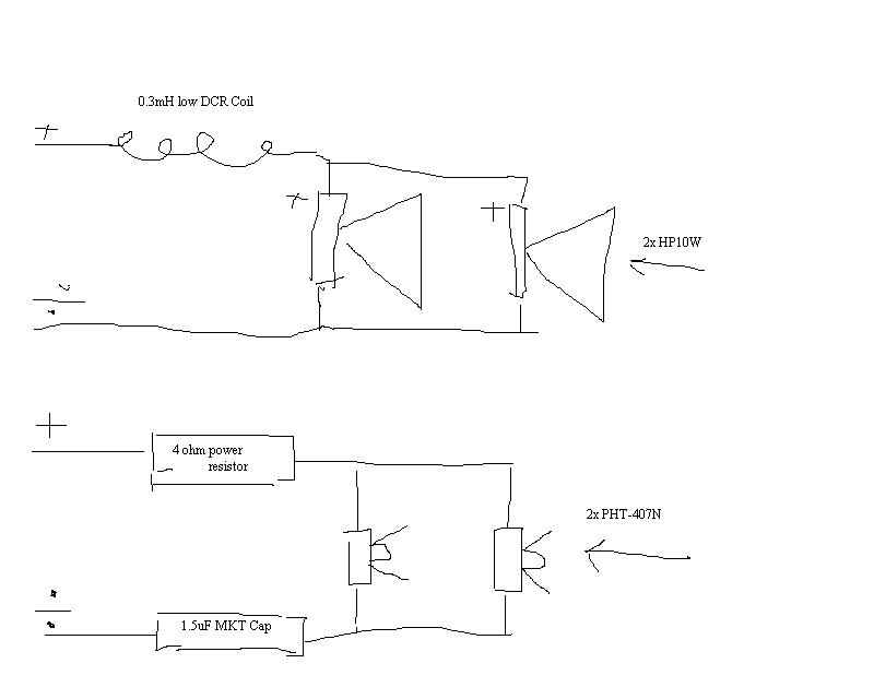

thanks a lot for your help, im looking at crossover parts from this schematic,
http://www.diyaudio.com/forums/atta...er-stab-ultimate-party-machine-boomfilter.jpg
can you tell me if they are correct.
Monacor 0.33mH Air Core Coil/Inductor 100W 3.77
Monacor :: Monacor LSR-47/20 4.7Ohm 20W Ceramic Resistor 1.12 IN STOCK (21 Aug 2013)
Monacor :: Monacor 1.5µF Bipolar Electrolytic Capacitors (pack of 4) 2.40
the coil and resistor im unsure of , the capacitor seems to match up.
should i wire them all to a board upon leaving the amp and do an identical scheme for the second channel.? blue aran don't seem to have boards to wire the componets but im sure i will find one.

You can use that filter but I'd recommend using the updated one. Brummiejon posted it on the previous page. He might also offer his opinion on what he ended up using as resistor because that was a part I wasn't completely sure of the correct matching for 4-6-8 ohm are possible choices.
http://www.diyaudio.com/forums/clas...ab-ultimate-party-machine-84.html#post3595711
I can say that I very much dislike wire-wound resistors, and much prefer metal film instead. 5W is plenty. Get them here for example. They are also cheaper.
Mundorf M-Resist 5 Watt Metal Oxide Film Resistors - Hifi Collective
I also suggest MKT or MKP type capacitors instead of bipolar electrolytes. Might as well get them the same place as you get the resistors.
Mundorf Mcap MKP Capacitors - Hifi Collective
The inductor from Monacor is fine.
A piece of masonite is excellent to glue the components on (separate pieces for each channels). I suggest having the filter in the electronics compartment if there is room. That makes it possible to adjust later, or upgrade to active filtering at a later date.

hi brummie jon
im going to be using hp 10 w and the 407n's could you enlighten me on which schematic you used the one in your previous post i am unsure as to whether that was for the basslite set up or for both, what have you used for your crossover? could you point me in the direction of the parts please im getting confused with all these numbers and letters

This is the filter I used for PHT-407N and HP10W...... However, I wired two of the 4ohm resistors in parrallel instead of just the one..... Saturnus reccommended that I experiment with this idea and the tweeters are slightly louder as a result (with two, 4ohm in parrallel) and I prefer it (I experimented it both configurations but I like my top end).... I used wite wound resistors because I didn't know any better, next time I will take Saturnses advice.....
The end result for me is a very detailed sound, I haven't measured what is going on with a spectrum analyser but it sounds great to mine, and everyone elses ears. Audiophiles and non-audiophiles all comment on the detailed sound quality, people are not used to hearing such hi-fidelity outdoors........
I found that I couldn't fit the crossovers in the electronics compartment. However, I can easily rewire to bypass the crossovers at a later data by removing the tweeters and I can pull out enough cable to reconfigure....
please please, tanks in advance pal

right, just to be sure i get the right resistor, can someone please point out the ones i should get from this selection
many thanks , its just i can't work out which ones are 4 ohms. 🙂
