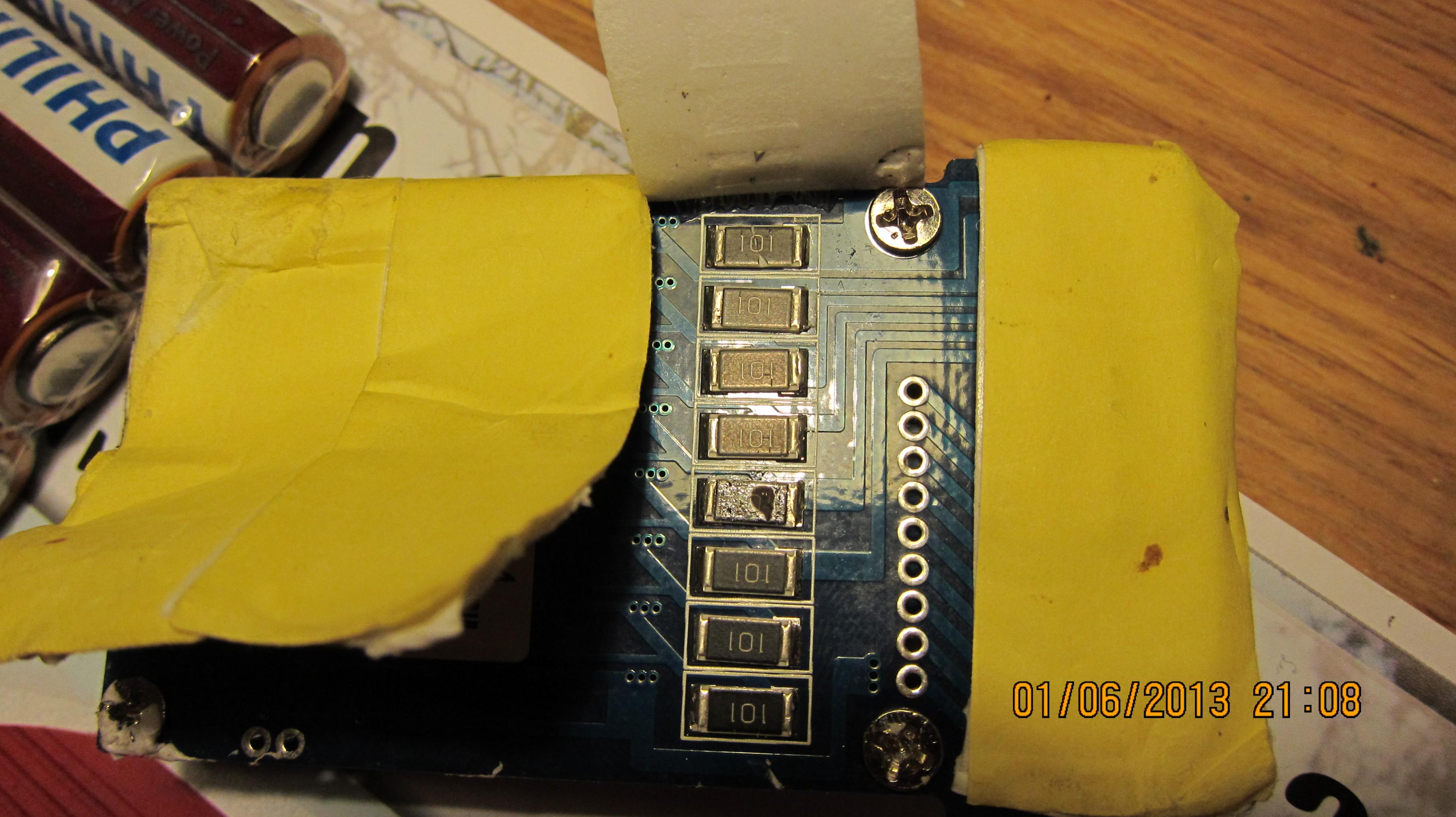

Building AMP6
Oh dear.... I feel right out of my depth..... Faced with lots of tiny things and I don't know what they are, how do I know what the polarities are, I can't even read the values......
I'm going to need some help.....
I don't think that 41hz did include the boominator mods... Here is the best photo I can manage of the input and feedback resistors, I don't know which is which?
BJ

Can't help you with that quality of picture.
google resistor color coding.
Hmm quite.... Pointless photo..... Will do more research and enlist help from a friend..... Thanks
