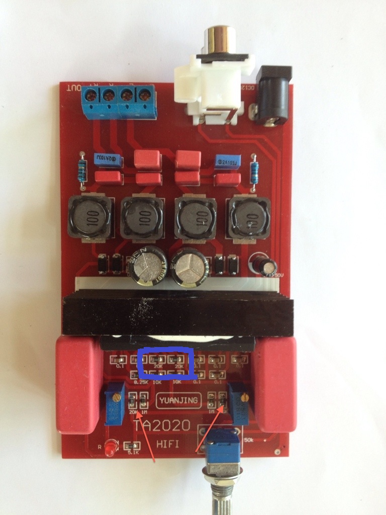

EDIT: If you can you can also remove the 2 feedback resistor (marked 20K) and replace them with resistor of higher value. That will increase gain. 82K ohm will be good for low output device. 100K only if you have extremely low output devices but then it's better to have a preamp for that device because it also raises the noise floor. Not very noticeable outdoors though especially compared to indoors but can be a little annoying.

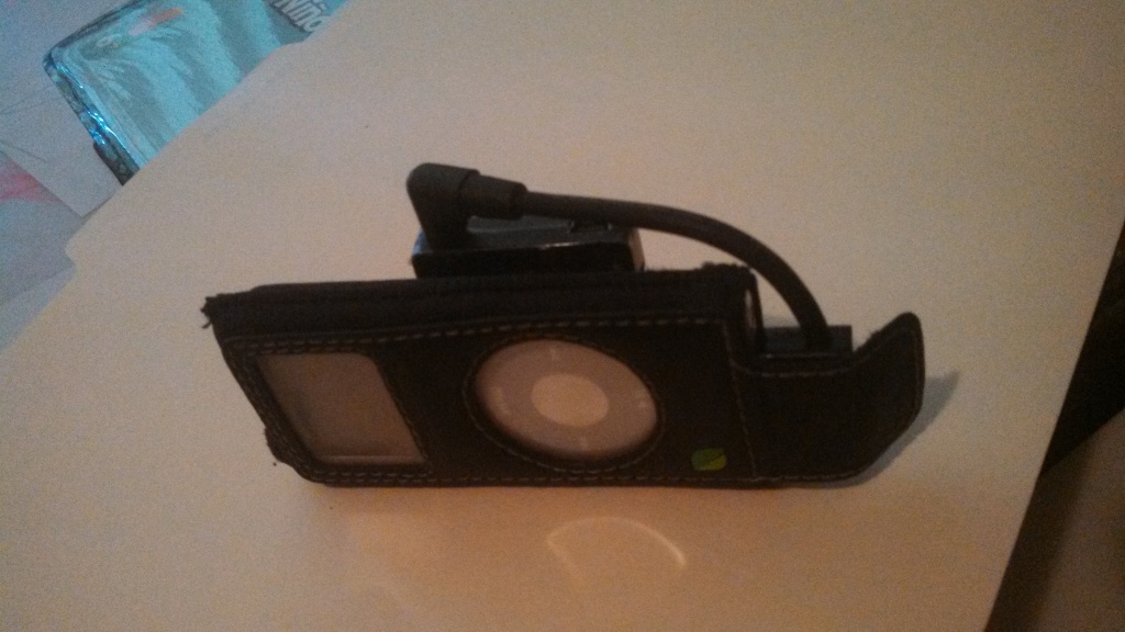

I hooked up a Fiio E6 with Fiio L9 LOD cord to my old ipod nao and my "mini-boominator" (another great Saturnus design..Thanks!) is uncomfortably loud with no distortion.
You can get the E6 and L9 cord together for about $30 on Amazon, I order mine from Emusic Enterprise and then were great.
You can then have this nice little pre-amp to bring around with you if you can't bring the boominator.
Fiio E6 and L9 with "Mini-Boominator
Here is my Fiio E6 with L9 that I was talking about above hooked up to my old school Ipod Nano. And there is also a pictue of my 7 year old and 4 year old with my "Mini-Boominator"....they call it "Big Red"
Do you mean these lads marked with the arrows??
Or the two blue ones at either side at the top of the pic?
Neither.
Good man...thanks!
Oooo they're small! That'll test my soldering skills!!
Any idea where I'd get those in 82K??
