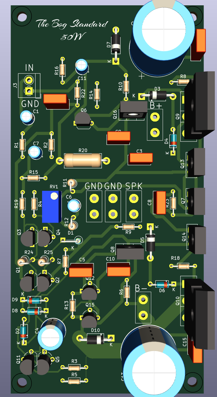

We're getting close. Hopefully I can finish up the PCB this weekend so we can get a first impression of what the first prototype sounds like.

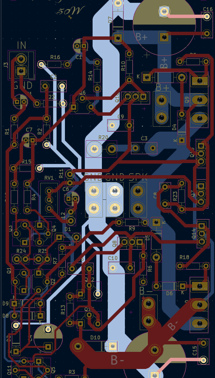

Time for some ground routing. Yes, the board is a bit crammed. I'd like to be able to fit it in a compact chassis. Anyway, back to the grounding. It's a best effort star ground. Understanding that power ground is a high power signal carrier, I've tried to avoid having any low-power tracks in parallel. The only thing I don't like are the long traces to the filter caps, but I can't think of a better way. The whole idea of local filter caps on the amplifier board is to have a nearby energy reserve, so I want them as close to the output devices as possible. Any comments? Just because it's Bog Standard doesn't mean we shouldn't pay attention to the PCB design.
Also give some thought as to how two channels would be connected together. You don’t want ground return currents in the reservoir caps going through any place where a minuscule voltage drop can show up as an INPUT signal. On a single board with a single channel that may not be too hard, but when putting a second board in unexpected things can happen.
So you're suggesting I lose the local caps? I have built two amplifiers with caps like that and they work beautifully. But you seem to know what you're talking about and it would definitely make the design simpler without that ground bar in the middle.
The local capacitors are only for RF decoupling. They form a capacitive current divider with the main filter capacitors. You don't want 120Hz ripple currents in the local capacitors.

Hmmm... I'm pretty sure I've seen lots of amplifier boards with local reservoir capacitors. I know... It doesn't mean that it's a good idea.
