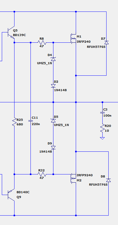

Not really. IRFP240/9240 at these modest voltages are just fine with zener clamps and it is simpler. When those come on, they also spike the VAS current, but not by as much.
Yes, but don't I need some very small reverse voltage zeners for that? I tried a 5.1V zener in series with a 1N4148 (for reverse current protection) and clamping the gate voltage at around 6V still gives me 20A of current through a 0.1ohm impedance (to simulate an "almost short"). That's a bonfire.Not really. IRFP240/9240 at these modest voltages are just fine with zener clamps and it is simpler. When those come on, they also spike the VAS current, but not by as much.
DC, yeah, it would be a bonfire if not otherwise long term limited. Under AC excitation it would be half that on average in each FET and a fuse can take care of fire control. It’s been known to work with these FETs as well as laterals. The whole advantage of mosfets in the first place was supposed to be the short term thermal tolerance.
Yeah, that makes sense. Next item on the agenda is whether to put the zeners before or after the gate resistors. I've seen some design where they put them before the gate resistors, which kind of surprises me. Common sense tells me that they would have to pull less current if I put them after the gate resistor. Yes, the driver is current limited (thanks to the contraption we discussed yesterday), but it still feels like a better practice to let the resistors take the brunt of the current limiting.
Here's what it looks like right now. (Minus the redundant diodes. I removed them, but my computer crashed before I saved it)
The gate resistors need to be right at the gate lead in order to perform their primary function -suppression of local oscillations. If the clamps can be put in without compromising that short path then they go after the resistor. If not, then they go on the other side of it. Make them 1/4 watt resistors and they become effective fuses for a sustained short. You are supposed to be able to hear when something is amiss and take steps to correct it. In pro use you would always use a VI limiter to allow it to run in current limit for a while and not just go out altogether, overheat, or die at the first sign of trouble.
Yeah, my current board has the gate resistor 4mm from the gates and I'll try to keep it that way. I'm pretty happy with they way this looks now and I'm going to start on the PCB layout so we can take it for a spin and check what it sounds like.
