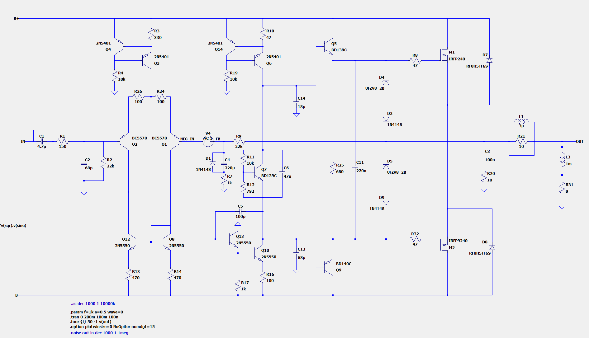

My humble project is evolving with you guys' help. Just as I was hoping! 👍

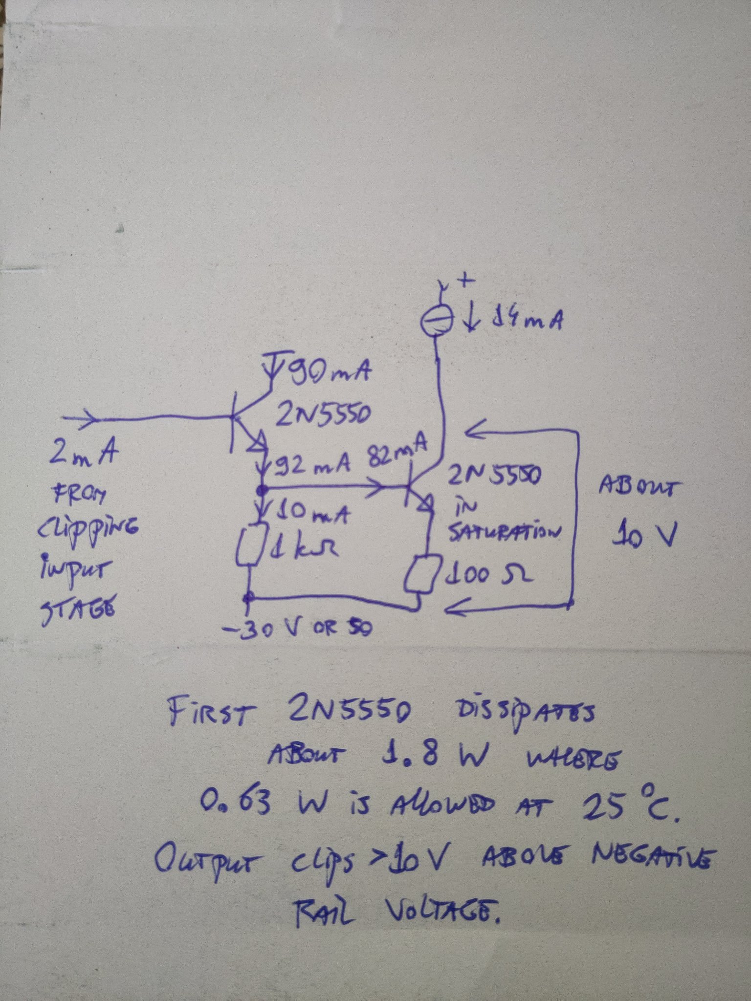

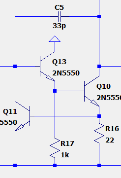

With or without Q5 and Q9, shouldn't there be a diode in parallel with C5 to ensure that the current through Q16 doesn't go excessively high during clipping and also to prevent polarity reversal when Q6 saturates? Alternatively, there could be an extra transistor monitoring the voltage drop across R10: emitter to the supply, base to R10, collector to the base of Q16, R10 half the value of R14.

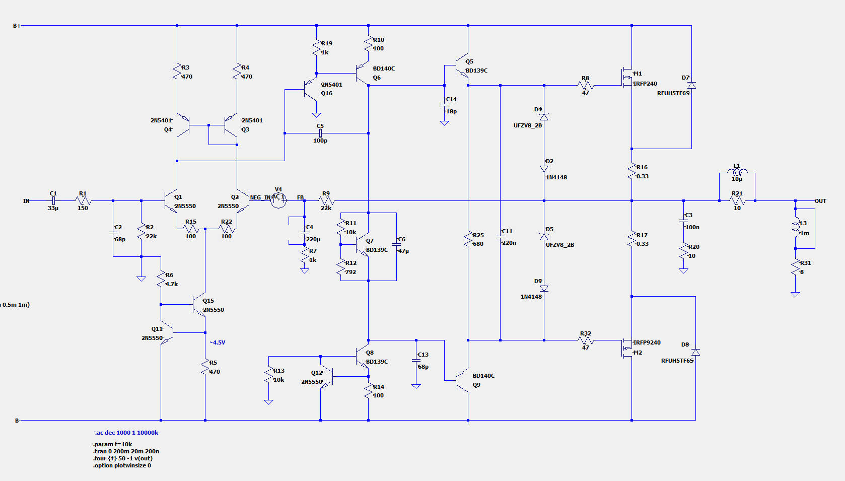

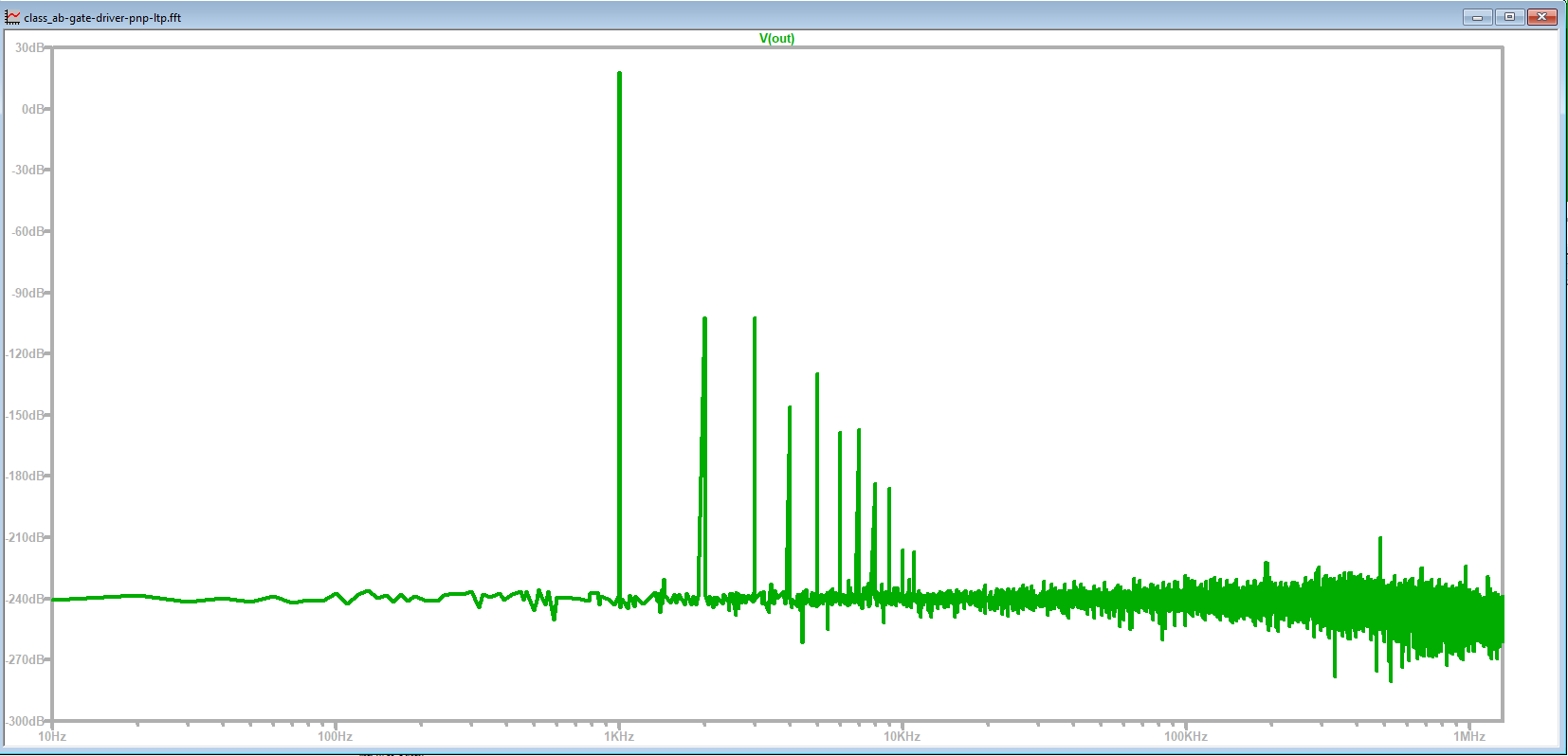

Alright folks, I made some mods:

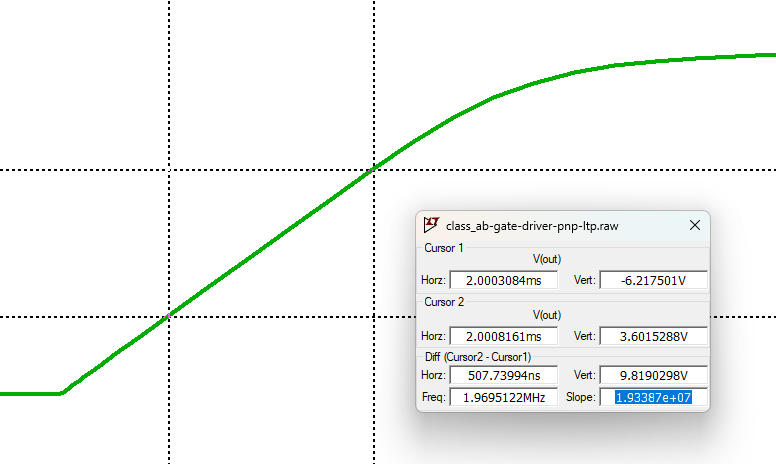

1) Added drivers. Increased the slew rate from 12V/us to 14V/us. THD still at 0.003%
2) Turned the front end upside down, i.e. swapped NPN and PNP. That increased the slew rate from 14V/us to 19V/us. THD still at 0.003%
3) Doubled the current through the VAS to 14mA. THD decreased to 0.0001% !!!
Thank you for all the feedback! The best part is that it's still made from bog standard components. Hopefully I have time to redraw the PCB this weekend so we get to find out what it sounds like! The only downside is that it's even more mundane and ordinary in its design, now that I took out the quirks.

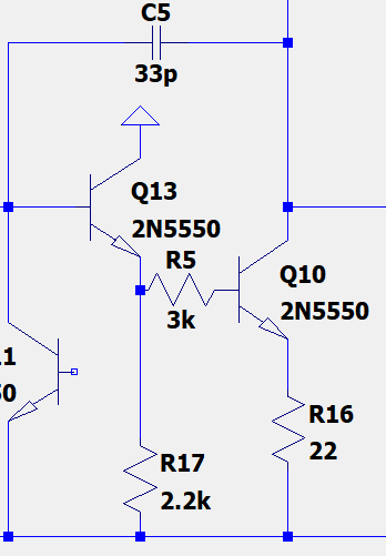

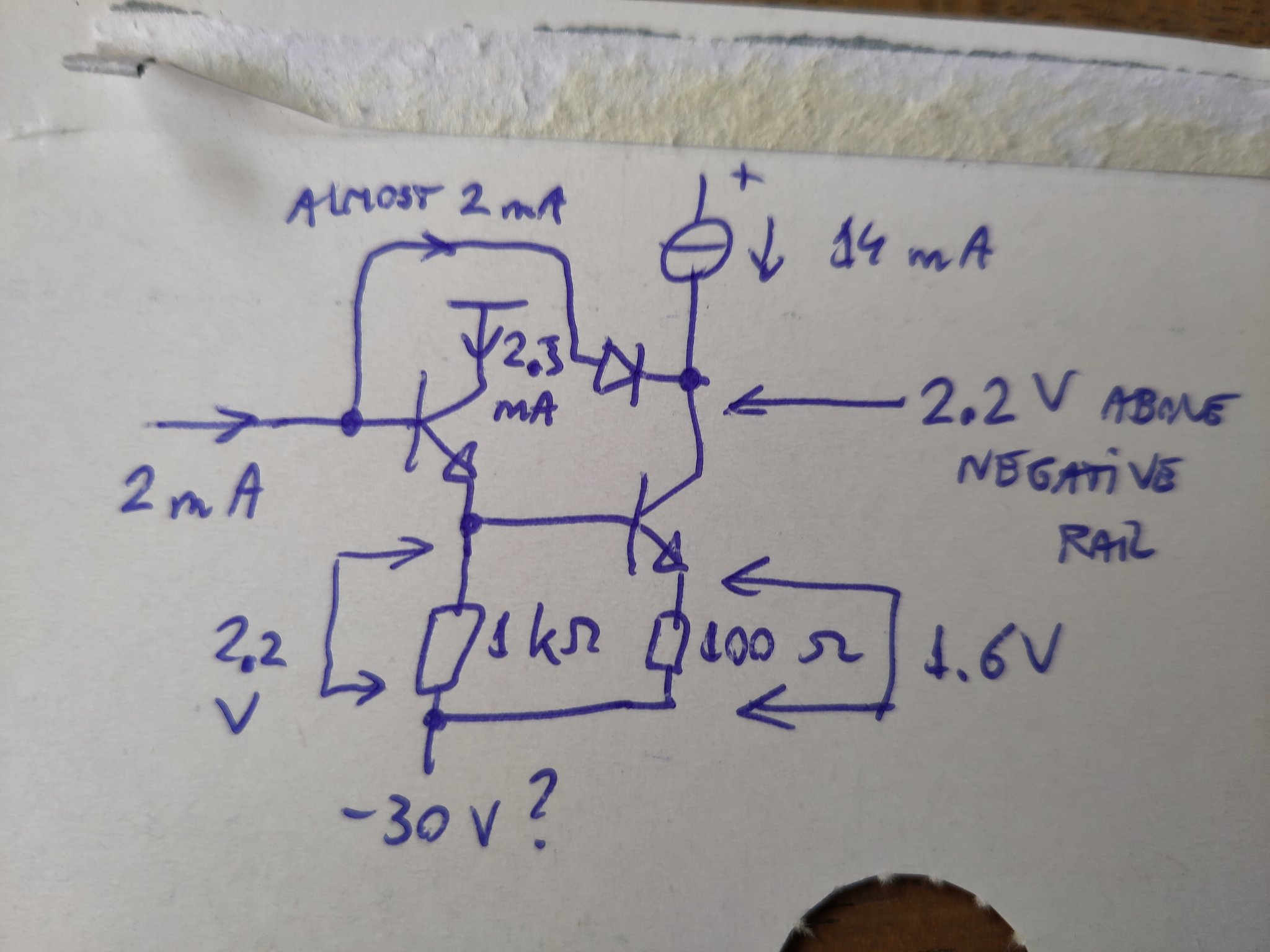

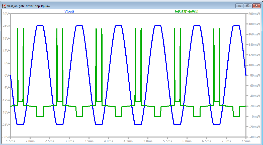

However... Wouldn't a, say, 2.2k resistor between the emitter of Q13 and the base of Q10 have the same effect? It would limit the current flowing out of the emitter at Q13 and raise the voltage at the same emitter, both contributing to a lower power dissipation. Voltage and current across Q13 are effectively out of phase, limiting the power dissipation. The only issue is that I get a brief spike of about 180mW when the voltage and current waveform cross. Your solution feels more solid, though. Might be worth that dirt cheap transistor. 🙂
