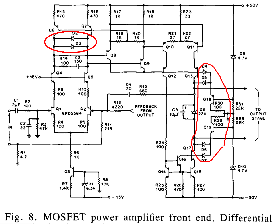

Might actually be preferable to have "only" ~25 dB overload margin PLUS antisaturation clamp circuits sprinkled throughout the preamp upstream stages, like the Cordell JAES paper. Now the worst an overload can do, is send the preamp into clean clipping and clean recovery, without rail sticking or other artefacts.
