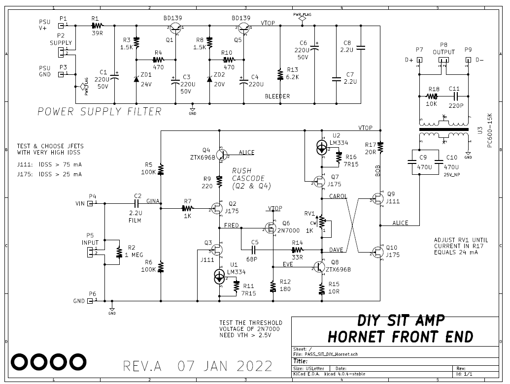

Here's my most recent project. Schematic date + PCB layout time + PCB fab time + assembly time + test time means it was completed last month.
Q9-Q10 are a complementary JFET output with no degeneration resistors; works fine with no detectable thermal instability. Had fun with all the cascodes too.

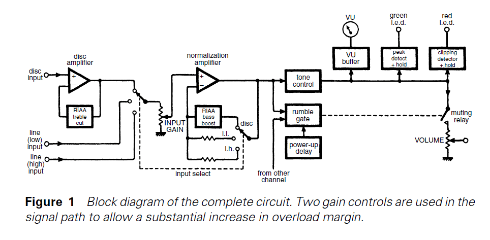

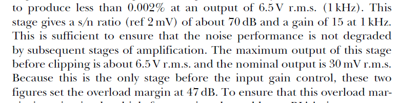

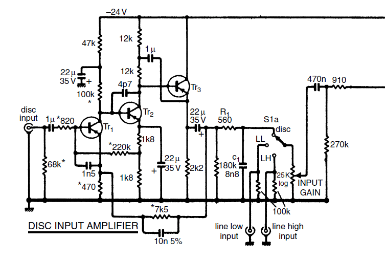

Something about those amplitude scales bothers me. Sure that's not 47 (~33.4 dB)? Assuming 30 dB of 1k preamp gain and 47 dB overload, that's +77 dB re: 5 mVrms = 35.4 Vrms, but you won't get 35Vpp from a single 24V rail, much less 35Vrms. But 30 dB gain plus gain of 47 is 63.4 dB gain re: 5 mV, and that's 8.745 Vrms. THAT is right at 24 Vpp, and in the ballpark of what can be achieved with a single 24V rail.D. Self's "Advanced Preamplifier" (Nov. 1976) had an overload margin of 47 dB; naturally, given the date, the preamp was designed for MM cartridges. Discrete BJT circuitry.
