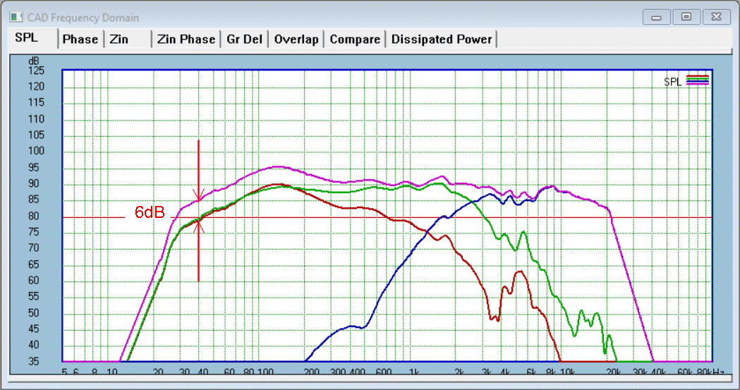

It's not a puzzle, back i around 2003-4 I realised this has serious real world implications (and also reveals what driver designers do, but that is another story).
So, I decided to show an actual sample below, which is a 2-1/2-Way speaker system. The top three drivers, the tweeter in the centre, forms a point source (get the crossover right, of course). But these two drivers here are in series. The bottom drivers, those two are also in series. Each 'leg' is thus 16 Ohm and when they are in parallel below a few hundred Hertz, they are series-parallel and hence a nominal 8 Ohm load on the amplifier.
[Edit: We can see the bottom drivers are used to fill in the diffraction loss of the box and the gain at LF is real and relied upon here.]
These drivers are rated at 88dB/W/1M and yet, look what is happening? Yes, that 6dB is quite for real. If the crossovers component, low passes, were removed, that 6dB could continue right up to several KHz
I am dying to tell you the answer, but in truth, I would much prefer somebody to post it, and you are oh-so-close!
Chris, please look at the two questions above. Remember that a single driver needed to produce an 8mm peak-to-peak excursion, so taking into account cutting back 6dB to our target and then dividing by four drivers is how many mm?
That number is significant, because of added headroom, but mostly because excursion-related distortion mechanisms like FFM and non-linear surround radiations will be reduced massively. Near-still cones are good all around.

Think about this way: If 1000mW gets you 8mm of peak excursion, how much excursion would you get with 62.5mW. Maybe that might help.
There are two ways of solving it, and 1000mW versus 62.5mW is one of them. When you know the answer, then slap your forehead and see how ridiculously easy it is to overthink/overlook something obvious. Please note again, it had me going to for a while... the human mind is a funny thing.
[Edit: There are three ways.]

"Think about this way: If 1000mW gets you 8mm of peak excursion, how much excursion would you get with 62.5mW. Maybe that might help."
An acoustic power ratio of 16 is an excursion ratio of 4. Keep getting the same answer. If we're really lucky, Joe D'Appolito won't see this and answer it with a brilliantly simple two sentence explanation.
