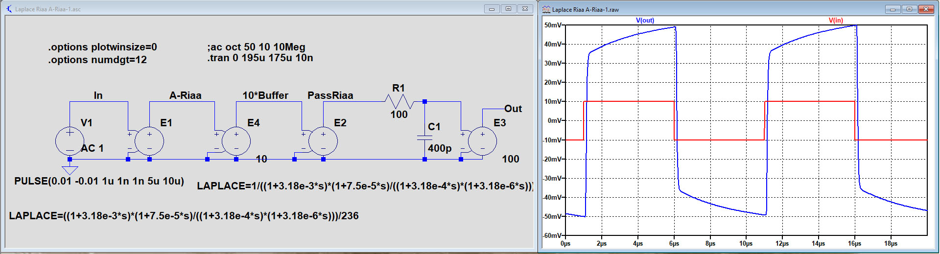

If only you had said from the beginning that your Riaa amp was a Riaa amp + 3.18usec Neumann zero, it would have saved quite some time.
That was the reason in the first place why I asked for the anti Riaa network that you didn't want to give.
And displaying a picture without axes didn't make things that much easier.
To get at nice square wave like you showed with a Neumann zero out of your 4Mhz preamp, you will need an anti Riaa circuit with a 2.55usec pole, not quite that simple to tune. With a 3.18usec pole you will get the image below.
And indeed, now for a Riaa preamp + Neumann zero with 40dB gain@1Khz, you only need an input signal of +/-10mV at the anti Riaa stage to get a +/50mV output from the Riaa preamp.
Without this Neumann Zero I would have been impressed, but now it is a mystery to me why you showed this square wave output outside the Riaa range as a prove of your skills.
