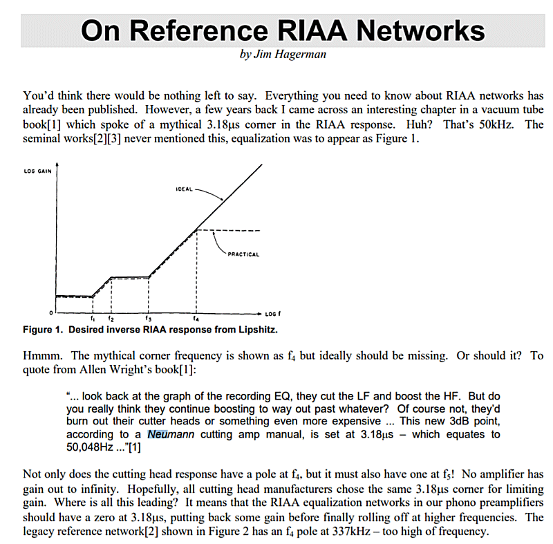

You do know there is no 'Neumann Pole'? It's all a fabrication. Like most of your posts...
I think that you just fabricated a fabrication. 😀😀😀
Bill, are you taking your meds? 😉
I know that I am. 😉
The Neumann pole, also called F4, is a practical realisation of the limitations of the cutter. Take a look below - I didn't write any of it, so if it is a fabrication... not, it wasn't me and I am happy to give the credit to whom it belongs.
I quote above"
"The new 3dB point, according to a Neumann cutting amp manual, is set at 3.18uS - which equates to 50.048Hz..."
Note that is a Lipshitz graph shown and look where is says 'practical' - so he knew about it as well.
I never fabricated it - you fabricated a fabrication. 😀😀😀
