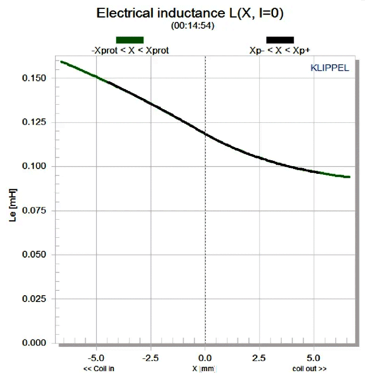

Yes Jan, I think you have missed something. In fact, we are talking about something entirely different. Please consider this:
We all know that the impedance changes with frequency, that is how measuring the impedance comes about. Constant voltage, you measure the AC current as it varies with frequency and that current is in effect the impedance. So an impedance graph shows how current is impeded and not voltage. Everybody knows this. The impedance above a few hundred Hertz becomes gradually increased by the inductance. The inductance impedes current. Current decreases with frequency.
But that is not what this was about, there is some else that changes the impedance, excursions of the driver. Let me please explain:
This is impedance changing with excursion.
Red is when there is no excursion. Cone resting in the centre position, same goes for the coil.
Blue is when the cone position/excursion is negative, say 3-4 mm inward. The inductance has increased. The same goes for the impedance and the current is now less.
Green is when the position/excursion is positive, say 3-4mm forward. The inductance has decreased. The current has now gone up.
The driver now has three different impedance graphs. Indeed it has many depending on where the cone position.
This is like imagining measuring the impedance vs frequency with a DC offset and then getting a different impedance curve.
Now when you have a low-frequency content causing excursions, modulating the impedance of the driver whilst also producing higher frequencies with little or no excursions.
That is "impedance modulations" that Lars Risbo of Purify talks about. I think the phrase is here to stay. And it is distortion! And they measure it and it especially shows up in IMD distortion tests. Try 30-50 Hertz and 300Hz and aim for excursions 6-8mm p/p and that it is within Xmax rating of the driver (max linear excursion). You will clearly see the IMD distortion products.
But what is more, we must find ways to stop the driver from doing this. It means keeping the impedance constant by keeping the inductance constant at any one frequency and not changing with excursion.
And that is exactly how Purifi does it, this is their 'fix' for a problem they identified and they did something about it and the distortion reduction is very significant:
Amazing accomplishment!
When we do this we will have the major problem solved without having to use current-drive. Simple as that.
We don't need current-drive to 'fix' this problem (even if it has the advantage of suppressing this distortion because fixed current cannot be modulated).
Regards, Joe
