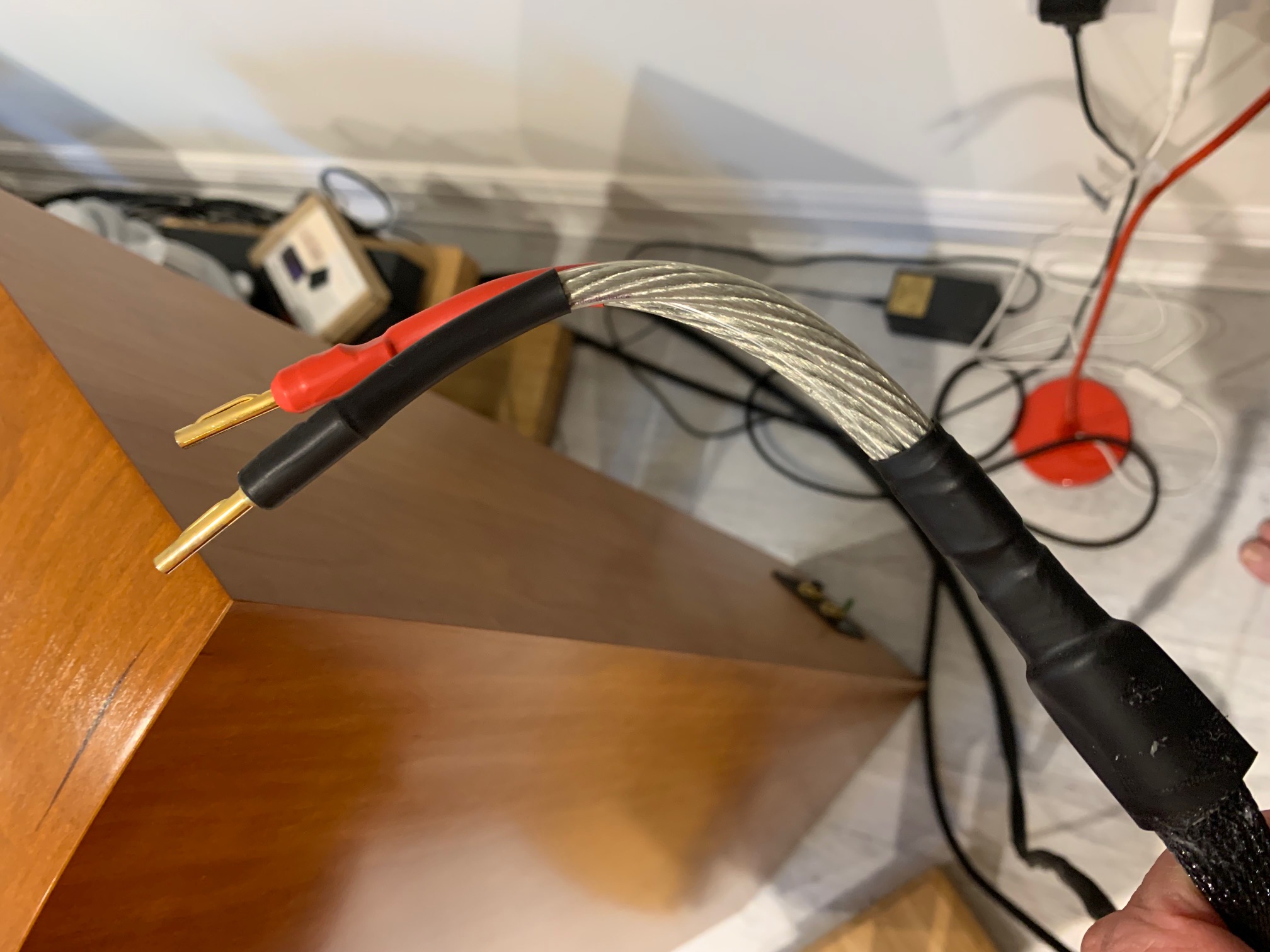

Had the guys at one show trying to tell me my system sounded flat because I hadn’t used £1000 speaker cables. I made my own using 5 mm multi strand copper. With the plastic insulation each cable is about 10 mm in diameter and then both to get pulled through a woven nylon/poly sheath. Gold plated spades both ends, all trimmed and finished off beautifully with heat shrink and clear RTV to make sure nothing comes undone.
The cables will happily do 40 or 50 amps and cost me about £80 in materials to make.
Inductance and capacitance? Who gives a ****. My amps are stable with any.
You should have said that they were priceless prototypes and would sell for £10,000 if you marketed them as they had had a total electron replacement from a block of gold.
Bonsai you might as well terminate them at the far (speaker) end, anyway. The cost is tiny, the benefit exceeds the cost, and the basic idea doesn't contradict conventional science.

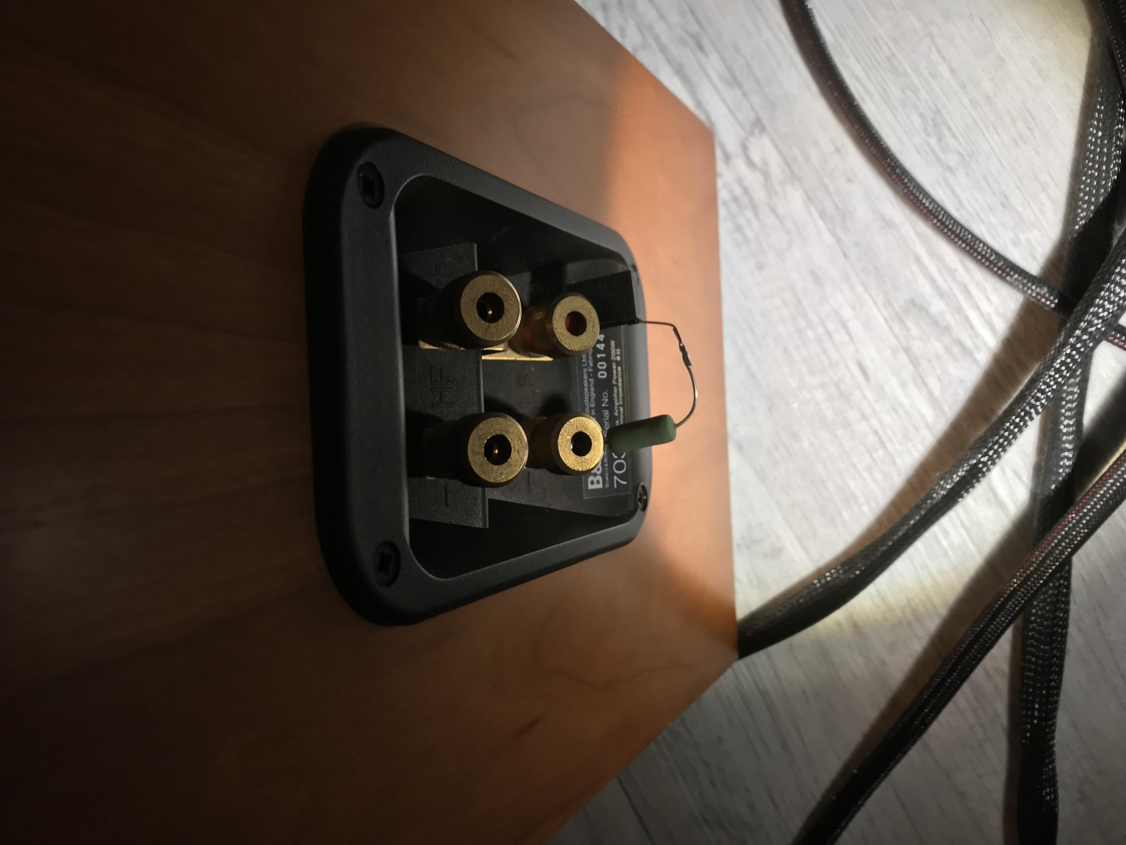

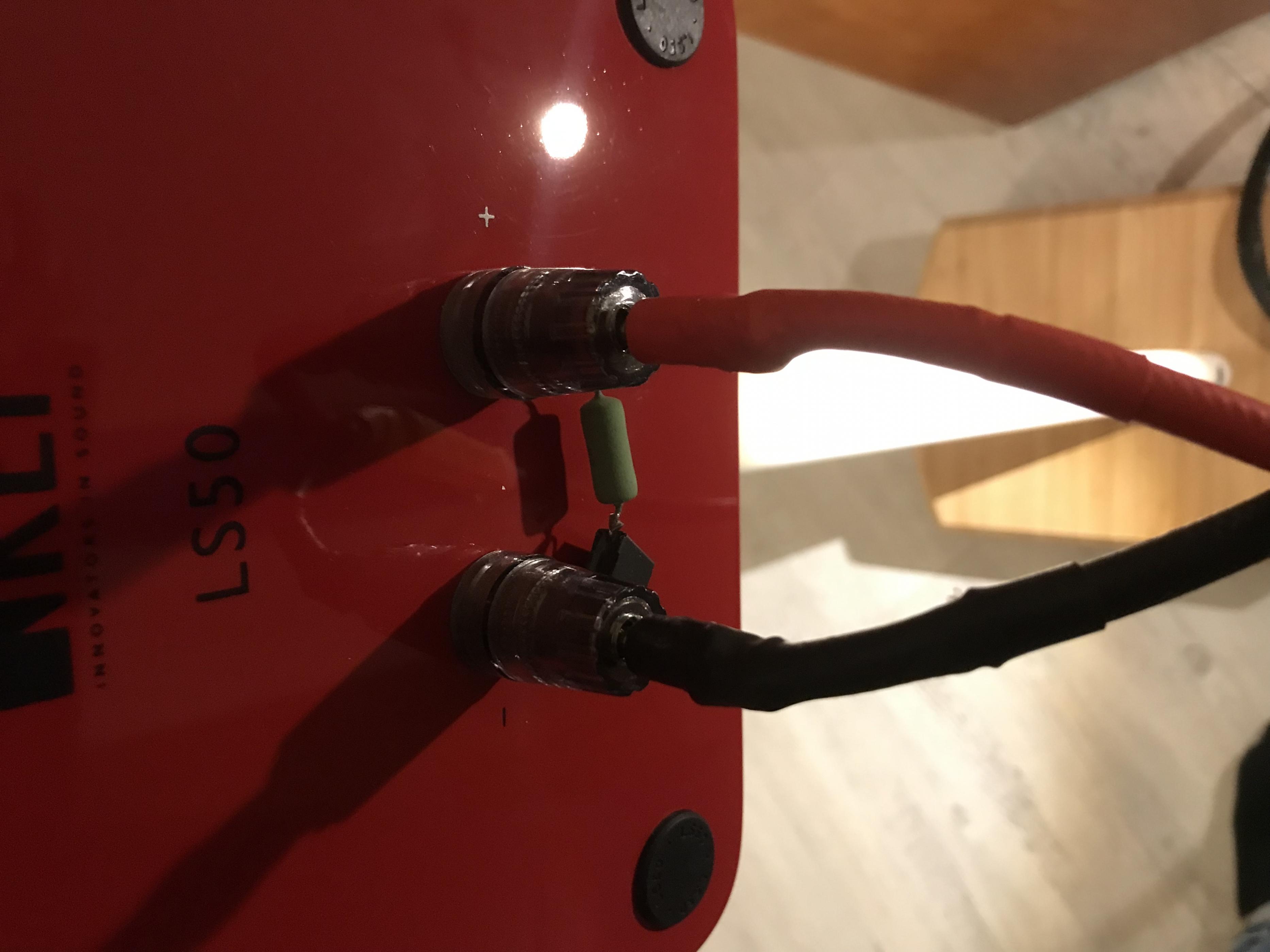

Funny you should say that. They’re already terminated but not optimized. I used 8.2 Ohms and 0.1 uF.
Thanks for the article - I’ll need to digest that.

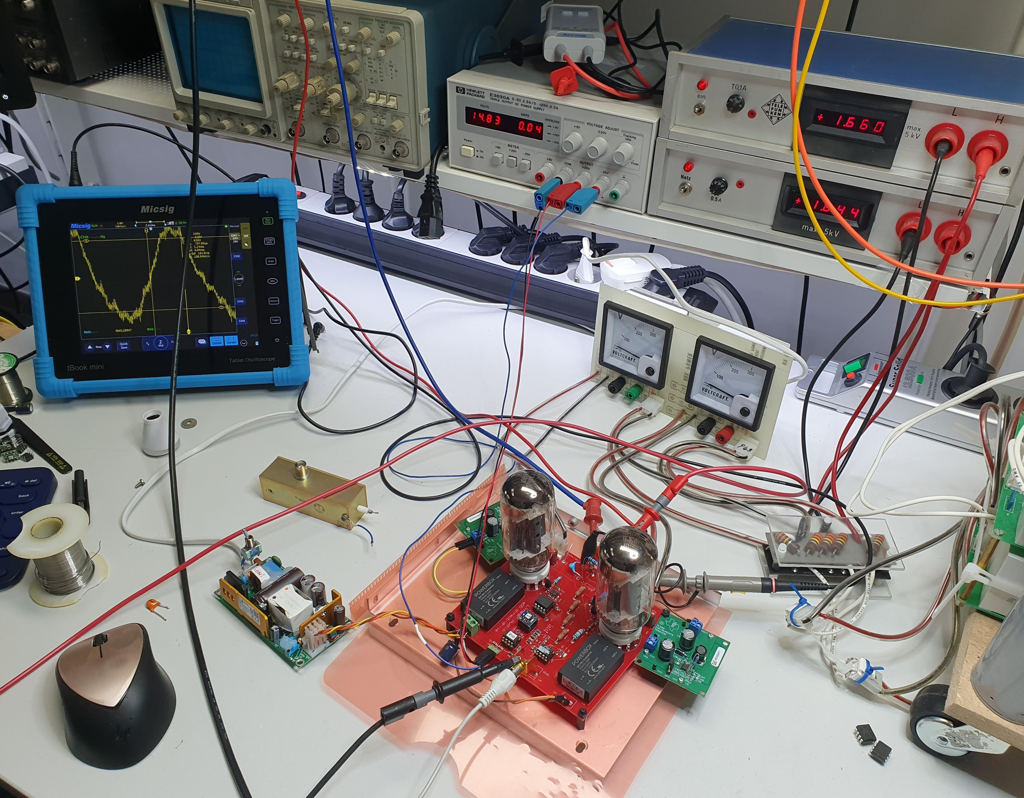

(I was planning to feed a 1-2 kHz square wave at say half a volt and then look at the response at the speaker end and trim the damper network as required. )

I actually had the prototype play (one side of the speaker only) Cassandra Wilson last week! Sounded not bad, even with half a speaker (only one diaphragm driven)! But today when trying to order additional medical grade 5kV isolated DC-DC converters from Powerbox, price had gone up 20% and delivery times quotes as 'we'll do our best for you Mr. Didden!'. Not promising.
Jan
Crikey, I think I have seen something resembling an Amplifier stabilising output Zobel before:
Here 10R (not Bonsai's 8.2R) plus 0.1uF in a Rotel RA-931. But an inexact science given huge variations in loudspeakers. 🙂
