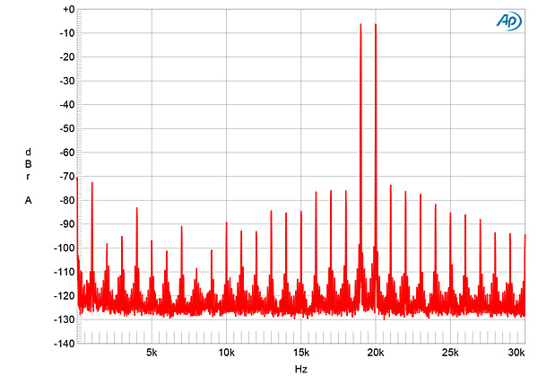

For a laugh Dan D'Agostino Master Audio Systems Progression M550 monoblock power amplifier Measurements | Stereophile.com. Not particularly impressive for $45000 a pair. I won't comment on how the reviewer didn't seem to notice significant cross-over distortion either...
What I found embarrassing was the way SF defended the publication of a measurement of a broken amp with a call to 'transparency'.
Last time I looked, SF did not exist for the purpose of showing the transparency of its staff. SF exists to inform its readership.
If the staff f*cks up a measurement, the right thing to do is NOT to publish it and brag about transparency.
The right thing would be to NOT publish or retract the broken test, and redo it with a properly operating amplifier. That is service (remember that word?) to the readership.

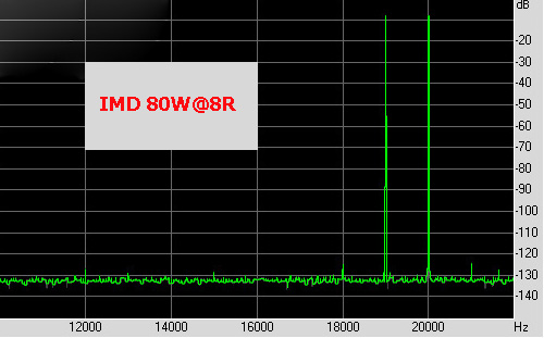

Well, not very impressive indeed when comparing those IMD figures to those measured with my 90% DIY Amp at a peak level of 80Watt@8R.
Noise is also not very impressive with 80.5dB from 22 to 22Kz ref 1W@8R
versus mine with -96dB up to 30Khz also ref 1W@8R.
For such an extremely expensive amp made by professionals, it seems disappointing to say the least.
Hans

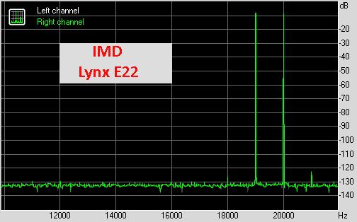

Hans what would your amp show at 1kHz with the 19+20?
Jan
Jan,
I searched, but to my regret I couldn't find the original files anymore to show the 1Khz IMD distortion that you asked for,.
But what I can show you is the IMD of the used Lynx E22 Sound card in a loopback, already having practically the same peaks at 18Khz & 21Khz.
So in fact the measuring gear is here the limiting factor and the amp itself is probably even better as shown at this very IMD setting.
Hans
