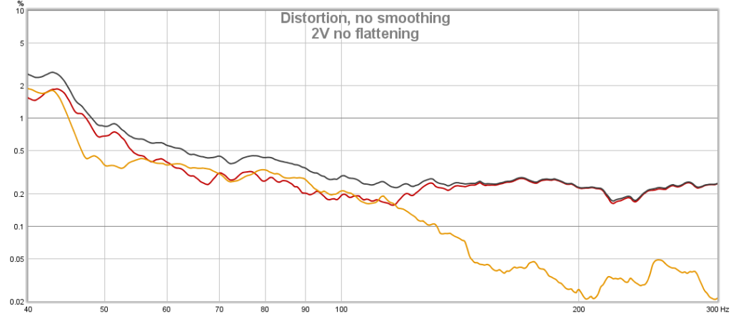

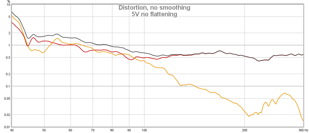

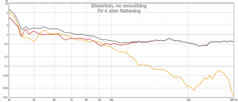

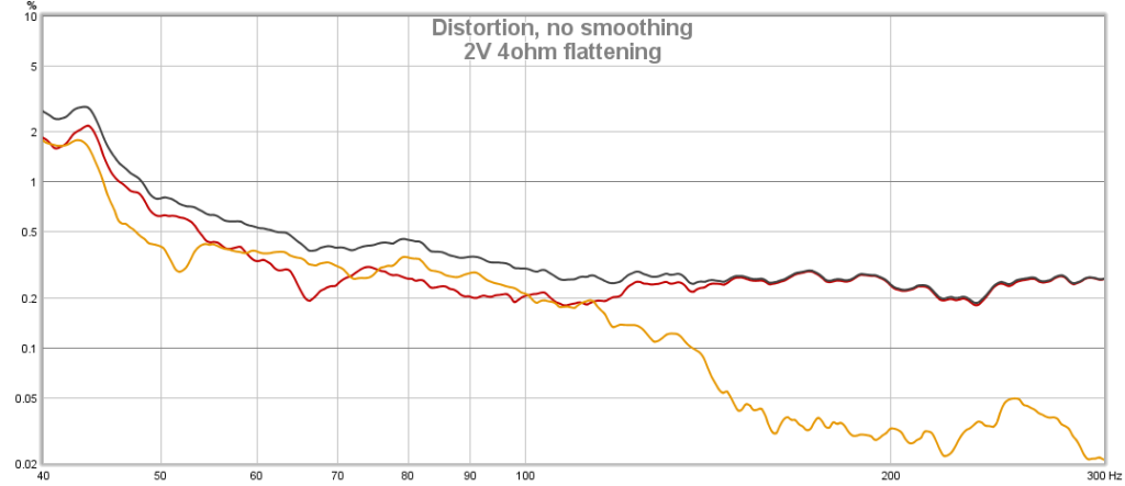

Since the statement was a parallel resistor reduces the distorted current I don't see a need to wait that long.
I agree. As a small memory refresh, below are the results of distortion measurements at acoustical side with and without the "impedance flattening" resistor. In other words, NOTHING.
Agreed. When you have a perfect impedance compensation, the transfer function is the same not matter what drive impedance, both with regard to speaker terminal voltage and thus acoustic output as well as amp input signal because the current drive amp has flat gain vs. frequency by this.I wasn't sure whether Joe is using current drive or not (he seemed to be saying it's no longer necessary with his developments), but now I remember one of the touted advantages of the zobels is that you get the same response in voltage or current drive. And yes I am aware that the zobels provide a current path for re-entrant distortion.
The difference is in the distortion behavior like you said but also in the damping. The voltage amp provides the "standard" Rg=0 damping, where as with current drive the damping is the impedance of the compensation, thus frequency dependent. And in some cases you certainly also can hit the sweetspot so the compensation approach is viable and quite easily to realize wrt to complexity.
Somewhat related to that, I actually agree with Joe that placing a series element (like inductor for woofers and capacitor/resistor for tweeters) as the last part in front of the driver is a good thing, for the simple reason it increases impedance the driver sees and thus can benefit from the reduced distortion with higher source impedance. For the same reason, don't pad down a tweeter with a resistor divider.
