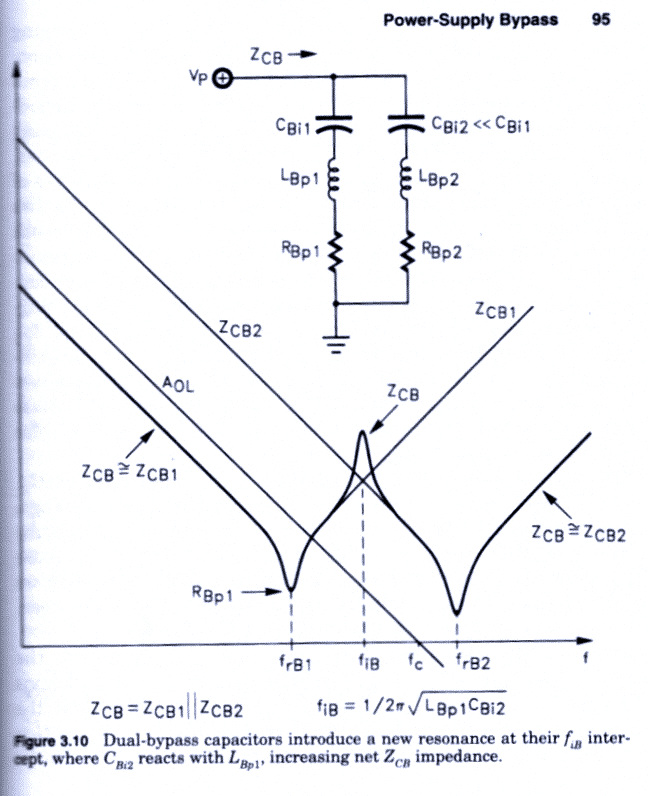

I don’t fully understand the argumentation here. A large electrolytic has a SR of about let’s say 1-2 MHz for whatever reason (lead L, some internal L etc). Is Catt arguing against placing smaller capacitors in parallel to create a second self resonance frequency higher up, so that when the two are combined, you have a flatter, overall lower impedance across the two?
The problem arises from parasitic L from whatever cause. So you can cheerfully end up with a resonant *peak* between the two dips.

Have a look at the book Optimizing Op Amp Performance by Jerald Graeme of Burr-Brown. He devotes an entire chapter to supply bypass networks and unwanted resonances. Here's one of the figures in that chapter.

Ok - got it. I’ve seen systems with a bulk electrolytic and then 1, 0.1 and 10 nF to try to address this issue.
I use 10, 1 and 0.1 X7R in concert with electrolytics - usually 1206 or 0805

J. Graeme advocates damping resistors. I used them on the DIY project "Cedarburg" to tame the moderately-notorious AD797 oscillator opamp, and they got the job done nicely. Cedarburg is an uncommon word with more than 5 letters, so the Forum Search function is able to find it quite easily.

The bypass/decoupling techniques in audio seem to be generally lagging by a few decades. It's easy enough to design a low inductance PDN and avoid anti-resonances if you don't sprinkle 0.1uF caps with traces to a via. In most cases, there is no need for multiple types of caps given the availability of high value caps in low mounted inductance packages.

A 1-100uF lytic has the right low inductance resistance range for damping a large lytic and a 100nF capacitor without needing any extra series resistance, you get lower overall supply impedance that way. However you need to know the ESR of your lytic and the approximate loop inductance.
Luckily I haven’t had any problems with AD797 - I used 22 ohm resistors in each rail and then 100 uF electrolytics and 1 uF X7R right at the opamp pins.
