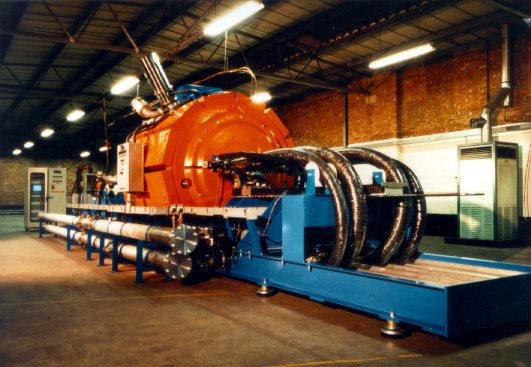

We built massive 4 Tesla, 0.5 metre bore magnets for mineral separation (this became a standard product). This thing had a 10 ton iron shield to manage the stray field of this huge industrial magnet. Image attached, on our shop floor prior to shipment.
The first shipment of this went up a tributary of the Amazon to a kaolin clay processing site. That went out on an Antonov, then a seriously big air ride truck, then on a barge.
The water to back-flush the clay impurities out came from the Amazon. We'd put massive filters in place to prevent plants, sludge etc getting in. The mine operators got pissed off that the filters kept getting plugged up - so they just took them out. So next the machine itself got plugged up with frogs "the size of small dogs".

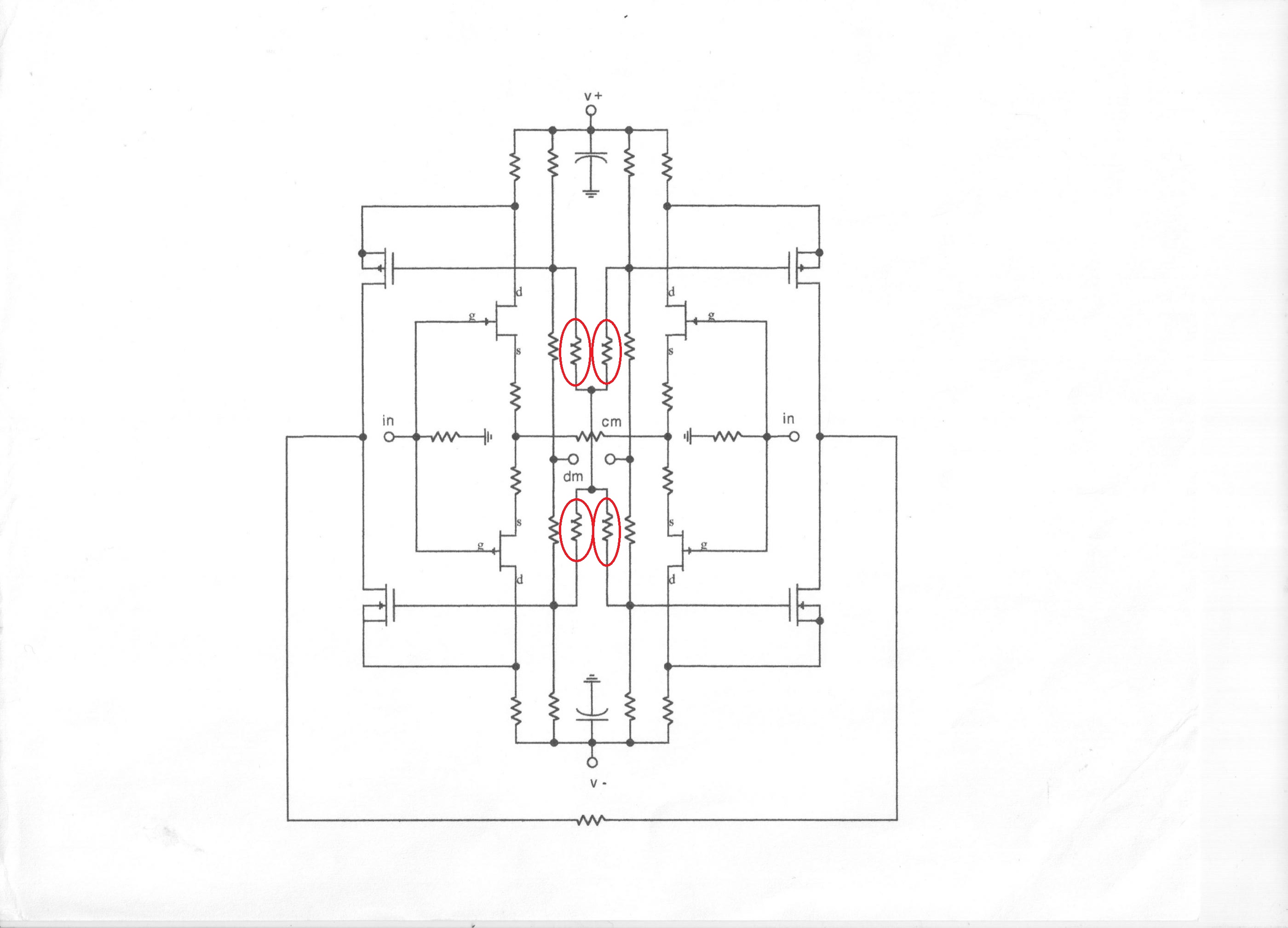

Are you shure this is the complete circuit diagram ?
The text tells that the junction of the four questiined resistors is the CM output versus the DM mode output directly below.
But I don’t see how this could ever be an output.
Just DC voltage dividers between V+ and V- with only four high impedance gates connected.
But when this is not meant as output, I agree that the function of these 4 resistors is superfluous.
And why aren’t the outer mosfets not marked as outputs ?
Hans

Indeed, the schematic is not complete because it lacks the Common Mode and Differential Mode servos.
I think the CM and DM servo connections are made in the same place.
I think the connection point of the 4 resistors is not the CM connection.
Regards
Darry

It should be the common mode point where the common mode servo connects to correct the common mode offset. It is not the complete schematic.
