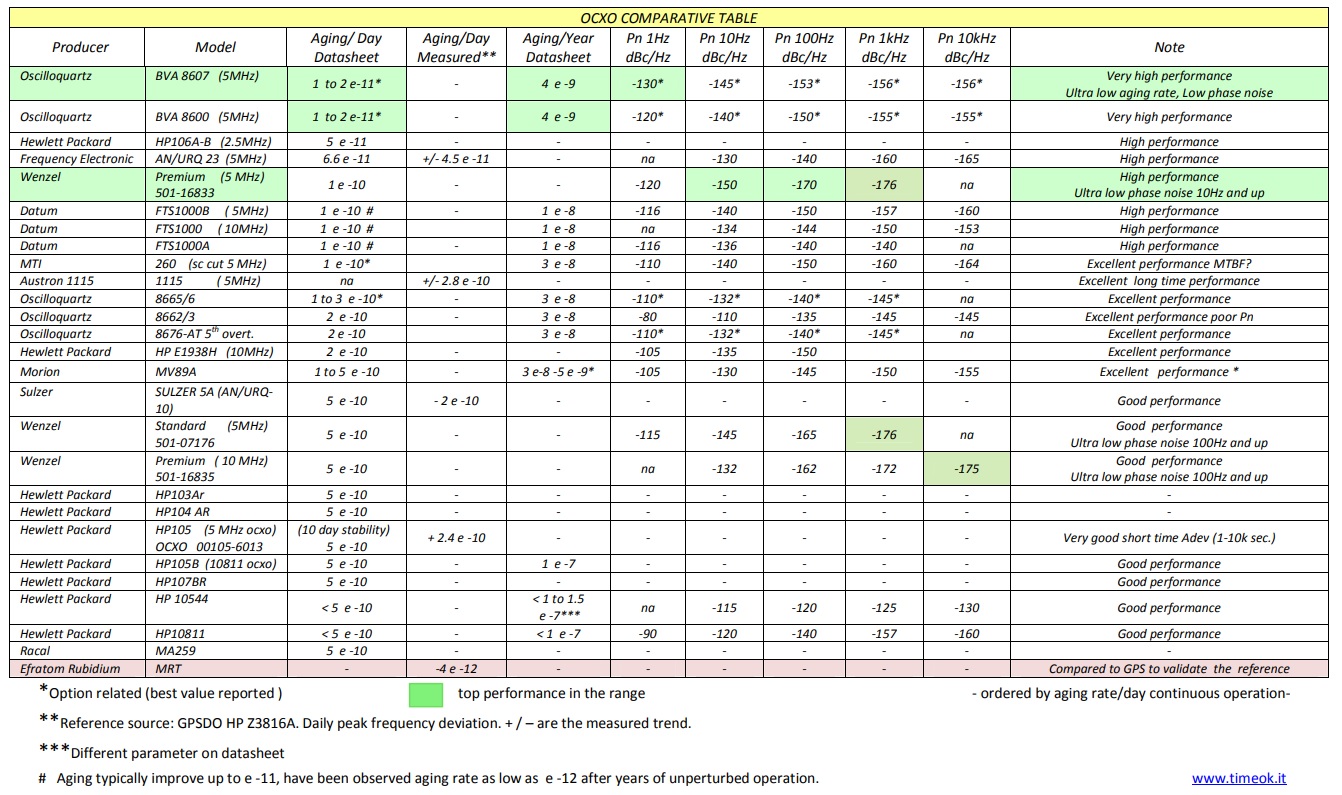

No, quite a list of products up for sale, coming from two hobbysts.
BTW, comparing your bric-à-brac oscillator with the Wenzels is shameless and clearly shows you have no clue about oscillators. Wenzel products are now on the surface of Mars running in the Curiosity rover. Beyond reliability for Space applications, you don't want to know the precision and yes, noise performance required for these products. I am quite sure the martians listened to the Wenzel low frequency jitter and found it satisfactory for their wideband oversized ears.
I have already explained on another thread but it looks like there is no chance you can understand. It's your problem.
And yes these are a list of diy boards shared from two hobbyists on a diy audio forum, nothing more.
No audio company, no audio professionals, no commercial interest, since we build these devices for ourselves.
And yes they are not for free, although they are a bargain.
We are not San Francesco (or Saint Francis for those who does not understand italian language).
We spent a lot of money to build these devices and achieve such results (our time is almost for free).

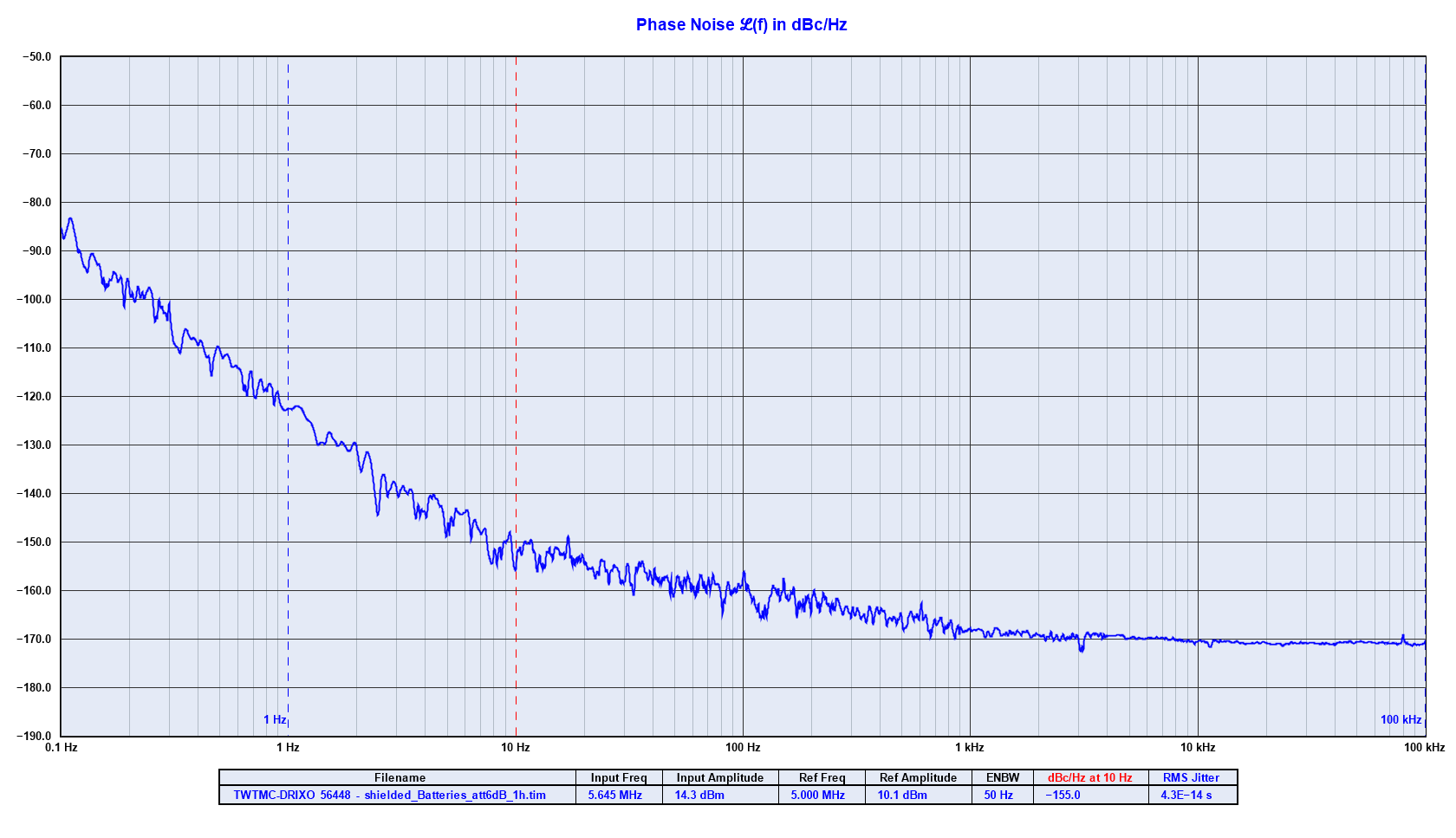

Unlike your bric-à-brac phono stage our oscillators by measurements (your obsession) are in the class of the Wenzel ones (see table).
Our XO:
Pn 1Hz dBc/Hz -123
Pn 10Hz dBc/Hz -155
Pn 100Hz dBc/Hz -157
Pn 1kHz dBc/Hz -168
Pn 10kHz dBc/Hz -171
And since you have not understood anything about oscillators, it's almost obviuos that our oscillators have poor long term stability since we have not implemented an oven.
In audio we don't need it but in case we will use your phono stage to control the oven, although one opamp is more than enough, maybe we can parallel them so the servo will measure spectacular.
Finally, you can't listen to the Wenzel low frequency jitter because you measure but not listen.
