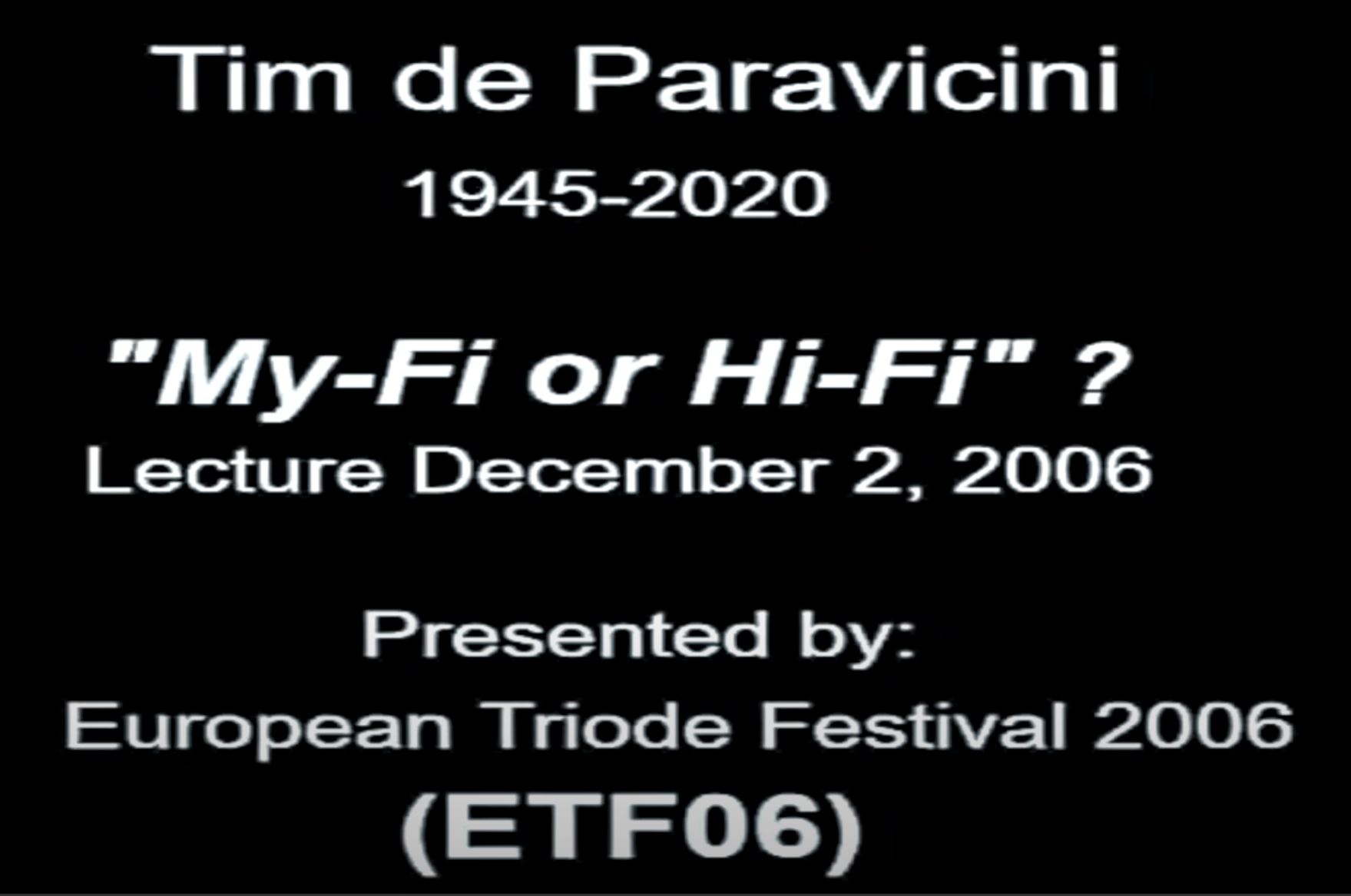

Behind the scenes, we had a discussion on ETF Facebook page (only via invitation) and some of us were at the EFT06 and on December 2nd, we saw Tim's lecture. I sat up a Sony HDV Camera and matching Bluetooth Microphone and sat right in front and recorded it. The others asked me if I could share, I joined up the files into a single 1hr 45min long. I sent it to Emile Sprenger (you will see him introducing Tim at the beginning) who reduced the file size down from 8GB and posted it on his YouTube channel.
Here is the YouTube link:
"MyFi not HiFi Lecture" By Tim de Paravicini
Tim had other interests. If you had trouble to get him talking, bring up general aviation (I believe he flew his own plane across the channel to get there) and vintage cars, especially motors. Then he would get into his stride.
It's also interesting to hear the voices, a few who are no longer with us. I particularly heard Allen Wright and we travelled together from Switzerland to attend. Maybe some of you can pick some of the voices (mine included)? That would be interesting.
Sit back and take it in...

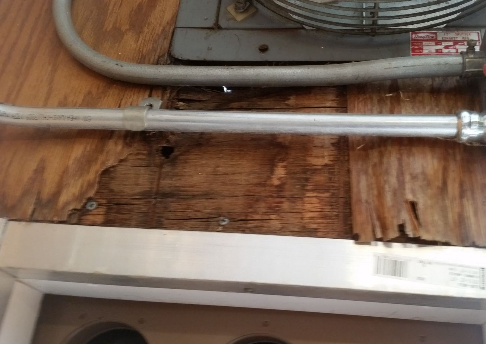

This should make you cringe! Locally WESA had a transmitter shack roof leak! Right into the (15 KW) main carrier transmitter. All nine output modules and ten power supply modules got wet. The logic card probably will be destroyed as it had backup batteries, that from my experience guarantee that any wet PCB copper will be dissolved.
The backup is now running but at much lower power. Last I knew they were trying to get in a new backup unit at 2.5 KW.
The tower is on top of about the highest bluff in the area and it is an old AT&T transcontinental relay tower. Ginormous!

Hey Ed, and YIKES!
You are right! Transmission equipment really needs to be kept in server-class clean rooms, but radio being the poor stepchild it is, this is often not the case. A college station I have just started reworking had a similar situation due to neglect:
Fortunately it was not right over the transmitter, but it did drown some fiber to Ethernet transceivers. The exhaust louvers had stuck partly open for...god knows how long, and the rest of the RF plant showed the same attention to detail and maintenance.
In stark contrast, the audio plant is state-of-the-art Wheatstone consoles and Wheatnet, a real showpiece...but that is where the parents tour so it is where the school puts its money.
Twas ever thus...
