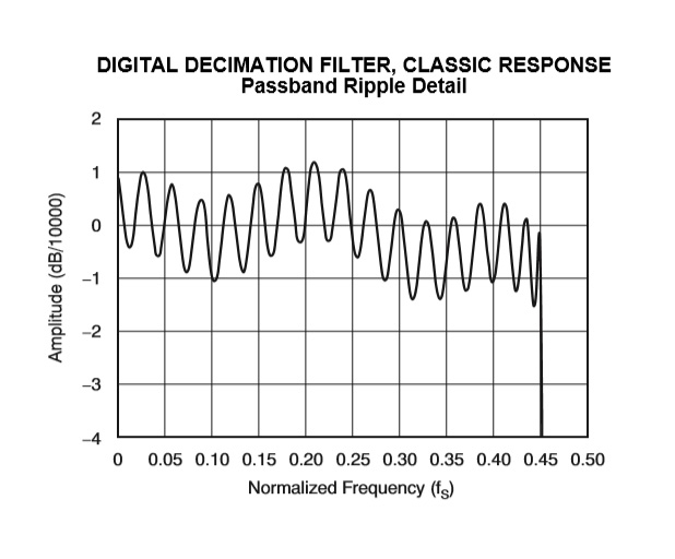

I don't think so. I rechecked the specs on the TI (nee BB) PCM4222 and the modulator runs at more or less the same frequency whatever the output bitrate or format is. The decimation and digital LPF determine the output bit rate. The stock digital filter is 100dB down at 0.55fs. Same analog front end from 44.1 to 192k output.
That's correct.
The advised anti alias filter for the PCM4222 has its -3dB point at 590Khz.
Passband ripple is excellent.
Hans
That illustrates what I've meant. I'd think that the recording people usually don't use these filters but after editing/mixing/summing use some of their own DAW filters, but some of that weren't such a good choice expecially one or two decades before.
If using 192 kHz there should be usually no problem with aliasing or imaging filters but in case of 44.1 kHz the datasheet shows one of the typical half-band filters (means 6 dB down at Nyquist) and if we take into consideration for example the NPC digital filters used for oversampling in CD-players (also typical half-band filters 6dB down at Nyquist) it becomes obvious why sometimes it might be a less than optimal solution.
Edit: On the recording side, the usual suspect like Bob Katz seem to think that it is mostly a matter of filter quality, while the bandwidth extension is not of importance. Dan Lavry still maintains that in his opinion 44.1 kHz is not sufficient and that it should be 60 kHz (or I'd guess the next Fs above, broadly used like 96 kHz for practical reasons).
Others still think differently.....

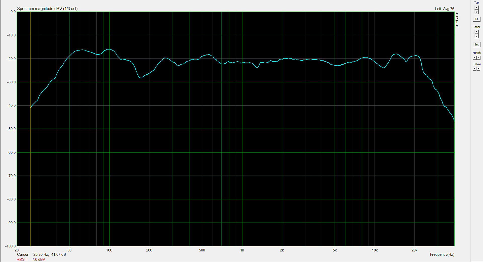

First recording made with 230 Volt on the ESL63.
Recorded on axis from 1 meter distance with pink noise, smoothed in 1/3 band octaves.
Microphone with MDF correction table flat to 40Khz.
I'll have to wait for 24hrs before the 5kV bias has been dropped and the next recording with 10% less mains supply can be made.
Hans

Excellent, thank you.First recording made with 230 Volt on the ESL63.
Hans
As the discussion included polar plot variations with DC bias, would it be possible to do a few off axis?
Thanks, jn
Edit: Hans, didn't you say your neon blinked every minute or so? That would mean your losing roughly a volt per second.
If you have a variac, you could dial the line down and just wait for the neon to wake up.
