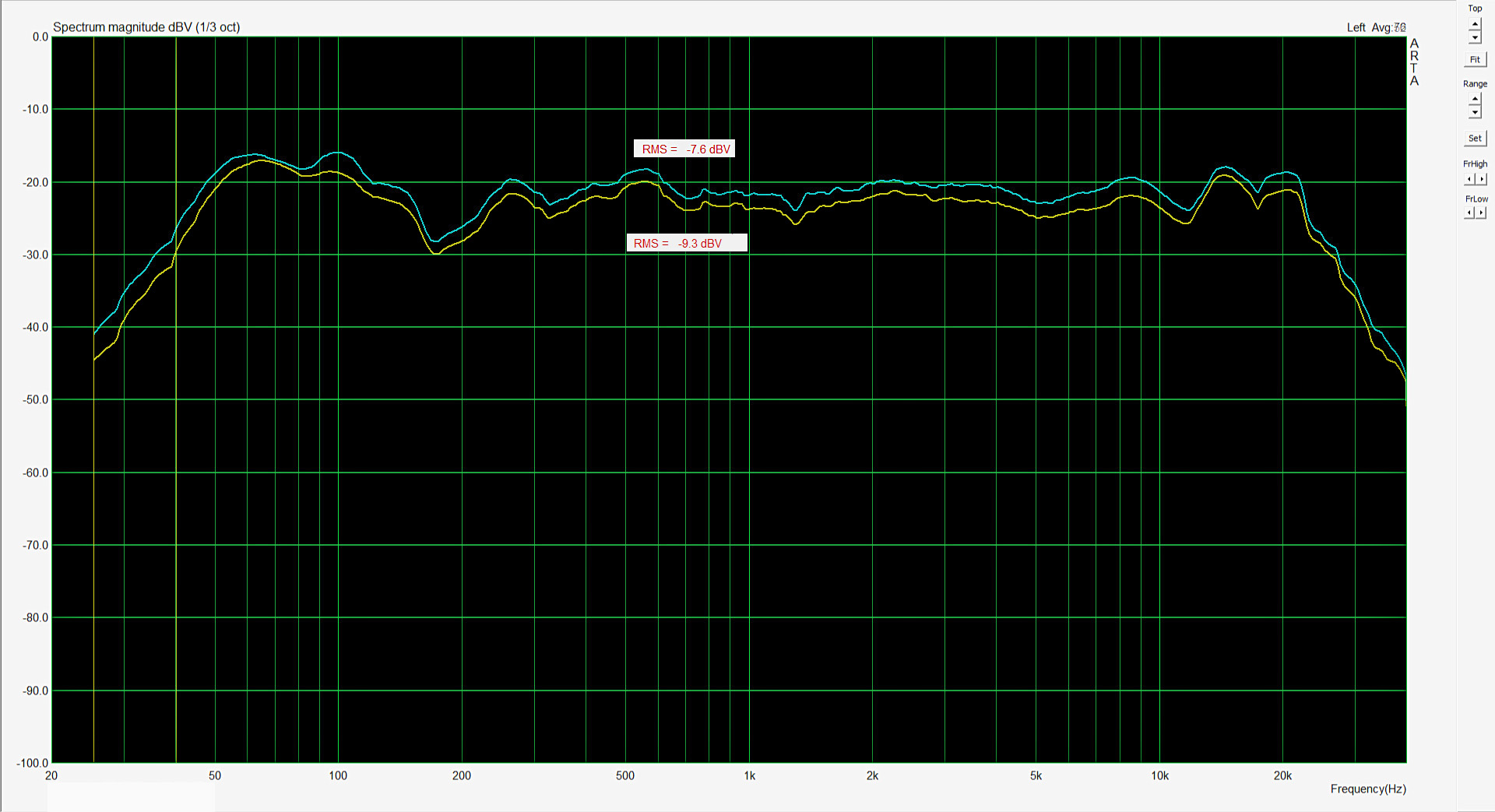

With ca 20% less mains supply, ESL63 output went down by 1.7dB.
The image below shows that the Bias voltage only influences Gain.
No sign of additional HF influence on the frequency range.
I think we can close this supposed mains supply effect as being non true.
Therefore no further action from my side.

Which is of course the expected result of that simple test.With ca 20% less mains supply, ESL63 output went down by 1.7dB.

Unfortunately, it doesn't cover what was discussed.

Polar plots were not at all discussed but only proposed by you.
A brick wall filter does not shift frequencies and varying the mains supply of an ESL63 does only affect overall Gain, just like turning down the volume that does not change the polar plot either.
Be like a man and admit those cases where you were wrong,
especially to those people who invest their time in experiments.

Recorded on axis from 1 meter distance with pink noise, smoothed in 1/3 band octaves.
For something the size of the Quads is 1m not too close to measure? Toole says, measure in the far-field and scale the measure to 1m.
dave
Please stick to the facts.
Give that the speaker type you are testing show a rise in gain during a tone burst, as documented by tests included within a published paper, due to curvature based charge lateral shifts...why would you think a white noise steady state spectra would be capable of looking for that type of effect? It certainly would not have shown what was actually measured prior.
Granted, the test you did might be the only one you have the equipment for, but setting up and concluding that a test which has no possibility of seeing what was discussed, and then showing it as proof something does not exist..either you do not understand, or even worse, you are deflecting.
Why not just put them on a scale, weight them, then say that is proof?
When a poor choice of modulation is used, and then the upper sideband is excluded by a brickwall, the resultant output is the sum of the carrier(the average of the two initial frequencies), and the lower frequency. The resultant modulated stream has a new center carrier, as your plots show.
As to turning down the volume does not change the polar plot?? Please do not make up more strawman arguments, they are just really transparent..nobody has disagreed with the gain statement you made, so not sure what you were trying to prove.
As I said, lateral charge displacement caused by the delay lines and physical ring structure on the stators may conspire to alter the ring by ring gain in the exact same way measured and reported within that paper, and that will alter the polar directivity.
And, if it is a measureable effect that Richard reported on, the design solution is a trivial one. The actual manufacturing possibility would depend on quite a few things, such as the viscosity and wettability of the fluid used for the sheet conductivity... It is not clear if silk screening of the diaphragm surface, transfer printing, 2-D cnc style printing, or even a removal process such as plasma etching (not sure of the diaphragm integrity through that process) would be applicable.

Nah. For what he decided he wanted to prove, near field was more than adequate.For something the size of the Quads is 1m not too close to measure? Toole says, measure in the far-field and scale the measure to 1m.

Edit: I guess there is a slight possibility that if the ring structure is truly producing a spherical wavefront, there could be a change in the plot as one gets further from the panel.. To check that, one would need to do a scan of response vs distance, and repeat at a second bias voltage. If there is an effect, the hf would go a bit more planar as bias drops.
