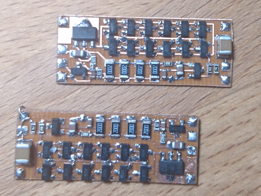

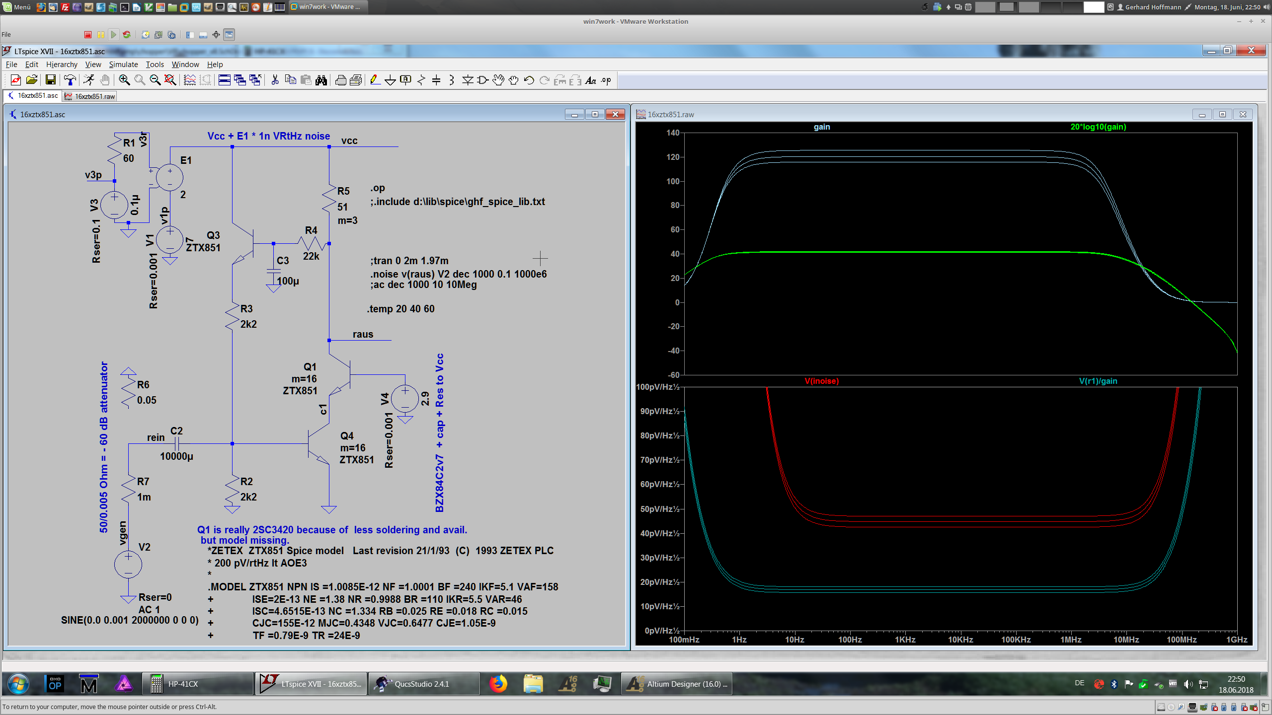

H&H 3rd Edition page 506 for a 70 PV/rt Hz ribbon mic pre With 32 Zetex 951’s in parallel. Power consumption is c. 100mA.
A single needed version is also presented but you need a 150 000uF input coupling cap - even they concede it’s ugly, but I suppose in the pursuit of low noise, crazy things are done.
I have build the non-differential version and I can say it works
as advertized.
< DSC_0485 | source of the idea | Gerhard Hoffmann | Flickr >
and the pictures to the left. LTspice is slightly optimistic with 40 pV, but the
amplifier HAS 70 pV/rt Hz.
There is also a SMD version for use in a chopper amplifier at a higher frequency
where the capacitors can be tolerated.
