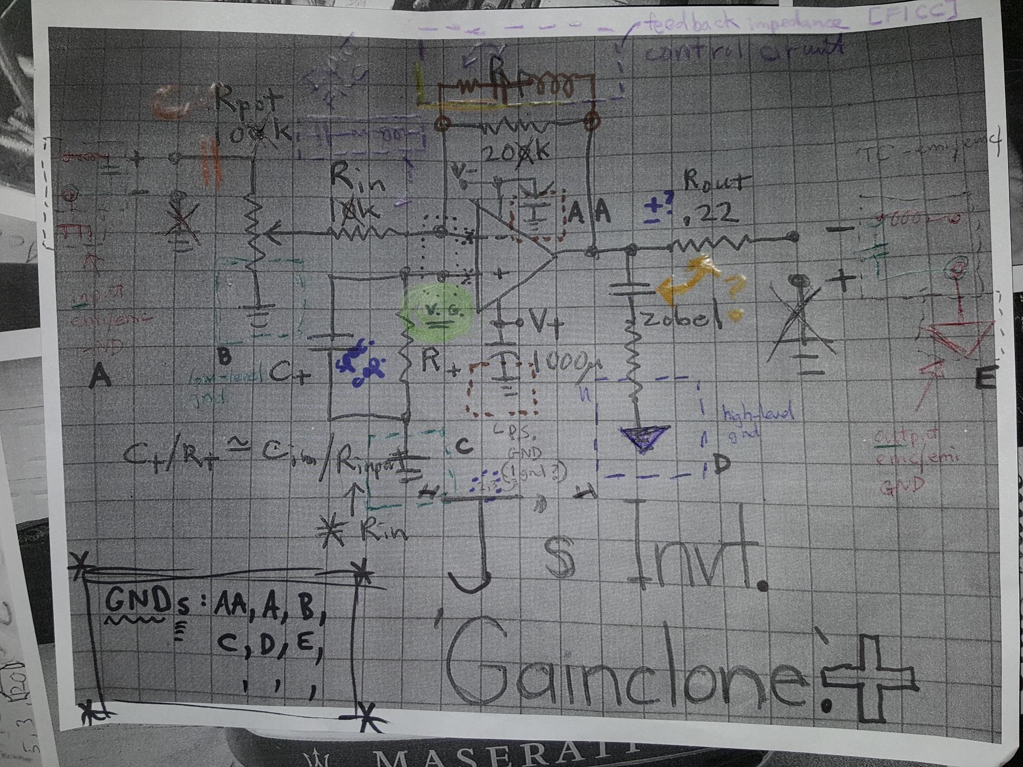

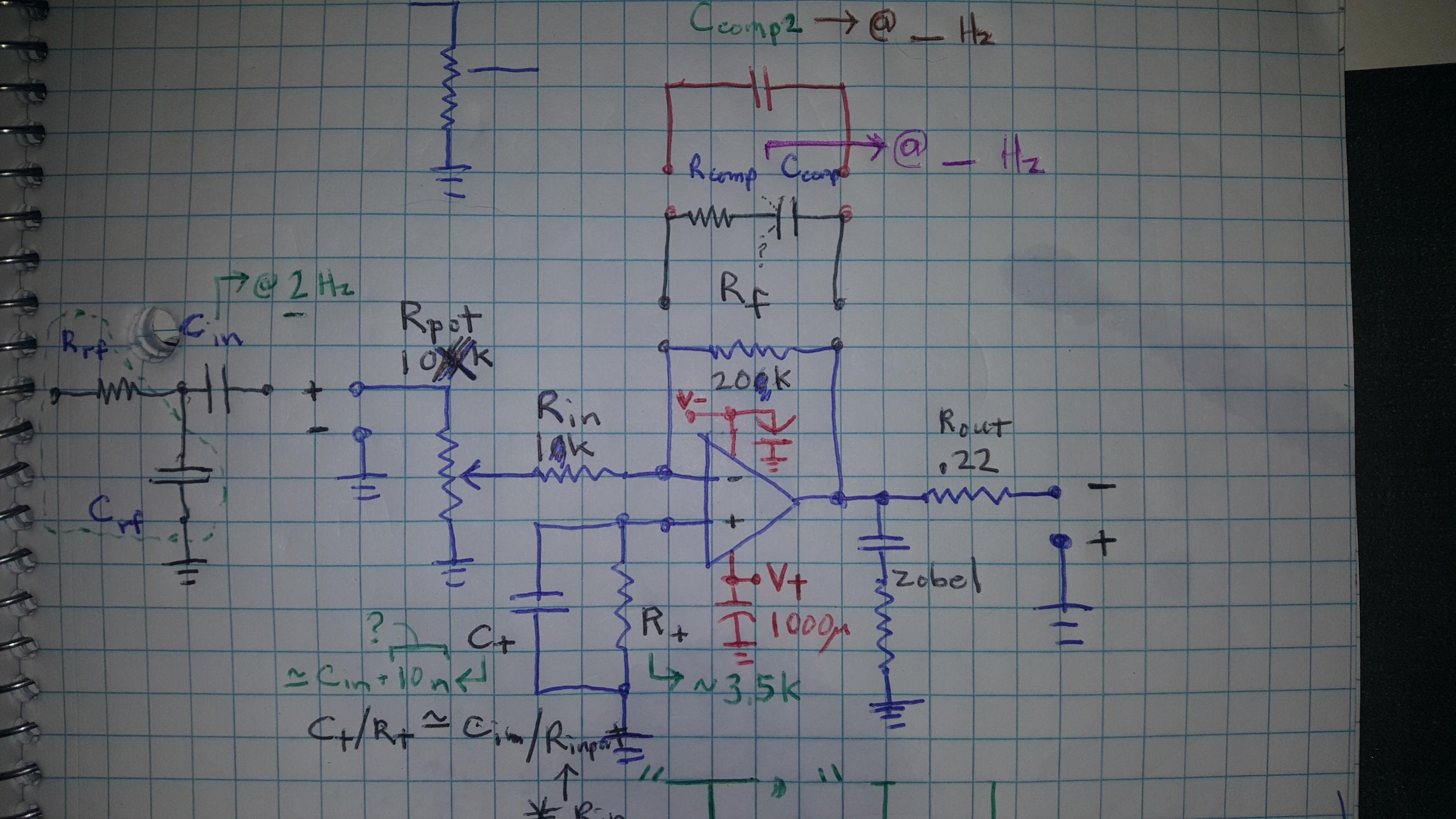

J's inverting gaincard integrated amp
Go given that inductors are inherently hf blocking I just applied generic HF filt. to all inputs and outputs [except ps ...]
Also realized that thus there's way more that just the usual low level and PWR GND.
So it's a work in progress, ... er, ... will it explode?
No seriously ???11?1?® 😱
Jeff
But, just fer giggles, let's try this:
..puttin' the DIY BACK into diyaudio... 😉

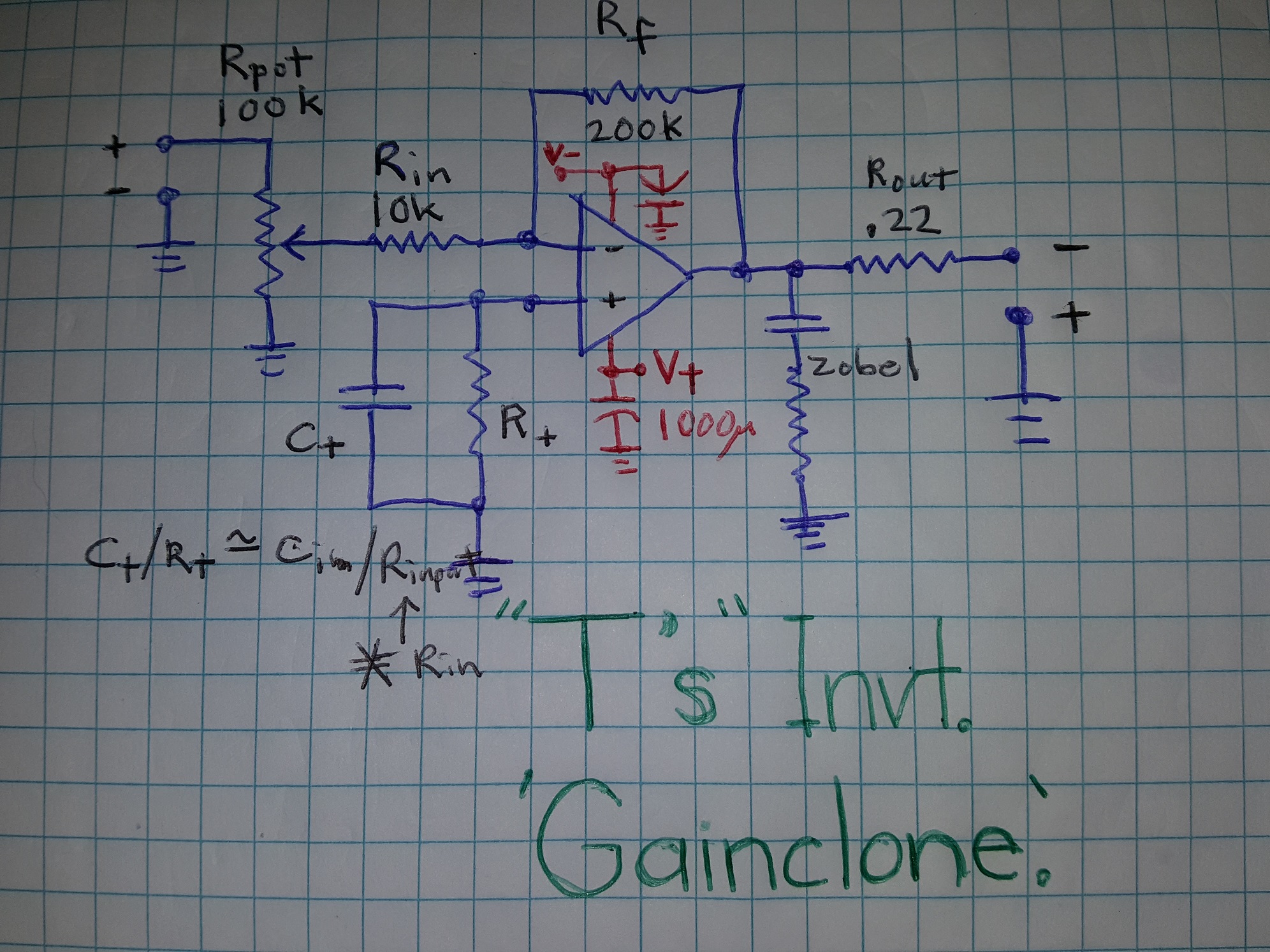

Hun, so this is a recreation of " "T's" Inverted GainClone ". It obliviously 😉 wasn't his, but rather somebody took his idea of an inverted gainclone power amp and thru a pot on the front ...
A) You can choose the values on the +input so they match the -input's (better balance; tweak by actual measurement)
B) Invert. operation provides that nifty virtual ground that, because of the fet input, physically ACTS almost IDEAL [acting purely mathematical with no 'fudge'] and thus that has these tech. advantages ... blah, blah, blah, ... I can't recall what he said.
C) Well, because [in this particular case] the pot sets the input impedance, Rin and Rf can be dropped by an order of magnitude to provide better noise and more current through the resistors and junction that provides futher benifit by ... blah, blah, blah, I can't recall what I thought. ;}
D) So I'd like to correct and develop this circuit and build it and do some basic testing and listening and ... and, d o i t m y s e l f , ... if ya know what I mean ...

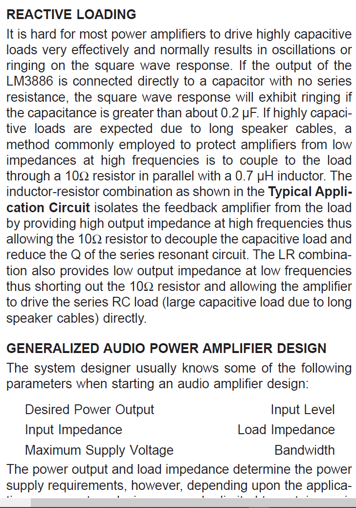

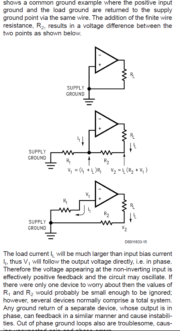

Jeff,
Thank you for the DIY Audio content, having used 3886's in an embedded application I can appreciate your studies...one question: what does paper Spice say about grounding? JK, I don't think any chipamp is quantified in a Spice model well enough to optimize ground paths. I did find normal single-point at the PS filter caps worked well. And IMHO, the output isolation network is not optional, at least the LM3886 does not like driving highly inductive loads, ask me how I know this (driving a motor...)

Jeff,

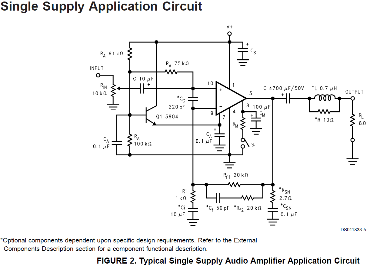

Extra components in single supply application ?!!?!?®
GND paths from 3886 datasheet
Reactive Loads from 3886 datasheet
(only capacitive loads listed; so ... ?!?)

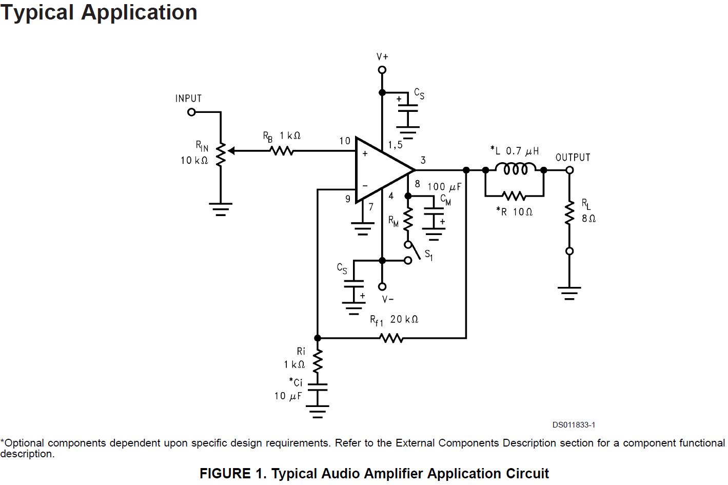

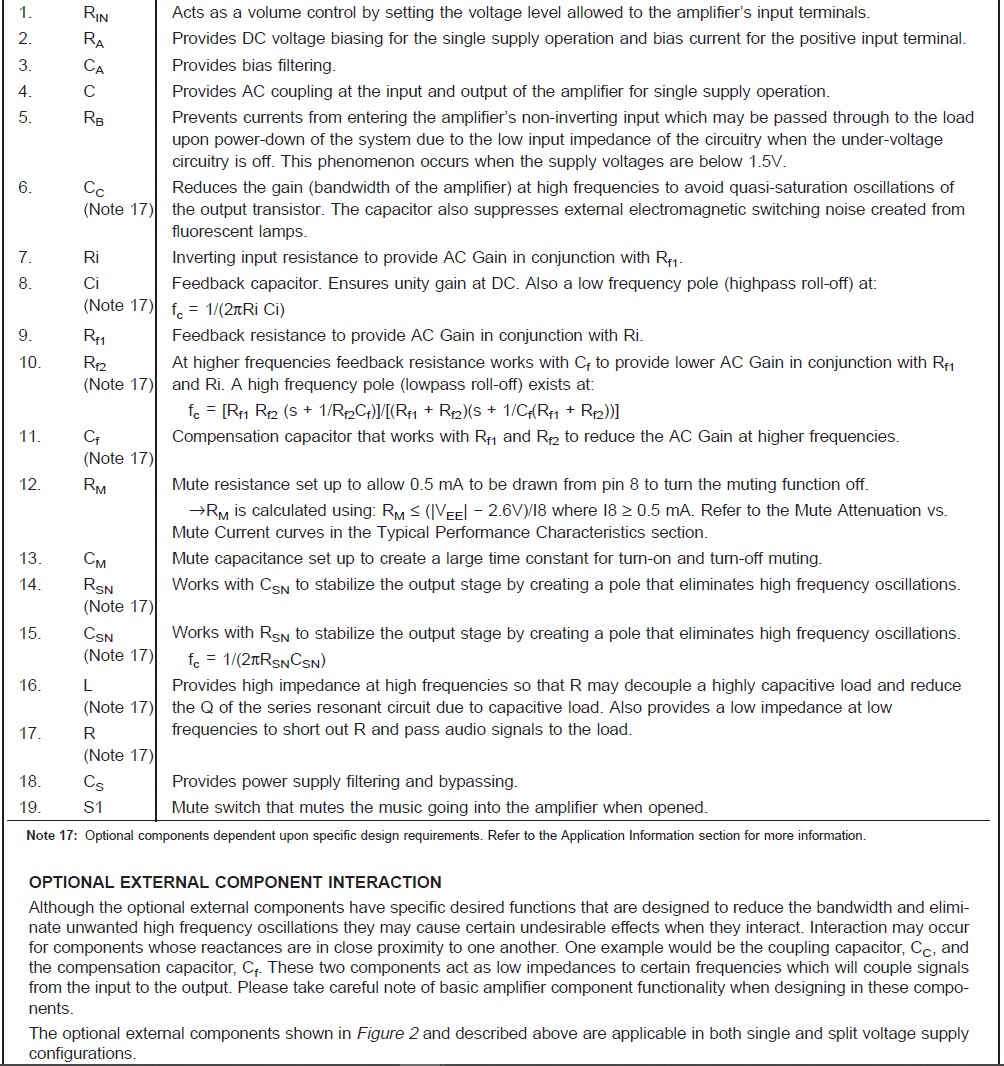

Since I have your ear,
I've always wondered about the extra components in the single supple schematic [esp: Cc; and the stuff around/in feedback 'path' ].
What do you guys think of :
typical dual supply
single supply
component justifications
typical dual supply
single supply
