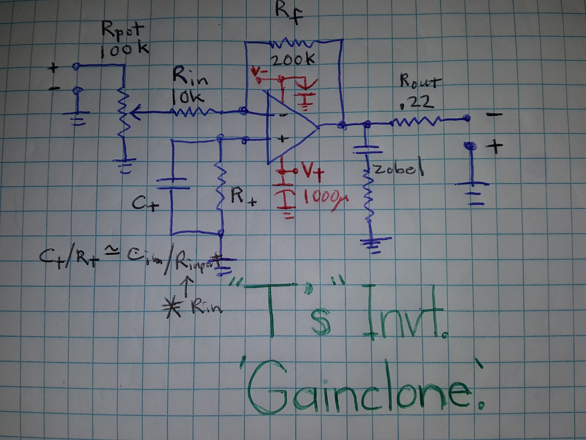

Hun, so this is a recreation of " "T's" Inverted GainClone ". It obliviously 😉 wasn't his, but rather somebody took his idea of an inverted gainclone power amp and thru a pot on the front ...
Doh! [1st Task: why is this 'amp' unstable? ]
So I recall T noting (re his power amp) that using an opamp [no matter signal or power] in invert. config. has some advantages.
A) You can choose the values on the +input so they match the -input's (better balance; tweak by actual measurement)
B) Invert. operation provides that nifty virtual ground that, because of the fet input, physically ACTS almost IDEAL [acting purely mathematical with no 'fudge'] and thus that has these tech. advantages ... blah, blah, blah, ... I can't recall what he said.
...oh, oh , and I thought:
C) Well, because [in this particular case] the pot sets the input impedance, Rin and Rf can be dropped by an order of magnitude to provide better noise and more current through the resistors and junction that provides futher benifit by ... blah, blah, blah, I can't recall what I thought. ;}
D)
So I'd like to correct and develop this circuit and build it and do some basic testing and listening and ... and, d o i t m y s e l f , ... if ya know what I mean ...

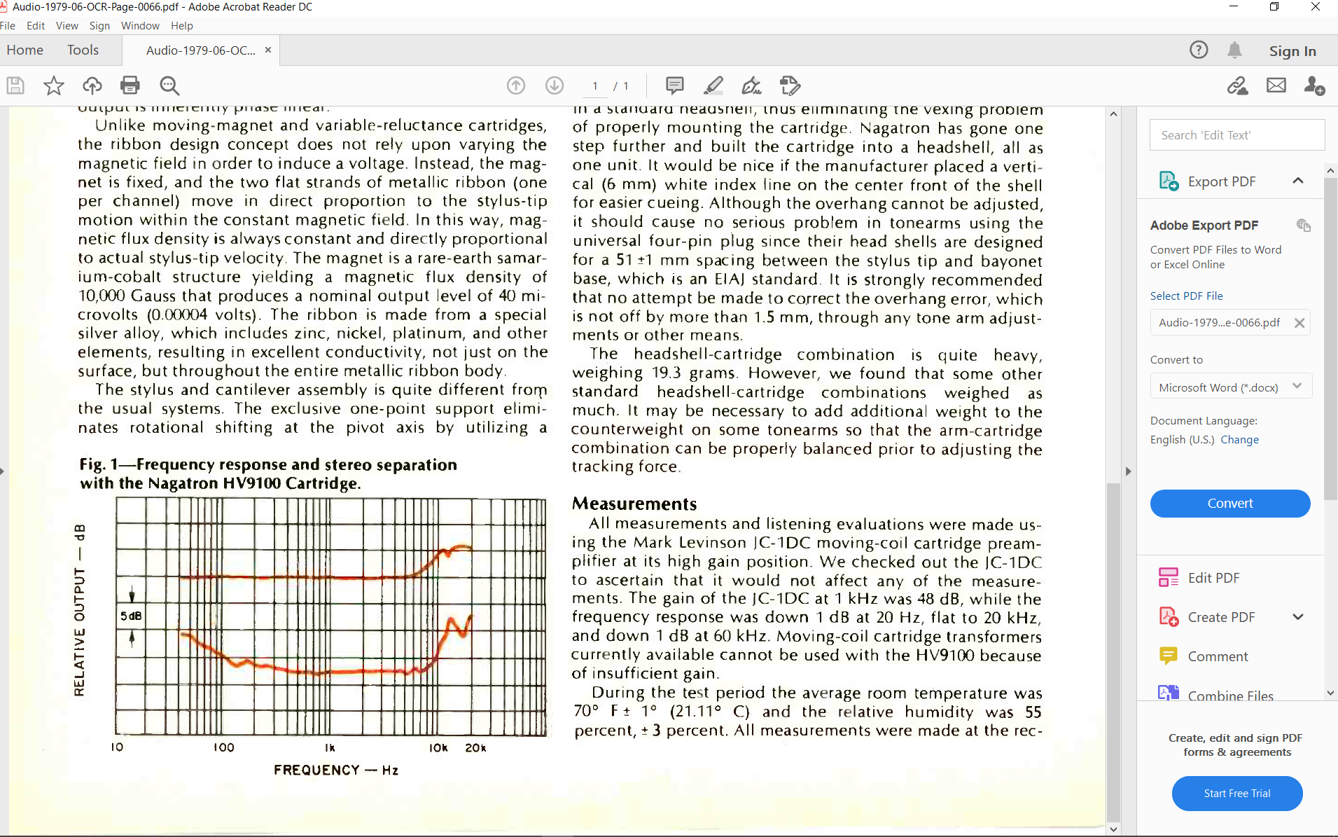

Amusing snippet from the Boston Audio Society. I consider the bolded comment nonsense.
The Lino C 2.0 uses current-mode amplification, and presents a shortcir-
cuit to the moving-coil cartridge. Atkinson claims it is low-noise. However,
current-mode is an inverting amplifier and exhibits a 3dB noise penalty
compared with conventional voltage amplifiers. The Lino C 2.0 measures
-72.2dBAre500mV, whereas the DB Systems head amp under similar
conditions is spec’d at -80dBA. Also, extreme care must be taken to
ensure connections are tight, as any small impedance in the connections
(even a fraction of an ohm, a nonlinearity that can be caused by oxida-
tion), will cause signal loss and possible distortion.

Is the 100K pot loaded with a 10K resistor a linear pot? Interesting way to make a sort of audio taper. However pots do not like having current through the wiper. And the -R changes from 9K to around 100K so matching input Z on the opamp is a "moving" challenge. Not to mention the noise penalty of the large resistors. But it may sound good.

Shhh, wait a day or so; so that everyone can see, correct and think of suggestions / development.
And then we'll see if we thought the same thing!?!
I'll post an updated schematic tomorrow, should be fun.

D) At the signal level and with a non-chipamp, you could use a good quality single "opamp" and fully populate the balance (and comp.?) pins, and ... blah, blah, blah ; I can't remember. ;]
E) When you consider the ... blah, ; )

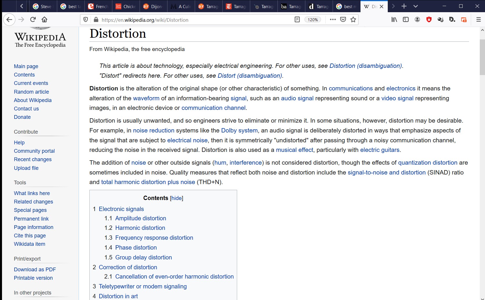

Well, now we're talkin'! It's always allllllll about the distortion isn't it! 😉
So what type of dist are we talkin' 'boot [ 😉 CAN.] here?!?
1.1 Amplitude distortion
1.2 Harmonic distortion
1.3 Frequency response distortion
1.4 Phase distortion
1.5 Group delay distortion

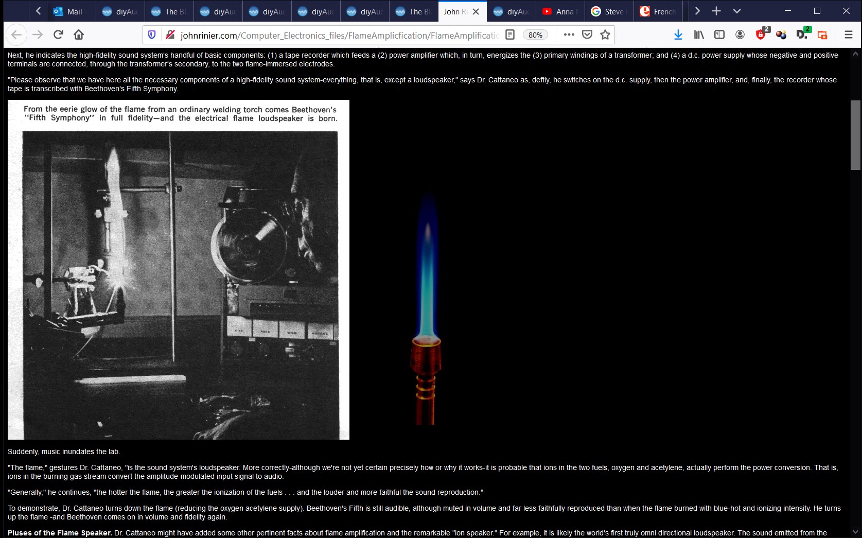

I originally thought "Blowtorch" referred to a flame-plasma electrostatic speaker! Or preamp for such...

...hmm, I think you're overthinking things; ... you could go Fuller Nelson! Some of his designes have a small offset that's then blocked by a big electro in parallel with a film. Tweak circuit to correct DC offset and ... Bob's Yer Uncle!
That right there could be the most awesomest thing I've heard in months!
ahem,
John you have a new name tag for the TradeShows® !!11!1!
Flame-Plasma Electrostatic Speaker Engineer!
... no wait ...
JUNIOUR Flame-Plasma Electrostatic Speaker Engineer!
