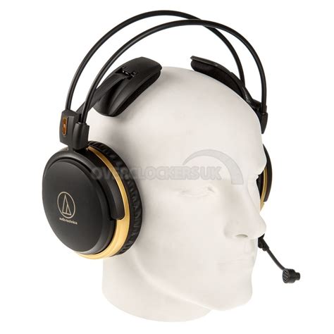

I am using Galaxy S5 phone as source driving ATH-AG1 headphones rated 38ohms load impedance and industry standard clip-on type ferrite split core noise filter.
I don't understand your use of the term transformer in this context ?.
These mega headphones I am using have 53mm drivers and are rated 5Hz-35kHz and they sound it when worn ie unusually clean clear and extended lows and highs and they also make good tabletop loudspeakers in quiet environment.Now it is in the realm of possibility that a human could perceived that distortion, just not very probable. But then it is speculation as to if the perceiver is human!
This Psychoacoustics video is full of suitable esss sounds and the differences in playback sound with or without ferrite filter is pretty clear with headphones worn or on the tabletop and I dare say with training would pass ABX .

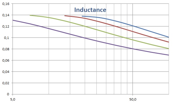

Bad analogy, magnetic hysteresis gives rise to level dependent frequency response enough to be easily measured and actually audible. Of course when you look at a sine wave you only see the slight compressive distortion. Did anyone think to look at an L/R/C filter, for instance, that has 6dB attenuation for a 0dBV input but only 5dB of attenuation for a -6db input? It's known as lots of AM IMD distortion that does not show up on a single amplitude sine wave test.
DA is not level dependent for any capacitor that one would actually use, Bob Pease showed this years ago. The effects of DA are minuscule frequency response deviations, typically 100ths of a dB.
That effect is what Demian just clearly measured for an ESL63 transformer.
Horizontal from 5 to 100Hz, vertical the measured inductance for 4 different levels, from top to bottom resp. 4, 2, 1.25 and 0.6 Volt.
Good use of a multi tone test.
