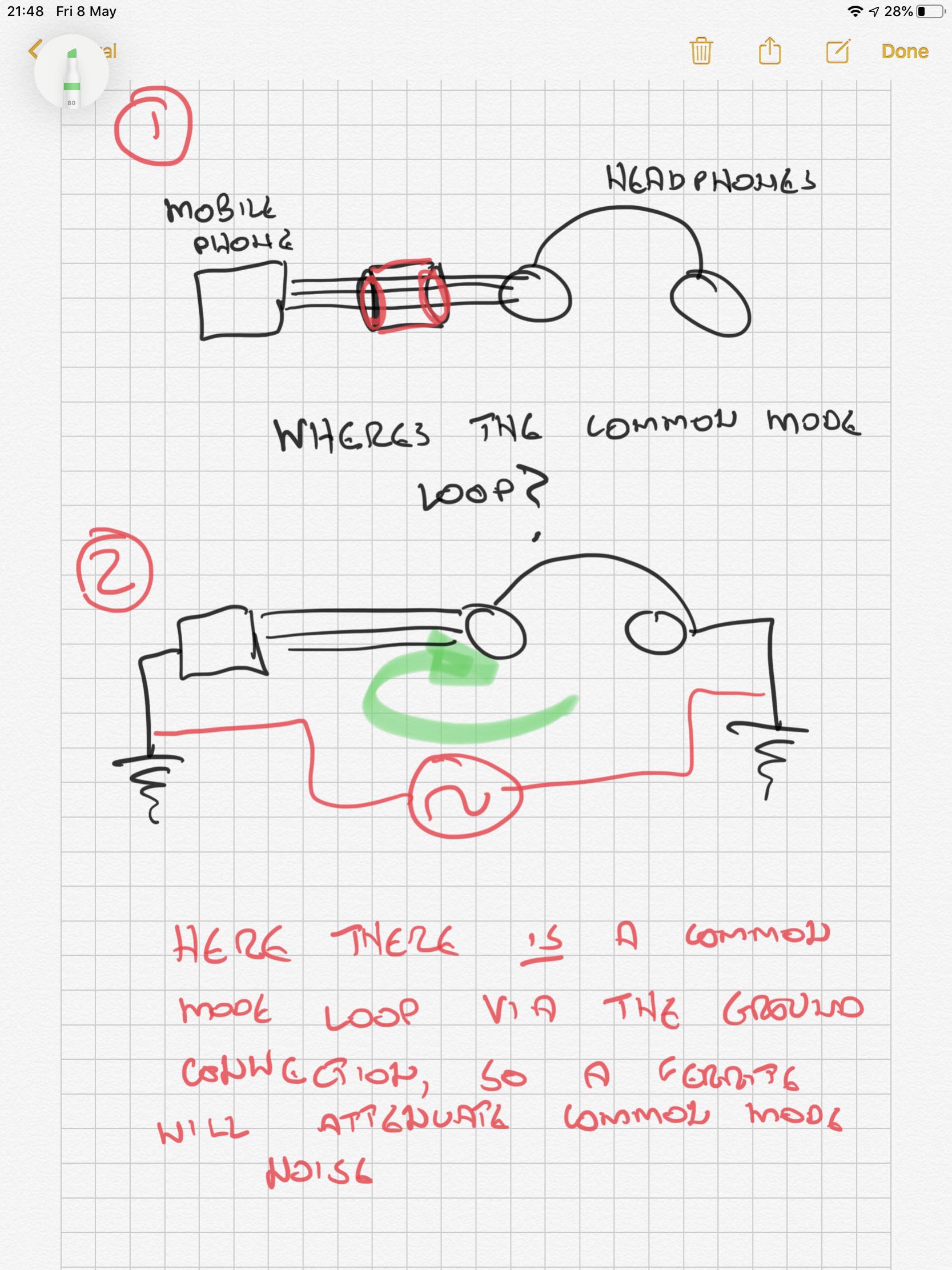

Ed, I can certainly see how a clamp on ferrite on a power cable can reduce mic noise. You have common mode loops all over the place in mains powered equipment. And lots of HF garbage in attendance as well.
My question (objection) was claiming it (ie a common mode clamp around the whole headphone cable) had an effect on the headphone cable plugged into a phone completely floating in air and according to the OP with any capacitive coupling to ground or surrounding items minimized.

There's no common mode loop currents flowing. Nothing.

But there is no current flowing common mode in my first drawing which is what the OP was talking about. So how does a common mode choke work in this situation?
If the headphone end and the gone end coupled to ground capacitively I could imagine a common mode loop current at HF being possibility, but it would be minuscule and hardly a candidate for audibility when you have SMPS’s all over the place.
Draw it out so the mechanism can be seen.
I thought the claim was clamping a ferrite filter on a headphone cable changed the sound.
Where I think we are not communicating is that with a pair of wires that are not twisted into a nonlinear granular magnetic material their is a small field produced by each conductor that is not fully cancelled by transformer action.
By "transformer action" do you mean the differential input of a floating load?
