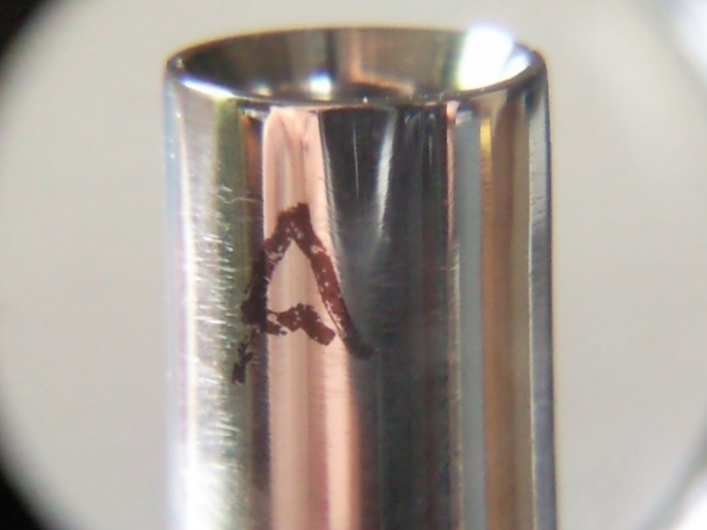

Using a jeweller's loupe held by hand (!) in front of the lens of a telephone to assess and fix a scuba regulator 1st stage (it converts the 300 bar of the cylinder down to 9-10 bar for the 2nd stage): the "Before" pic shows fine scratches that create pressure creeps, and, after a good polish, the "After" pic shows the item as good as, or better than, new. Only the edge at the top does the sealing, the stemp does nothing.
The question is: How did it get scratched? Contamination on the mating surface?
Don't know, it was the first time I took this particular one apart; I have about a dozen of these (wife, 2 kids, yourstruly, and spares). It was freshly serviced by a shop in Singapore, and the pressure was creeping up, so I had to deal with it.
Intermediate pressure creep is relatively common in Scubapro piston 1st stages; there could be a few reasons why, the most plausible one is the service guys just dump everything together in an ultrasonic bath. I always give the piston its own private bath. Other causes could be careless handling, dirty water, salt crystals, and so on.
As long as you mark the unit in some way so if the problem comes back you will know something else is wrong.
