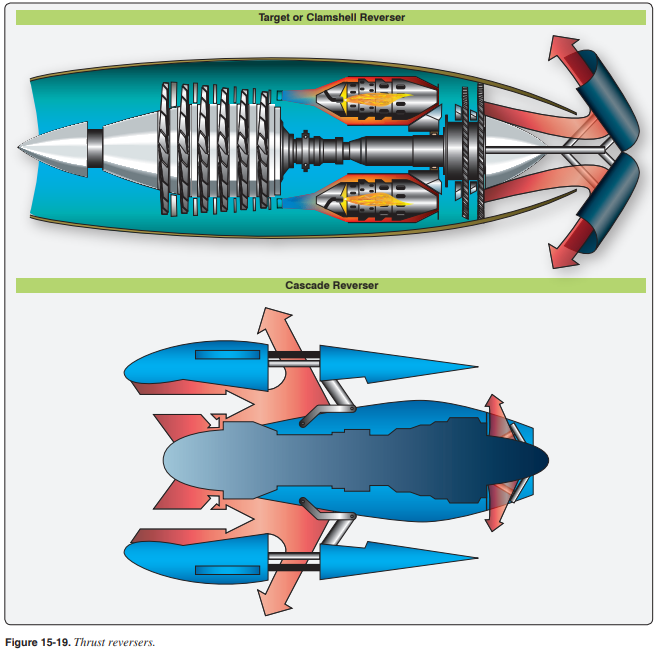

Still a few questions, what about the torque problem that propeller engines have for a turbo fan engine, and what about variable pitch to accommodate the different demand for taking off and cruising for this type of engine ?
And how to reverse the engine after landing to assist the brakes.
Hans
For jets, the rear of the engine cowling is split. For reverse thrust the split cowling opens tilting back at the same time forming a reflector to redirect engine output gases forward.
Engine rotation does not reverse. They operate deflector panels to deflect the fan air stream or the outlet gas stream or both toward the front (thrust reversal ) as Mark wrote.
