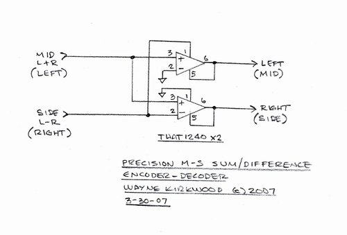

pair of diff amps* initially. THAT1240 are a particularly good way of doing it and gain extra heresy points. Given the cross talk of vinyl I do not expect it to be a huge improvment over simpler methods🙂 Have borrowed Wayne's sketch as quicker than redrawing.
*Opamp/diffamp... Scott W will probably pick me up as they are the same thing, but the precision resitors in the 1240 make it particularly useful for these sort of things.

Why you had to rotate the coils for an M-S output if only to transform their output to a straight L-R? (*)
The point for making an M-S source is to be able to get an adjustable (selectable) image width from full mono to expanded stereo.

Some of this is because I can! the main reason was to have a lateral only channel, but because I am building a M_S processing chain for normal stereo use I figured should add the capability to reverse on the mono cartridge. Again no expectations of a benefit.
The (L-R) switch on the Apt Holman preamp was a lot of fun to fiddle with. It offered a strong hint that much of the Fleetwood Mac female vocal magic may have been, gasp, studio processing.
I think Holman did the width control very well. I'm looking at whether the next step of putting studio style processing in gives any additional gains and horror reactions 😉
