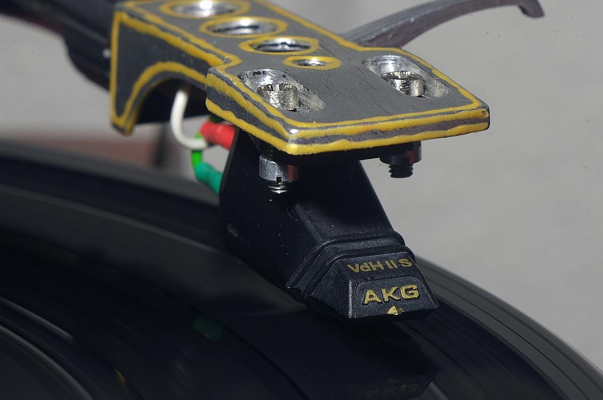

What the heck is that yellow goop around the edges of the cartridge holder, florescent paint so you can handle your turntable in pitch darkness? 😀
Snake oil!!! 🙂

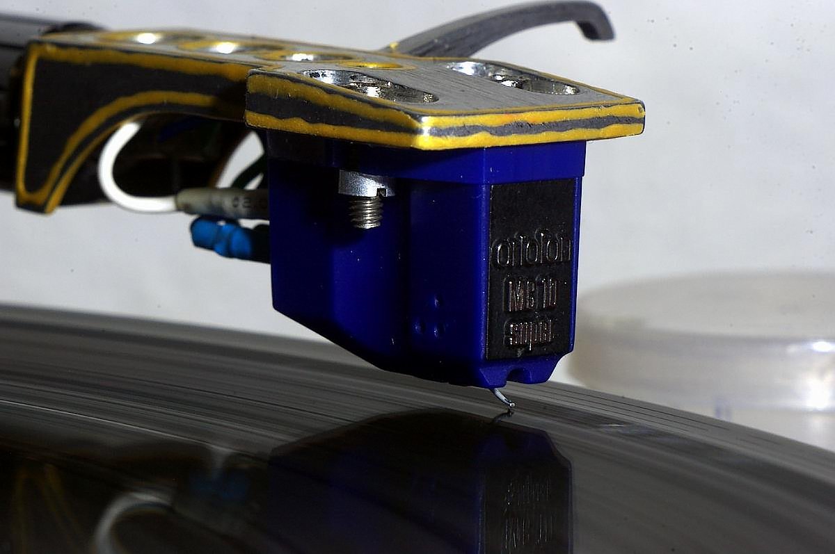

Ortofon MC10 converted to mono operation
You mean you’ve connected the coil pins in series (or parallel)?
and AKG P8ES. I sadly cannot afford an original clear body P8 🙁
The clear body of my tip-less P8ES looks very sexy but one channel measures open.
If you think your cartridge magician can fix it for you, I ‘ll send it to Bojo’s land (well, I am not sure if post service here is shut down too).
What have you done to the headshell?

I had the coils rotated 45 degrees so they read lateral and vertical now.You mean you’ve connected the coil pins in series (or parallel)?
I should have said. Not my headshell. These are pics from the repair shop in Vladivostok.
Oh, Oh! Heading to nirvana Bill.I had the coils rotated 45 degrees so they read lateral and vertical now.
And you 'll feed the lateral reading coil to the preamp leaving the vertical reading coil unconnected?

I will be adding a M-S conversion option into the preamp so I can use it as stereo. Bit like the decca cartridges which use resitive bridge to do the sum and difference.
All an experiment. We shall see how it goes.
