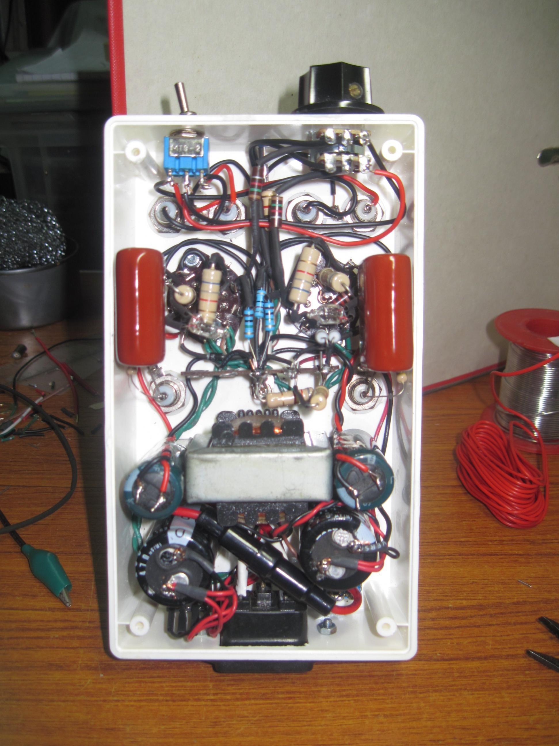

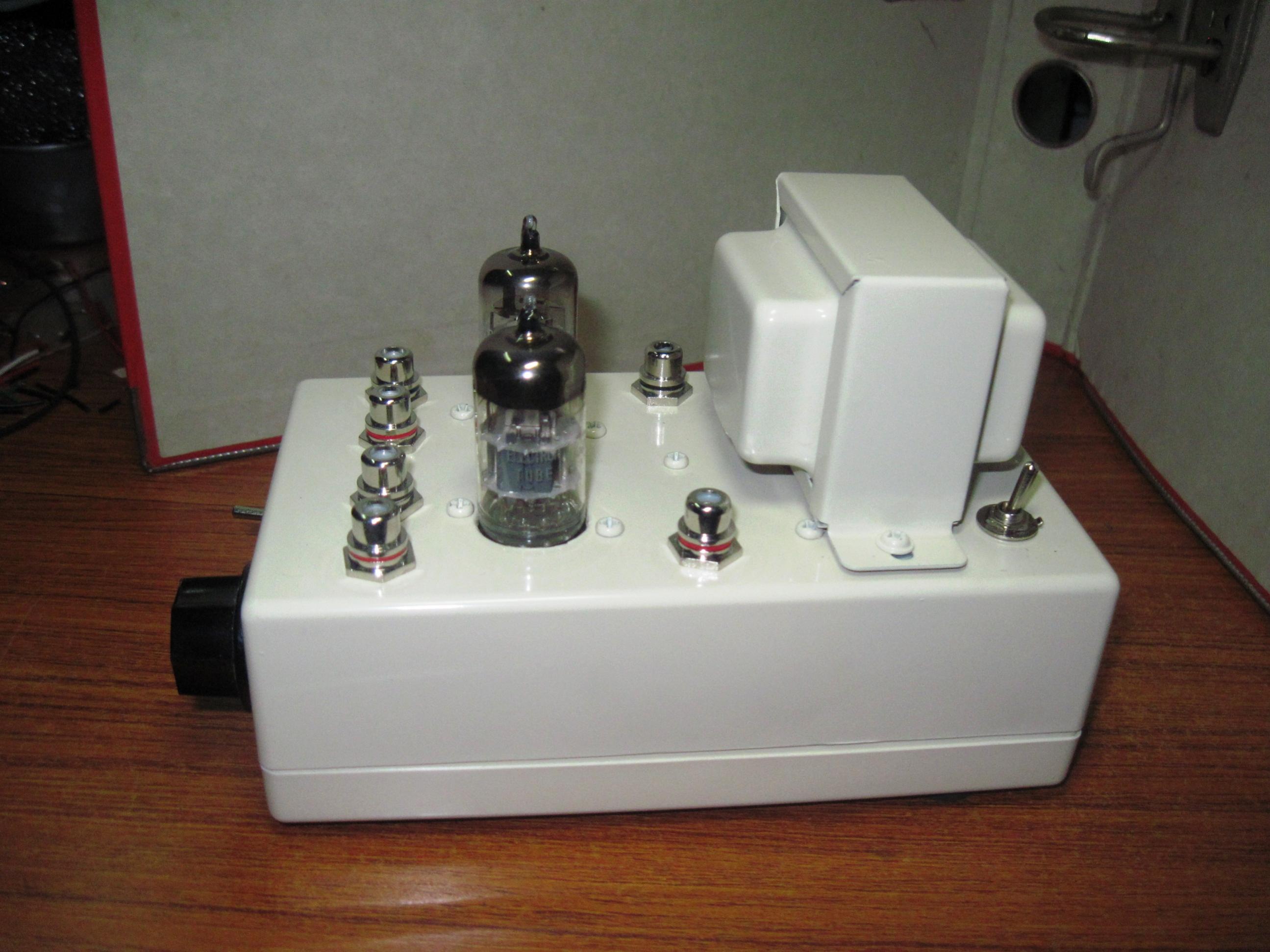

i probably built around 2 dozens of these.....i have lots of friends who liked this line amp.....this is the latest version, 2 sets of inputs 1 set of outputs......this line amp seems to tolerate a lot of tube types, like the 6BK7, 6BQ7's....etc....
how it sounds? very satisfying......😀 and very quiet too, no hums, no hiss....

always a pleasure to look at that one, pure artwork
and Im sure its good, but EL34 and 6AS7 in a preamp....?
the EL34 are just for the CCS. No signal goes through them. I always wanted to get PCBs made up to for something to do. I was thinking this might be the project to do that with.

the key here is to bias the filaments with dc voltage anywhere from 1/4 B+ and higher.....i have resisted the use of voltage regulators, i use massive capacitor filtering instead...😀

as for me, even the most basic of tube circuit can sound good.....and high transconductance tubes are the go to tubes, unlike the much venerated 6SN7's you do not need high voltages to makes these babies sing...😀
