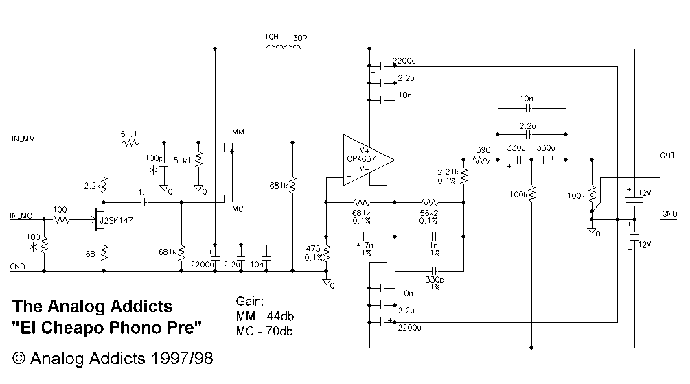

Unfortunately, one important detail is not mentioned:
The application.
I think that making a comparison in a line level with a small gain factor or in a phono pre-amp makes a significant difference, which Op-Amp is to prefer.
I am currently interested in which dual op amps would be to prefer in a MM phono preamp with active RIAA equalization according the circuit topology in the attached images.
Thorsten Loesch prefer the OPA637 - in the iPhono2 the quad version
OV-4627A, go to

and Jeff Rowland prefer the AD744 resp. the dual version AD746 in his replacement phono modules of his preamplifier Coherence ONE
In most applications from commercial RIAA preamp devices according the attached images there is in use the BA4558, NE5532, OPA2134 and OPA2604.
By listening tests in preamp line stage with gain factor arround 4-6 best results I observe by the use with Op-Amps, where internal only one gain stage and high quiecent current in the output stage at the same time was realized.
Excellent examples are the AD797 (I want to know the dual version so as a version with additional jFETs at the input), AD846 and AD844.
Also good (but only with short signal lead to the power amplifier) are the AD829, AD825, AD847, OP604, AD8022 and AD8065/AD8066 (also single gain stage by use of a folded cascode + buffer stage, unfortunately low idle current through the output)
Not good for me are OPA627/637, NE5534, TDA1034, AD8597 and TL071 (probably because the use of two gain stages, i. e. LTP + VAS and the necessary compensation, but unfortunately within the second gain stage = VAS.

Now for me rises up the above mentioned question, because I don't know, whether the same rules apply to the RIAA preamp application from the attachment or not.
Thank you for advices.
