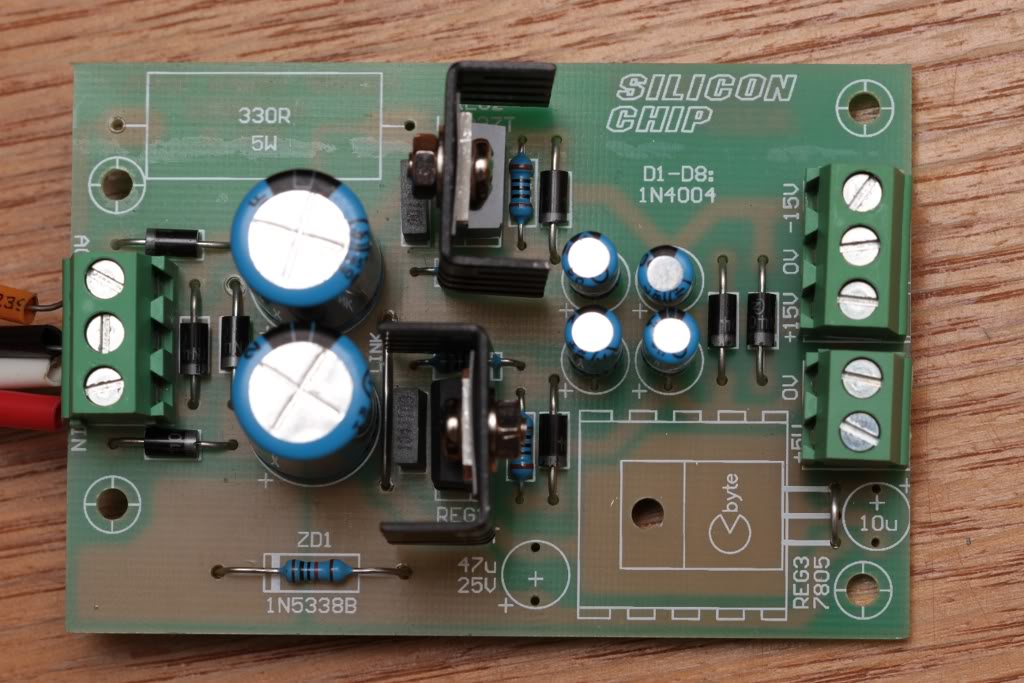

Hello
greetings just recieved LM4562 ics can anyone post a really high quality +/- 15 volt i am presently using the silicon chip studio series regulated +/- 15
volt supply using LM337T LM317T is there any better supply
warm regards
Andrew;)
