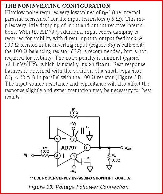

I put two LT1113ACN8 as AK4396 LPF buffer and I was told on another forum:
You can't use not unity gain stable opamps on the HD2, the gain is too low. LT1028, AD797, OPA(2)228, OPA637 etc all don't work or oscillate. The only one's that're stable and I don't know if they're unity gain are AD8022 and AD8397.
It's a voltage out DAC chip (AK4396) so the opamps have a gain of just 1 to supply current and make it single ended. The layout isn't designed to make a gain of 1 good enough for something like the LT1028 and it's never gonna work for uncompensated BB's

it says you can add some components around it to make it unity gain stable...that's what I understood anyway..
so if I read carefully the post I quoted about my soundcard...I need to use opamps that are either stable at +1 or unity gain stable(is that the same thing? sorry for the noobish question!!)
and LT1028/AD797 are stable gain <1, so they're no good to me? they were making strange low frequency garbled sounds from time to time tbh...but well using browndogs in a PC case is a terrible idea anyway 🙄

Unity gain stable means gain of 1 which is for example a buffer with the inverting input tied to the output.
The AD797 is unity gain stable but only if used correctly... this is why I keep saying to Andre that you can't just drop in devices with no regard to the circuit it's going into, and why it's necessary to optimise for a given opamp.

ok, thanks Mooly...finally some technical details I understand 😀
so I should only use op-amps that are given to be stable at a gain of 1(= unity gain).
