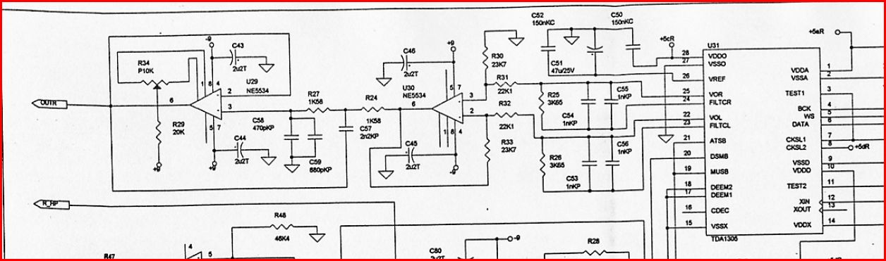

If you saw this, my Micromega Stage (one channel shown) what would you use ?
Forget the offset null pot... as that limits drop in devices... I'm just intrigued what you might use.
I use OPA604 for the I/V and AD845 for the filter/buffer.

I'm a bit in a hurry now... Is the DAC a TDA1305? Or is it "TDA1306"? It's a bit hard to read.. (I'll have to reply later, sorry)

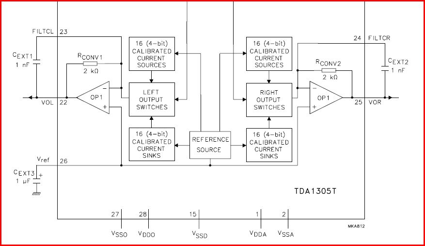

It's actually a TDA1305T (one per channel... the posh way of doing it lol)
If you look at the diagram those "inbuilt" opamps are fully accessible and it would no doubt be possible to add some outboard opamps 🙂
That could be a very interesting mod indeed.

TDA1305...
I would use the LM4562HA, but you need singles... then I would use LME49870 + OPA1611/OPA211ID/OPA627BP. 😉
Thanks Andrea... interesting.
The LM4562 is highly regarded, although dual of course. All the newer types are all surface mount now... not a huge problem I know.
I just feel that what I am using works so well in the Micromega.
And then the amp has an OPA2604 in each channel.
Thanks 🙂

What you have makes: TDA1305 + AD845 + OPA604 = 13445568, which doesn't sound bad. But, with the LME49870 + e.g. OPA1611, you can improve neutrality (besides transparency).
Regarding the LM4562, I added the HA bit because I consider it important given the limitations this chip displays in the plastic DIP form.
