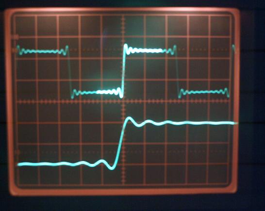

The OPA2604... using the "test circuit" from Audio GD ? have I got the name right.

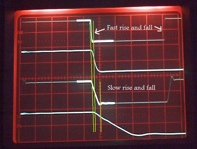

Just some quick scope shots... and just to explain what you are looking at,
the top trace is the input, the one below is the falling edge highlighted, next is the output and again the falling edge highlighted and expanded so you can see more clearly. My generator produces much faster rise/fall times than the one they use in the test 🙂 but you will see what I mean about optimising.
Output is 10volts pk pk (scope adjusted to fit four traces on) and frequency is 100khz.
1. Shows the test circuit from your link. н¨ÍøÒ³ 1
2. Shows same but with the input signal slew rate limited.
3. Shows 15pf comp to the OPA2604
4. Shows 22pf comp to the OPA2604

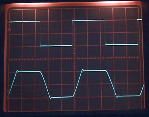

5. Shows why it is important to implement correctly. This shows an NE5532 in the same circuit. A 1k input resistor has been added in series to the input 100 ohm. What you are seeing here is the generator signal (top) and the signal as distorted by the input circuitry of the NE5532 (this is NOT the output you are looking at but the signal on the 100 ohm.

The scope trace's simply show voltage on the vertical scale, and time on the horizontal.
If you look at the input waveform here you can see that the generator signal switches abrubtly as shown by the fast "edges" to the signal. The trace below is with the time scale expanded to show it in detail.
The bottom two traces are the output of the opamp with the lower expanded in the same way.
You can see that the output "slews or changes at a linear rate determined by the actual device in question.
In other words the output can't follow the fast rise and fall time of the generator. Look at the overshoot too on the leading edge (not highlighted)
The vertical green lines show the "time" the input signal takes to fall (1st to 2nd line and the corresponding output of the opamp 1st to 3rd)
By making the input signal change at a slower rate the opamp output can now follow the rate of change... as shown in the other shots.
Get a rate of change that the opamp can cope with and compensate accordingly and you can make the output and input seem identical... as in the audio GD thing.

Square wave testing highlights many problems that would never show on sine testing. Over/undershoot into a capacitive load would not show for one. That shot I showed of the NE5532 input another. Square wave testing is a valuable tool.
I agree that all the tests like this still don't determine "how" a device may sound but it goes a long toward setting a base standard and being able to compare like with like and making sure you are using devices in a correct way.

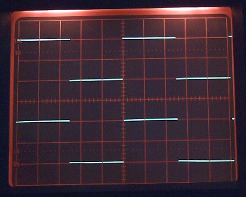

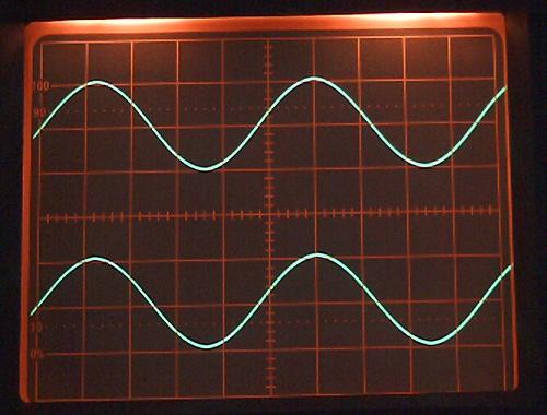

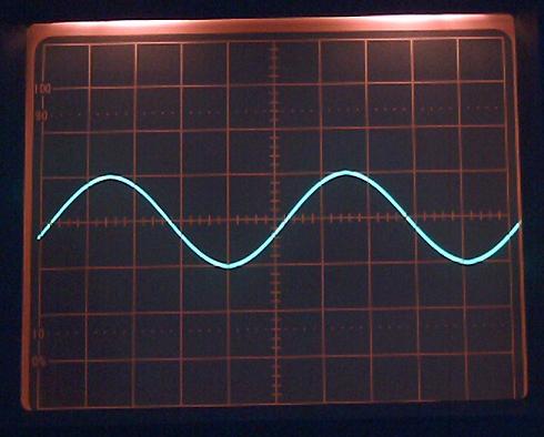

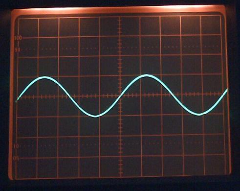

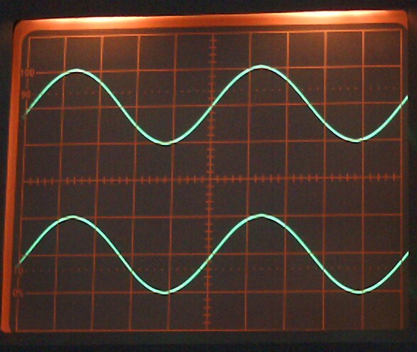

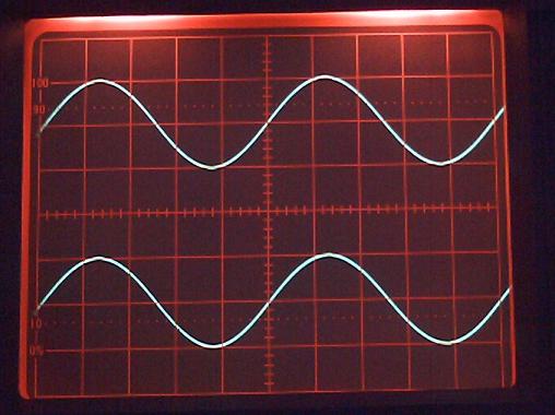

Here are some shots of sinewave testing the NE5532 in the same test circuit. The ouput was 10 volts pk pk.
The "single" trace is input and output overlaid... with the squarewave there was no point 🙂
And square wave,
first at 1khz, second input output overlaid and the last is 100 khz

And this 🙂 🙂 is a dual 741 (4558) at 100 khz and 4 volts pk pk output... the most it can manage at that freq.
On the basis of sinewave testing it's fine.

I hope that goes a little way to showing why square wave testing is so useful.
The frequencies used (100k) and a 10 volt swing are a little unrealistic, but... it's very useful to do.
Can you see how when the 5532 "slews" at that linear rate (when it can't follow the rate of change of input) that any other "detail" during that time frame is lost.
