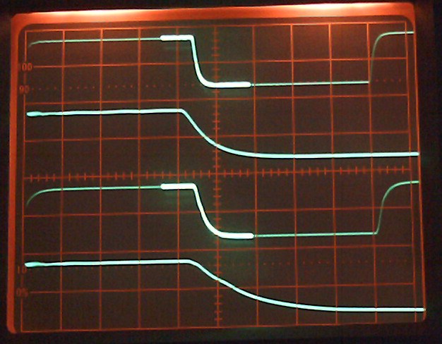

The test circuit again is optimised for the device they are testing, not the one they are comparing against (OPA2604)
Still following this...
One for Leeperry
The OPA2604... using the "test circuit" from Audio GD ? have I got the name right.

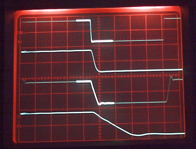

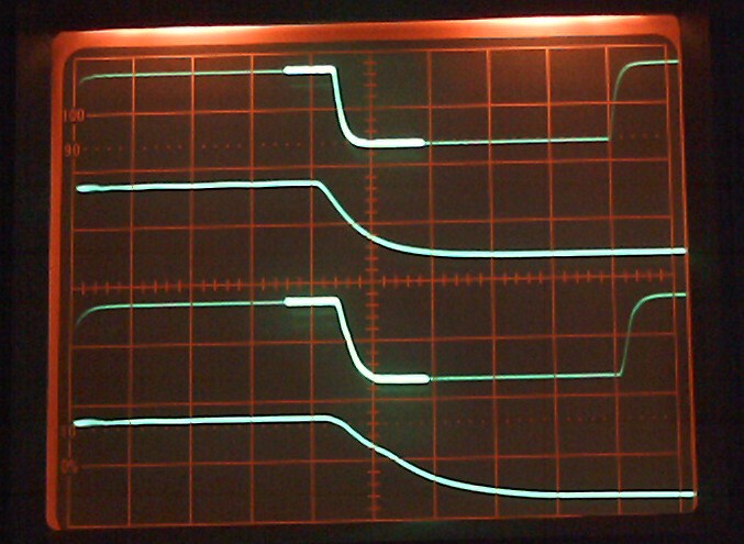

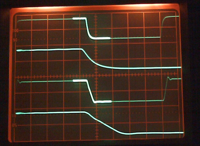

Just some quick scope shots... and just to explain what you are looking at,
the top trace is the input, the one below is the falling edge highlighted, next is the output and again the falling edge highlighted and expanded so you can see more clearly. My generator produces much faster rise/fall times than the one they use in the test but you will see what I mean about optimising.
Output is 10volts pk pk (scope adjusted to fit four traces on) and frequency is 100khz.
1. Shows the test circuit from your link. http://www.audio-gd.com/enweb/pro/diy/OPA.htm
2. Shows same but with the input signal slew rate limited.
3. Shows 15pf comp to the OPA2604
4. Shows 22pf comp to the OPA2604

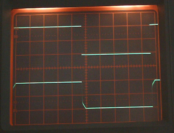

5. Shows why it is important to implement correctly. This shows an NE5532 in the same circuit. A 1k input resistor has been added in series to the input 100 ohm. What you are seeing here is the generator signal (top) and the signal as distorted by the input circuitry of the NE5532 (this is NOT the output you are looking at but the signal on the 100 ohm.
Frequency here lower... 10khz

Seems like an impedance matching issue?...

The NE5532 must sound rather bad in that circuit.Still following this...
