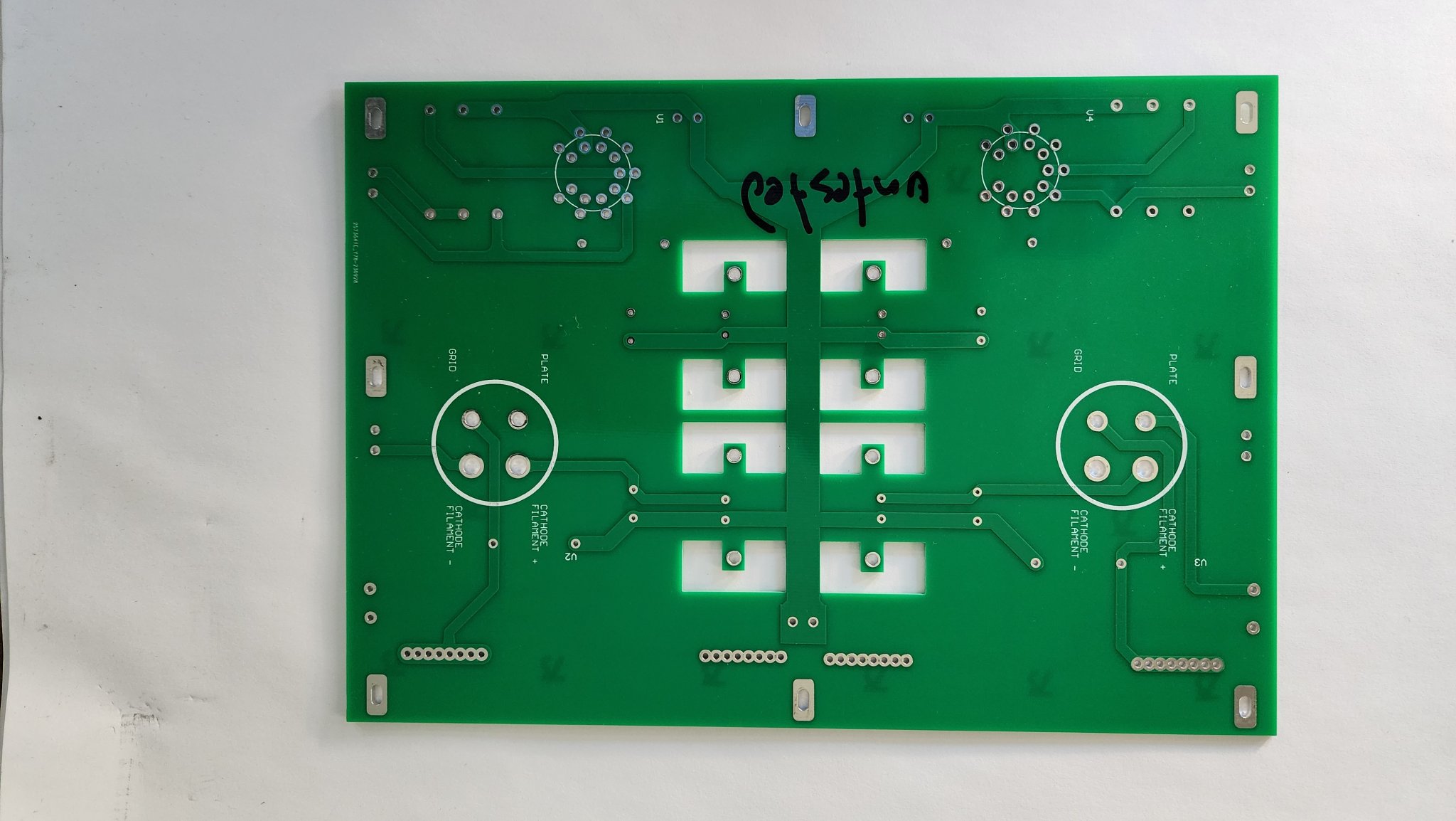

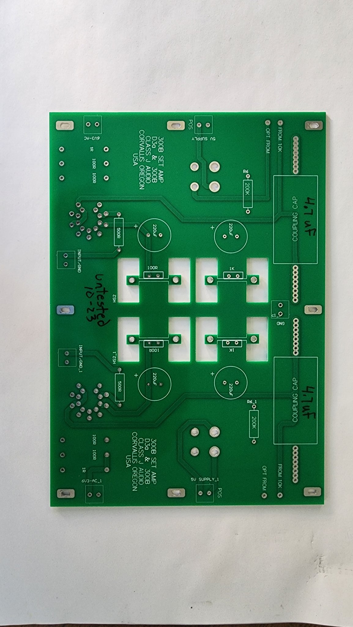

I recently moved to Allentown PA and when unpacking I noticed I have 10 pcbs for this amp. Its just the audio portion. But if anyone wants one email me and we'll make it happen. 300B/D3a, Zero feedback. Personally the best sounding SET amp I have heard. FWIW. I will include a schematic and moderate tech support if required.
Jeff

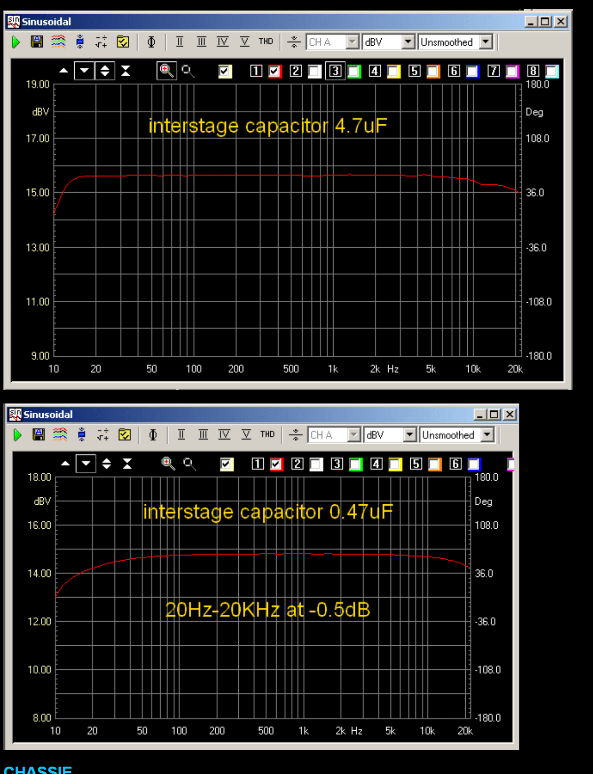

Yes I used the 4.7ufs. Here is plots with .47uf and 4.7uf. The Bass improvement with the 4.7uf is significant.
I have film caps in my entire power supply So I embraced the soup can motif and went with it.
Agreed, with 0.47u there would be too much low end rolloff. I ran some simulations on my side and decided to use 2.2u as a trade-off between bass extension and capacitors size/cost.

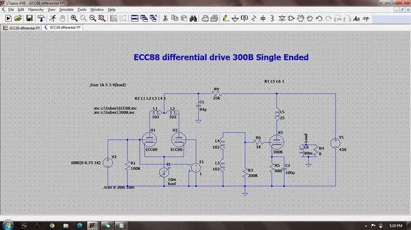

For the 300B I am using Rod Coleman's filament supply which, according to many, performs really well.
I also made other variations compared to the original circuit:
  • DC Filament + LED bias circuit for the D3a
  • Fixed biased through an external negative supply (whose value can be set with a trimmer) for the 300B
  • Monolith Magnetics custom OPTs based on the SX-11 nanocrystal core (I have high expectations on these)
  • Replaced all the electrolytics with high low ESR DC-Link caps
  • 2.2 uF Duelund CAST Cu-Sn coupling capacitor (I love Duelunds)
I am bulding the circuit in sub-blocks so I will be able to replace any of the sub-block at any time and try for a different circuit.
At some point I'd be curious to try the high frequency AC filament supply, but it's something that I am leaving for the future
