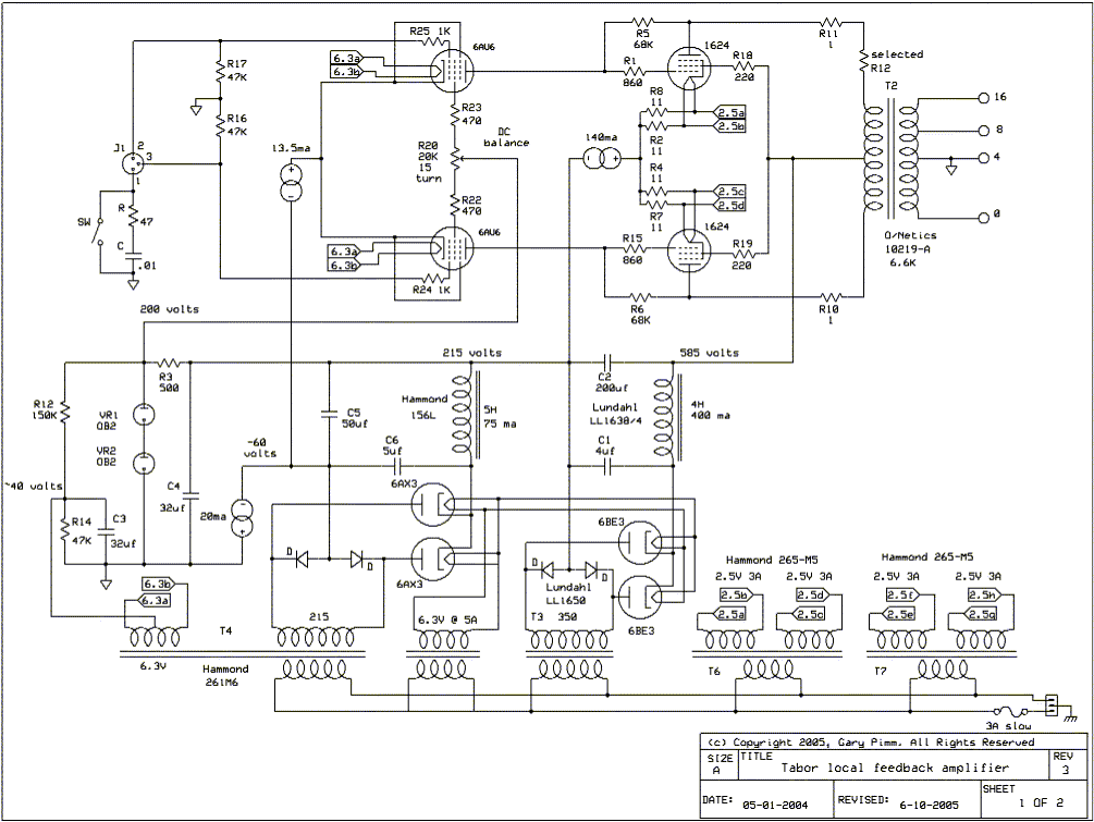

Thank you for the schematic of the "Tabor local feedback amplifier". It indeed only has one pair of resistors, acting both as the load resistors for the pre-stage and as the feedback resistors.
I'm out of my depth when it comes to understanding how this circuit exactly works but after some reading of older threads about this amplifier, I get the impression that the gain of this amplifier is low and that it's essential that the pre-stage has pentodes in it.
How does this topology 'translate' to the attached circuit? To drive the 300B to full power something like 75 V of signal is needed on its grid. Can the triode connected D3a provide this? And what signal voltage would the D3a need at its control grid to drive the 300B to full power?
D3a triode has mu of about 50. RC-coupled D3a stage of your schematic will have gain of about 30. With 2 VRMS input signal, the output of 60 VRMS is sufficient to drive 300B to full power.
The weak point is driver's low plate voltage relative to its output, which will cause significant distortion at high output levels. This can be remedied by choke loading instead of resistor loading. Gain will increase with choke loading. Same applies to interstage transformer coupling.
So 2Vrms at the input of this amplifier is enough, eventhough the load resistor of the D3a is connected to the plate of the 300B?
Gary Pimm got away with this because both his driver and power tubes are pentodes. For the same reason he didn't need high DC current in the driver stage.
OK, thanks. So I conclude that the amplifier (schematic in post #6 and post #23) will be a very poor performer (hardly any power output).With Schade feedback, gain will be significantly less and driver's output insufficient.
Those schematics are not in accordance with the original design, which can be found here (scroll down a little): SchematicOK, thanks. So I conclude that the amplifier (schematic in post #6 and post #23) will be a very poor performer (hardly any power output).
Thanks, but I knew that. The schematic that represents the amplifier of TS is in post #1 and follows the original design you linked to.

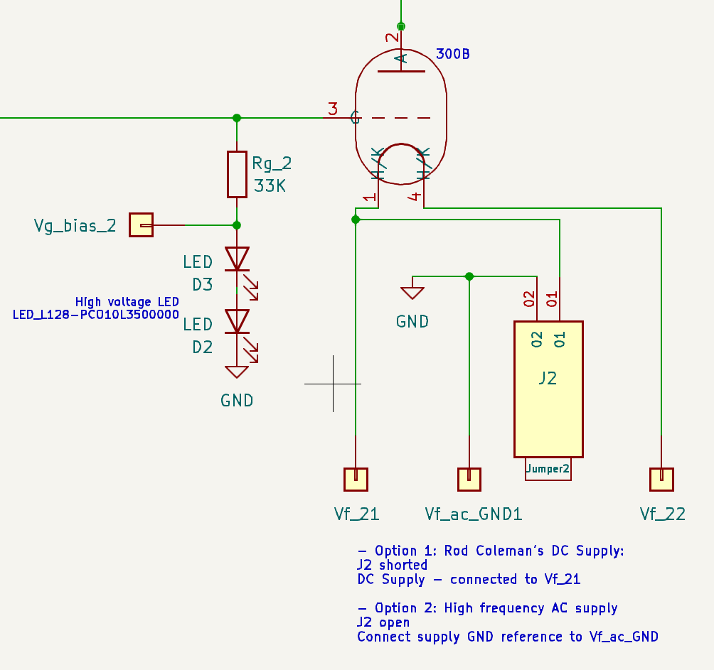

I am also planning to build the same amplifier and I am glad to hear you liked it.
Iam modifying the schematic to use fixed bias on the power stage, and a hybrid LED + filament bias on the driver stage.
Also, I am having some custom OPTs built by monolith magnetics instead of the LLs.
I am also a big fan of Duelunds capacitors, and I will most likely used PIO Cast Cu/Ag for the coupling of the 2 stages.
I will soon post the full schematic.
@jwags81818

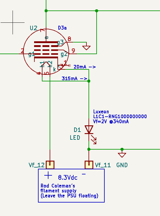

These are the mods to the biasing circuitry that I am making to the original design from A. Ciuffoli
D3a filament/LED bias
300B gate bias + DC Filament
