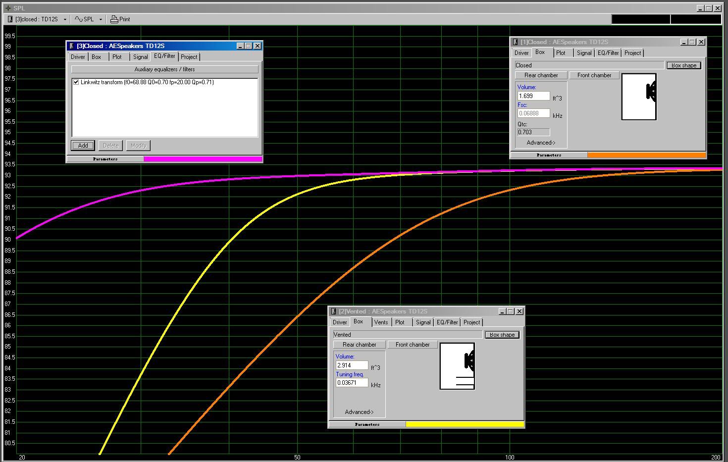

Because the TD6M has cone breakup starting around 3Khz, a steep filter like 2Khz LR4-acoustic or similar FIR is necessary. In a 0.2cuft sealed volume, the TD6M produces 93db/watt with an F3~155Hz. DSP cannot correct random cone breakup distortion effects.
Sealed woofers with bass boost and room equalization will have the best transient response and smoothest SPL, but the lower efficiency favors two woofers to rock 'n roll. Two TD12S require 3.4cuft sealed volume for Qtc = 0.7. A modest size bass cabinet. 93db/watt for one; 96db/watt for two with each speaker connected to a separate amp; 99db/watt for two wired in parallel as a low impedance load to one amplifier. DSP boost on the woofers can cover any required baffle step boost. Some cabinet-effect equalization might be necessary on the TD6M.

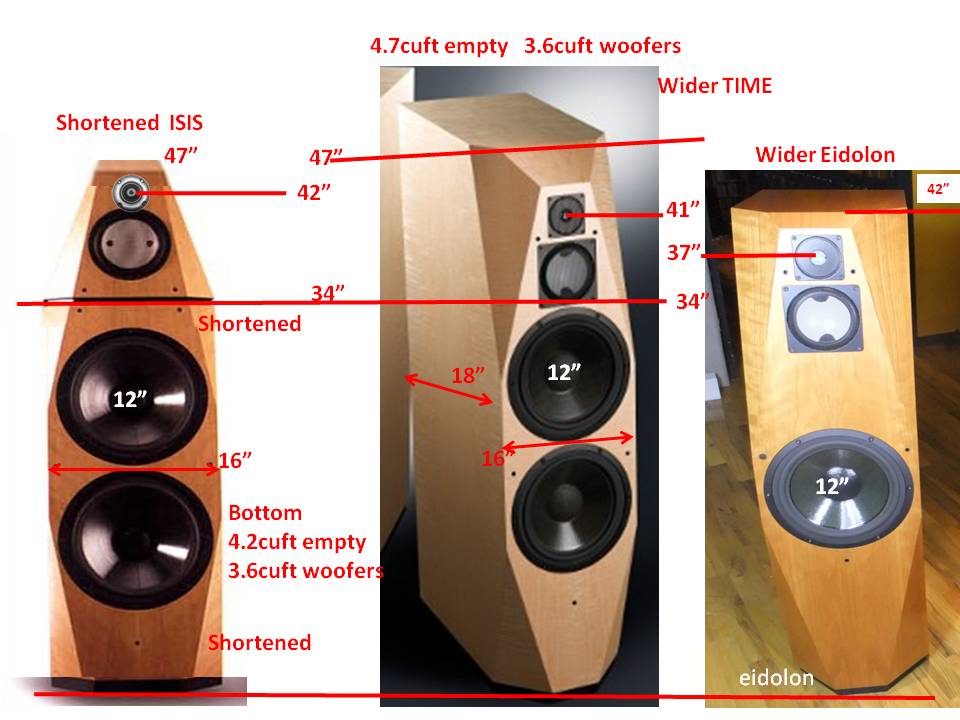

CABINET: A single shared-volume cabinet like the Avalon Time would have the smallest physical room presence. A two box TM - WW design would allow the TM cabinet more options for vibration isolation and aggressive construction for edge diffraction reduction. Do you have a favorite cabinet design?

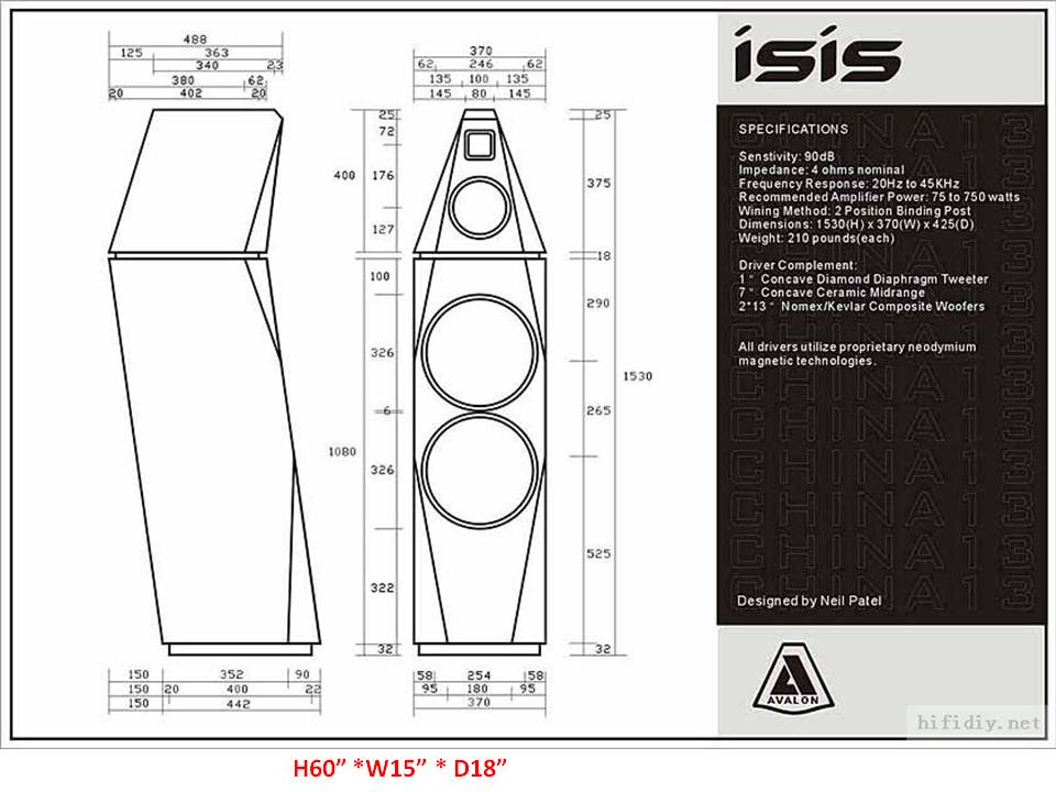

The 2-box Avalon ISIS is 60" high with a 54" high tweeter, and uses angled baffles to time align the T+M+W arrivals at the listener. You could mimic the ISIS cabinet shape in a shorter flat-baffle design with a 42" high ear-level tweeter, so it now looks a little like a 2-piece Avalon TIME. DSP would provide time alignment for T+M+W, so the front baffle "could be" flat. The single cabinet TIME would be physically smaller since the woofers can use the volume behind the TM drivers. Since two TD12S drivers only require ~3.4cuft in a sealed Qtc=0.7 alignment, the size(volume=depth) penalty for a two cabinet (TM) +( WW) is probably acceptable for the artistic values, and the options for vibration isolation and aggressive construction for edge diffraction reduction.

For reduced weight for moving, you could build a 1.7-1.8 cuft sealed box for each TD12S, plus a separate TM box. Three lighter boxes with a higher total weight. The "rounds" cabinet design in post #221 lower right corner offers very good edge diffraction control without a super-thick front baffle. There are MDF edge rounds available on-line as shown in #221. The Avalon cabinets use large stack-up heavy baffles with complex angle cuts for reducing edge diffraction. So, depends upon both "style" and wood shop equipment.
