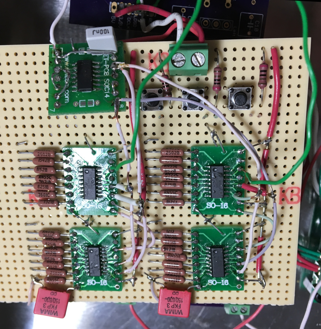

Update on my NO DAC DSD experiments
1. Sound from JLS relay SE board with a 90ohm/22nf RC filter never sounded close to musically right. The power Vregs used are a 5V Belleson for external USB power and a 5V ADM7150 for the isolated side.
2. Driving a 390ohm/10nf RC filter with 9 parallel logic gate outputs did nothing to improve the sound.
3. Putting a Potato Semi logic gate chip in the digital signal path did not clean up the digital signal to the op amp/DC blocking circuit which had a 390/10nf RC filter.
4. A JLS interface board of my own design using 74ALVCxx logic family chips sounded much better as the feed to the op amp/DC blocking circuit with the 390/10nf RC filter. Without this partial success I would have shelved the NO DAC DSD project.
5. The idea or using a 16-bit sine wave weighted moving average pre-filter kept gnawing away at me so in a masochistic moment I ordered the parts and built one on a perf board using 74VHC595 8-bit shift registers and Dale RN55 resisters. See picture. I inserted it between my JLS interface board and the op amp/DC blocking circuit with the 390/10nf RC filter. The first shock came when sound actually came through all this. The treble was congested a bit as if there was too much filtering. I changed the op amp RC filter to 250ohm/10nf which is a 60KHz LPF and the music became surprising good. Lots of detail and rich instrumental timbre. I am using Grado GS1000 headphones for listening tests. There is some “new parts sound” but this is diminishing with 24/7 play time. The 16-bit sine filter also seems to cancel most of the noise.
Next Steps:
1. I am encouraged enough by the SQ to design a PCB for the 16-bit sine pre-filter which can also be improved.
2. The JLS interface board layout needs to be changed to put the logic input gates right at the DSD pins from the JLSounds board to cut down on the “antenna noise” effect.
3. The RC filter values are nowhere near optimized. I will build an LDR variable resistor to make this much easier. The LDR is also an excellent sounding resistor.

Update on my NO DAC DSD experiments - cont
Putting a 74ALVC04 logic gate right at the JLSounds pins for DSD signals greatly reduced the noise and antenna effect.
Instead of the 16-bit sine wave weighted averaging board smearing musical details it actually increases the amount of detail. 16 bit averaging at 2xDSD acts like a 375Khz LPF which is updated continuously at the DSD clock rate.
I am hearing a mixture of amazingly good music with a small but still unacceptably high amount of digital and new parts sound. The bass is deep, tight and full of impact. Instrument and voice resolution compares with the best I have ever heard. Lots of musical energy.
I will be doing many tests with PCB's and parts that will be arriving shortly. The sine weighting resistor values accuracy will be improved by a factor of 10. The digital signal paths will be shorter. The power supply for the DC blocking/op amp/RC filter board will be upgraded.
The entire DSD signal streams including logic gate noise, over shooting, non-symmetrical signal rise and fall rates, etc are consumed and filtered into an analog like signal. I will attempt to make the digital 1's and 0's more symmetrical before conversion.
I should have enough results to report on this thread in 3-4 weeks.

The resistor weights are not so important. This is not an R2R ladder DAC.
I would concentrate more on proper digtal design principles like decoupling
for the chips and very low jitter. Ground plane etc.
The thing with overshoot and jitter is your low pass filter may well eat it all up but the energy is not removed but transformed and inserted into your
audio signal. It ends up as various forms of distortion.
Doing this circuit right is not trivial.
