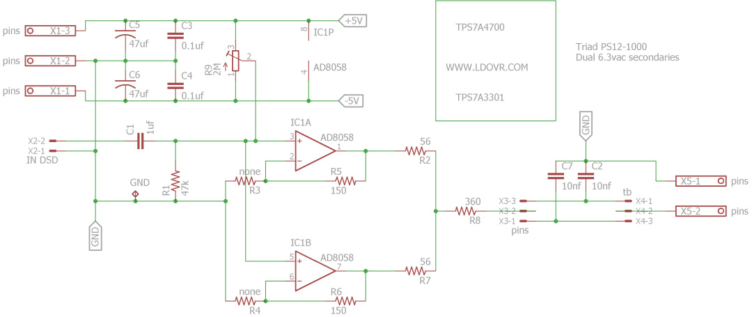

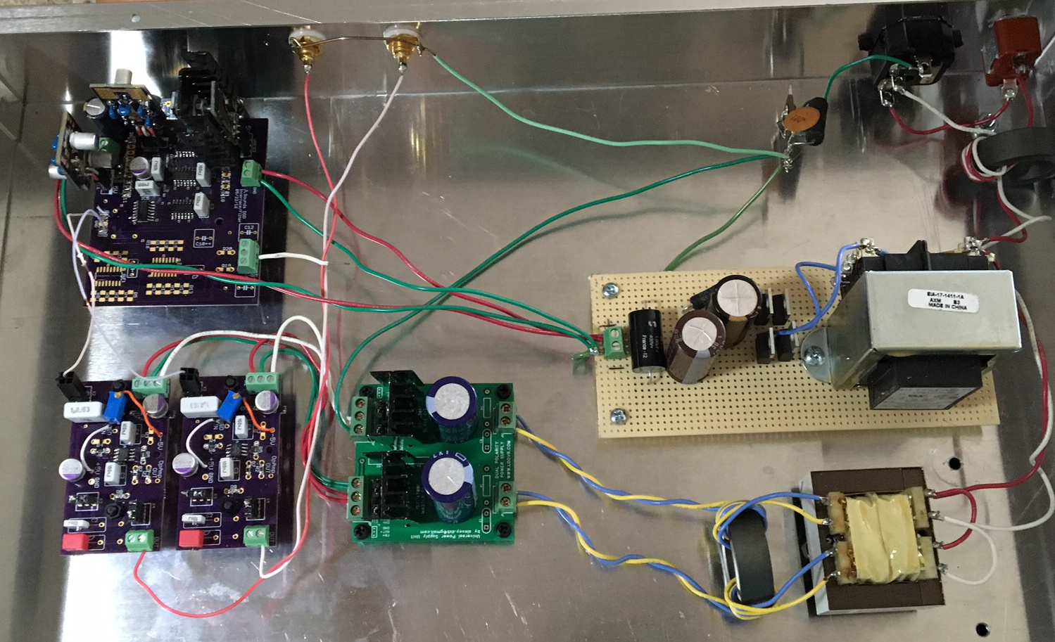

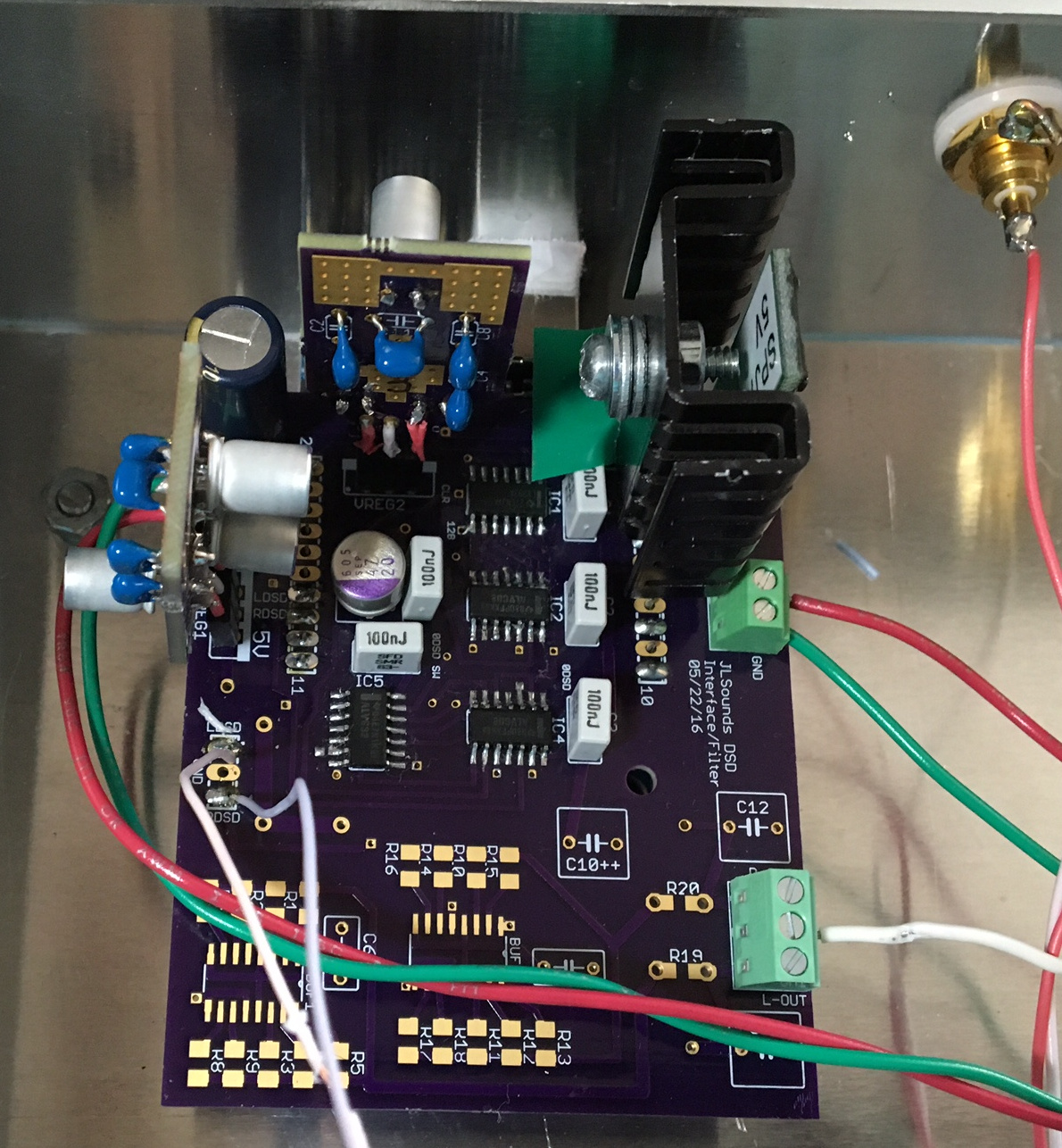

I'm finally listening to music from the JLSounds board using an interface board of my own design coupled through a 1uf/47K 4Hz HPF to remove the DC offset to a dual high frequency op amp to drive the digital signal through a 390ohm/10nf LPF. Below is the DC Removal Op Amp RC Filter circuit and some chassis/PCB pictures. The output of the op amp is directly connected to the RCA output jacks. Analog Devices recommends this 350Mhz op amp for use as a digital clock fan-out device.
It sounded good to start with except for some hiss like that heard on a radio station. I replaced the USB 5V power with a 2amp Belleson Vreg on my JLS interface board and the sound became magical except for continued light hissing. The bass is tight and deep. Voices sound natural. Percussion is precise. Music flows with a rich texture that is unfatiguing. And this is using JRiver in Windows 8 at 1XDSD dop from 44/16 source material so there is room for improvement.
About the hissing sound. Because a relay to switch between DSD signals being present or not seemed clunky to me I designed a JLS interface board to switch to a 3Mhz square wave derived from the Pin 20 12Mhz signal from the JLS board when there is no DSD signal. There is no hiss at all with this simulated DSD signal representing a 0 volt analog signal. I can see this square wave on a scope going into and out of the op amp, but with no hiss. When I switch to music I get hiss. Any ideas? Could it be the JLSounds board?
I am also having problems with occasional snapping sounds at 1XDSD but are very frequent at 2XDSD. I have version 2 of this interface board coming in shortly which might solve the snapping sounds.

I put one of the early versions of the SE Relay RC boards on the JLSounds and used output capacitors to get rid of the DC offset. There was no hissing which means that my JLSounds board is good and that JRiver was not generating the hiss. I still had the snapping sound but this went away when I changed the XMOS output from ASIO to WASAPI. Now 2xDSD has no snapping sounds. The hissing must be some interference from my DIY JLS interface board.
The sound quality was good but didn't have the musical detail and magic I heard before. I removed the capacitor of the RC filter and connected the DSD signals to my op amp board to remove the DC offset and use the op amp to drive the signal through an RC filter. The music now has more detail and is more listenable. Tomorrow I will replace the USB power with a 5V Belleson located right at the SE Relay RC board.

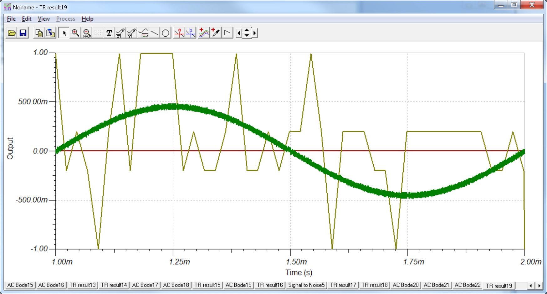

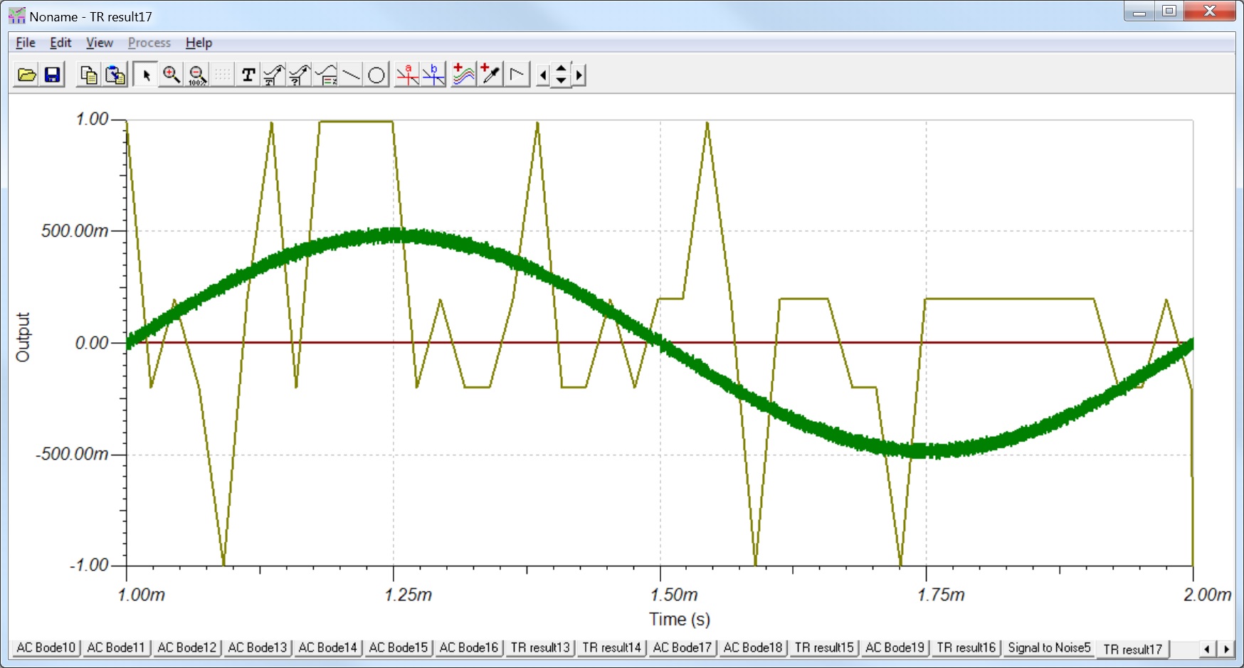

I have noticed that more complicated filters than RC, or multiple RC in series, mess with the current output phase. But a for example 3Kohm/1nF RC filter leaves a lot of noise in the signal even with DSD256. Current phase is OK. I have attached a picture of the transient run with DSD256. PM me for the test tone; it is too big.

Could you post a picture of measuring with 1K 3.3nF?
