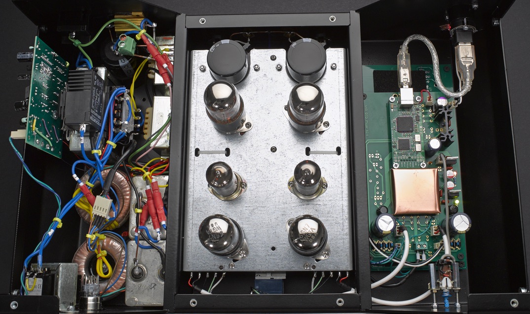

I am not clear how you intend to separate the left channel from the right, or do you plan to leave this in mono.
... You don't need a DAC to convert DSD to analogue, as it was never digital to start with but merely uses pulse density modulation to carry the analogue signal.
Actually, that is not quite right as the original source was digital, so the real DAC is the circuit which converts to DSD. It's just that the signal analogue used is not voltage but pulse density so people think it is still digital.

This all seems rather Class-D to me. Just duty cycle modulation of a square wave. Low pass filter it to get the audio signal. The audio signal is already there, you just want to get rid of the RF.
This puts an interesting spin on the Power DAC. If you could get the power output stage to switch fast enough, you could use the DSD signal to run the amplifier output stage. Sort of a Class-D direct.

The DIYINHK USB has the standard I2S outputs - data, LRCK (left right clock) and bit clock. But when playing DSD the e functions of the first 2 pins are reassigned. Data = DSD right channel. LRCK = DSD left cHannel. DSD doesnt need a word clock so its already demuxed. This is shown on my circuit diagram In earlier post.

I think everyone's on board this one but the challenges of good Class D sound reproduction are more difficult at higher power levels - perhaps what differentiates the approach in this thread is that the conversion to DSD is done at low power where common Class D issues (dead-time ?) are much easier to deal with and essentiallhy become a non-issue ?????

In my understanding the main reason power amps aren't just big DSD DACs is because of the number of switching transitions (well rather the frequency of those switching transitions). A classD (PWM amp) might have a 300-400kHz switching carrier typically whereas DSD64 has in effect a 1.4MHz carrier. DSD128 would double that.
With the newer devices becoming available (GaN particularly) there might be fewer disadvantages in building a 'DSD-direct' poweramp as GaN has lower switching losses meaning higher output switching rates become attractive.
<edit> I forgot that there's also the thorny issue of how to do feedback with DSD. PWM amps are linearized in practice by feedback but I'm not sure how feedback could be incorporated into a 'DSD-direct' amp.

Yeah, good point. The feedback loop would be a problem.
Switching at 1.4 MHZ might not be easy but 1/2 that is easy. I have many amps that switch that fast.

Changing the volume would require varying the rail voltages. There are ways that can be done, but it's unconventional.
There would be no feedback and it would be "what you hear is what you get," whatever that is. But it might work better than PWM with feedback.
I'm thinking an alternative method would be using a matched current source and sink. These might be switchable more easily than switching voltage sources. Volume would be changed by changing the output current(s).
hazard500, have you tried grounding the electrostatic shield of your Lundahl transformers? This will prevent capacitive coupling of primaries to secondaries, so could/should significantly reduce the unwanted HF present on the output. Less to tidy up after that.
Good point. I haven't but I should. If I get time on the weekend I want to put in a proper PS so will attend to it then.hazard500, have you tried grounding the electrostatic shield of your Lundahl transformers? This will prevent capacitive coupling of primaries to secondaries, so could/should significantly reduce the unwanted HF present on the output. Less to tidy up after that.

the wiring/construction looks a bit DIY to meA commercial link.
