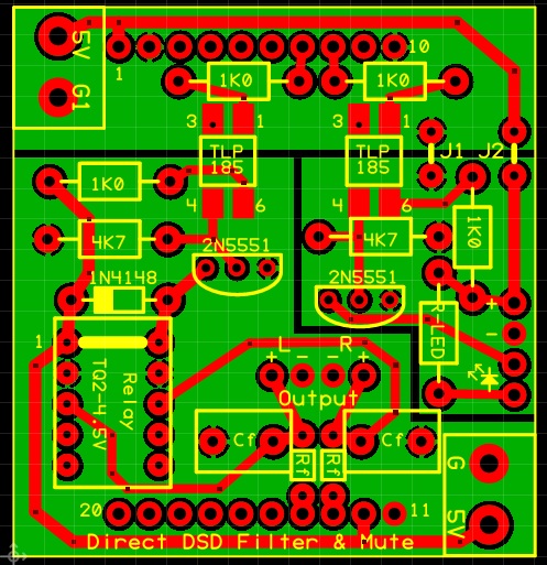

Also, learning from the input I received when putting together the flip-flop board, I have reworked my original simple filter and mute board. This now has the LP filter components very tight to the header pins and includes the DSD indicator LED circuit. I have omitted the DC blocking cap as it is easy to insert this 'in-line' or to use caps that existing buffers and the like might already have. I have attached an image of the revised board as an attachment. I plan to use one of these boards to replace the original simple filter and mute board in my prototype project to experiment with different blocking caps and to raise the LP filter -3dB point from 40KHz to 80KHz.

Is the TLP185 required? I believe you mentioned that it was to isolate the dirty signal from the clean power side?
The +5V and GND connections on your board is still tapped from the USB or dirty source right?
The TLP185s are to maintain the isolation between the dirty and clean sides of the JLSounds board for which this PCB has been designed, so yes they are required.
If you look you'll see that G1/5V points are on the dirty side whilst the other G/5V are isolated and on the clean side with connection only via the TLP185 optocouplers.
Both the clean and dirty sides of my JLSounds board have completely separate high quality power supplies, though it is possible to power the dirty side (and the clean side too if you want to compromise performance further) via the USB connection. There are jumpers to facilitate this on the JLSounds board.
The DSD LED indicator circuit, within the green polygon on the right of the board, has the option of a completely separate power supply (+/-) with the TLP185 maintaining isolation should that separate supply be grounded on the clean side, or, by linking J1 & J2, the LED can be powered from the dirty side in which case the TLP185 isn't really necessary but it also doesn't do any harm.
Ray

I see. That makes sense now. Thanks for the explanation.
