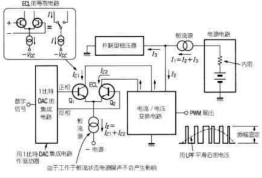

did anyone try current mode logic or emitter coupled logic instead of 74HC74?
it is fundamentally same topology to the famous "current pulse dac".

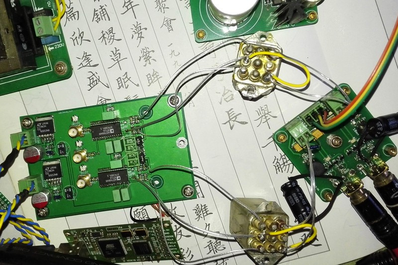

... something like this?
Jean-Paul
Yes, you're using transformers in a layout similar to Hazard's build. Jesper's sounds a little different in not having transformers and two passive LP filters, which I thought people might also like to see.
Yes. The correct method is to use ECL with CCS to weakening the PSU voltage variation and avoid amplitude modulation distortion.

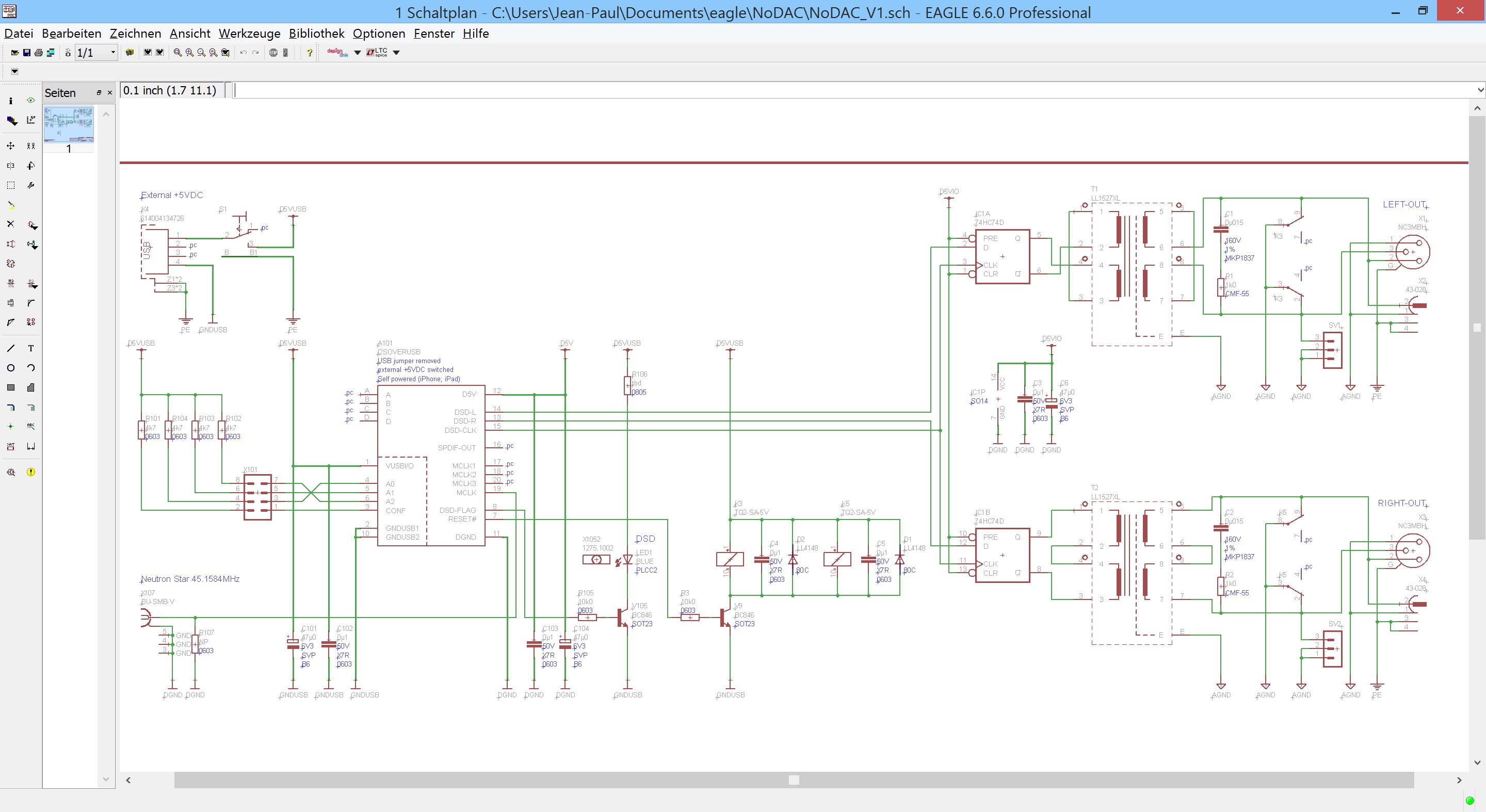

Hi All,
I take the weekend off but in reply to
... I will post a principle schematic on Monday.
Have a good weekend ;-)
Jesper
Do you have a schematic you could share?
Jesper

wow, what IC did you used? or discrete LTP? I dont have much experience of ECL.Yes. The correct method is to use ECL with CCS to weakening the PSU voltage variation and avoid amplitude modulation distortion.
tips
whether you use voltage DAC(74HC74) or current DAC(ECL), duty of each "1"( or "0") output should be less than 100% not to be influenced by intersimbol !"#$I forgot something.
It need double or higher clock DSDCLK , else feed normal DSDCLK to CLEAR of 74HC74 then it is 50% duty.

The principle is like the attachment file.wow, what IC did you used? or discrete LTP? I dont have much experience of ECL.
"Ultra High Frequency Transistor Arrays" can be used as discrete components. Note that the transistor alternate work in the either saturation or cutoff.

In other words, why analog FIR just as Jussi's dsc1 does, and why double differential architecture just as DSD1700 does?The principle is like the attachment file.
In my own practice, there was a alternative idea that a friend gave to me is to take a high-speed multi-bit DAC and only used its single MSB, pretty good sound experience. From no IC to IC return, effective but some madness.tips
Furthermore, I do not understand about the duty cycle as you said, noticed DSD1700 data table is also described that say 75% blabla.
