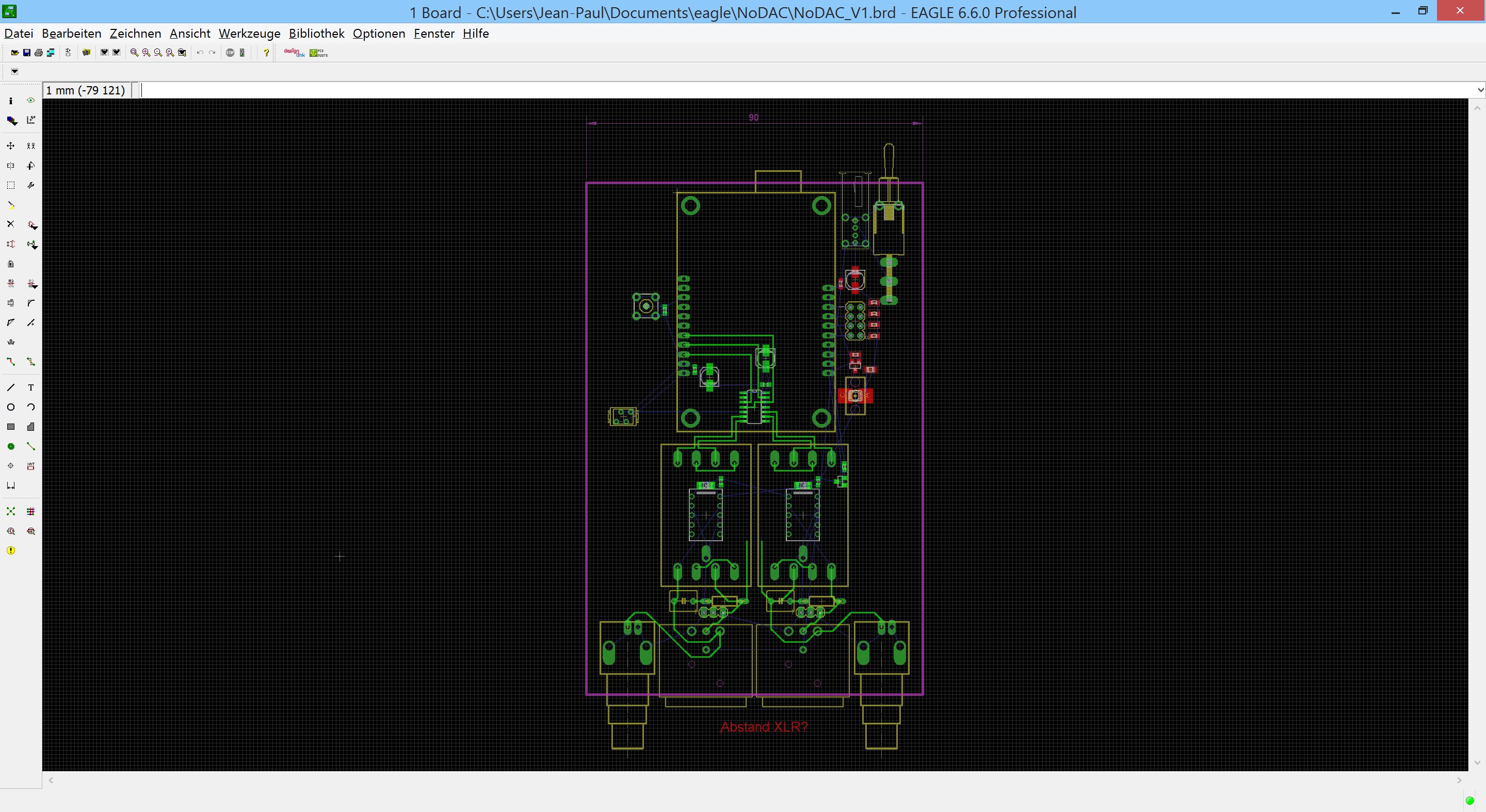

After getting my no-DAC DSD project up and running I have received a number of requests from people asking about the availability of the PCBs I had made up.
As I have now proved that the problem was a faulty relay and the boards work fine I'm happy to make the spare boards available to anyone interested in trying this DSD stuff out...
The boards are similar to the one pictured in this post (but are red instead of blue). They are designed to locate onto the header pins of the JLSounds I2SoverUSB board but could be used in other scenarios with a bit of creative hook up wiring.
http://www.diyaudio.com/forums/digital-line-level/273474-best-dac-no-dac-23.html#post4381033
The boards are not meant to be a definitive statement on the state of the art on DSD replay, just a cheap and simple prototype to find out what the fuss is about. There's no room for esoteric caps etc. so if you want to try that approach that's your problem to sort out locating them.
In my build, where I am only passing DSD256 to the USB board, I am not experiencing any pop or click issues but YMMV.
I have five boards available, first come, first served. PM me if you're interested and I'll give you a cost to send one to you, obviously dependent on where you live.
Ray

I believe I've replied to the PMs sent to me about the PCBs.
One thing prospective adopters might want to think about is the size of the DC blocking capacitor that was included in the original JLSounds schematic and which I carried forward into my initial project.
My understanding of these matters (and I profess no expertise) is that size of the DC blocking/coupling cap is defined by the load impedance and the required LF cutoff point.
The originally specified cap was 22uF and that will give a -3dB point of around 3Hz with a 20K load impedance. With a 100K load the -3dB point drops to 0.07Hz, alternatively, to retain the 3Hz -3dB cutoff with a 100K load you only need a cap of around 0.47uF.

@nautibuoy:
Hi - no I think your calculations are correct.
However, in my experience it's possible to make this without a coupling capacitor. By using a D flip-flop with a Q and Qnot (inverted) output the absolute DC level will be Vcc/2 (with a DSD signal), but since the output itself - the Q and Qnot pins - are self-referencing (differential output, i.e. not referenced to ground but to eachother) the resultant DC difference between the two pins in my experience is only a few mVs.
The clock for the D flip-flop is the DSDCLK.
In practice a simple setup can be the output pins Q and Qnot each followed by a suitable resistor and then there's a suitable capacitor connected between each of the resistor "ends" (the output side) to ground to remove HF noise from the DSD conversion process. Can be e.g. two 100 ohms resistors with a 15 nF capacitor to ground for an upper cut-off frequency of ~ 100 kHz.
A word of caution, though: This setup requires that the output be switched off (I short the output pins after the resistors with a relay) when there's no DSD signal. Otherwise the Q and Qnot pins will remain constant at either a high or a low level which quickly will give about Vcc on the output. With the Amanero board I have made this work, albeit not yet perfectly as I still get some rather loud clicks on the output. But maybe the JLSound's board is better here?
Jesper

Hi Jesper. it sounds as though your approach is not dissimilar to Hazard's;
http://www.diyaudio.com/forums/digital-line-level/273474-best-dac-no-dac-9.html#post4323177
except he's using transformers as his LP filters... Do you have a schematic you could share?
I've been reading back through this thread over the last day or two and I'm drawn back to some of the earlier posts that were looking at using the flip-flop approach to getting a differential signal and then using a TVC as the LP filter - very neat.
Ray
