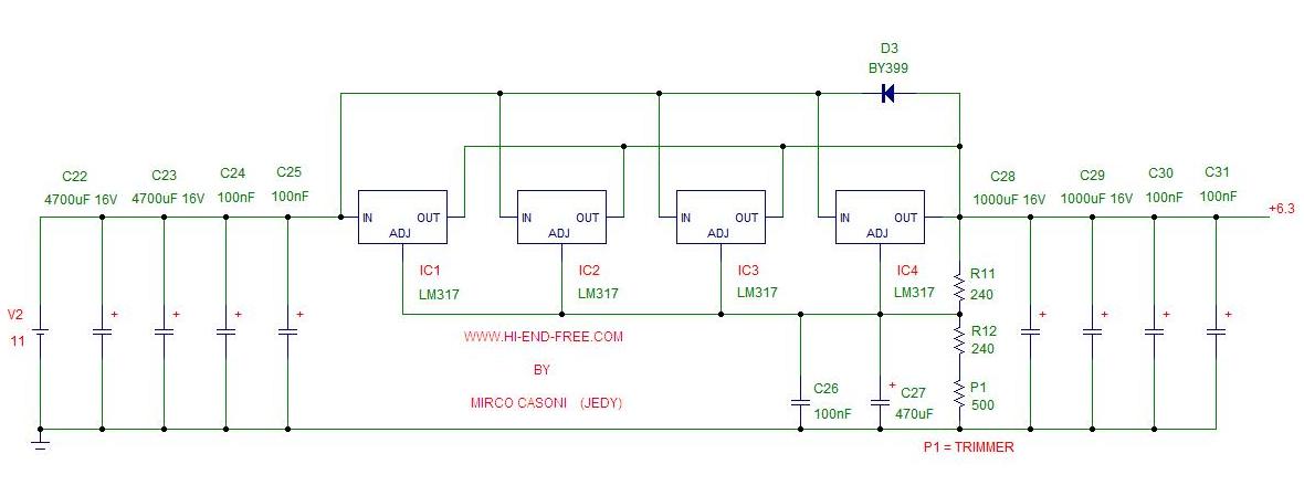

Electric Scheme of Power Supply for Filamants of EL86
Dear Mr. NAUTIBUOY,
in my preamplifier... the tension of anode arrives to + 295Vcc in about 2 minutes.
This increases a lot the duration of life of the EL86.
I prefer the EL86 VALVO because offer musicality more natural, real and "hot".
The other EL86 (Siemens, Philips, Mazda, etc...) have musicality cold and slow.
You utilize a small heat sink for mosfet M1.
You utilize a transformer with primary 0 - 230 Vca, a secondary of 0 - 234 Vca and another secondary of 0 - 8 Vca for the filaments.
Transform the tension of 0 - 8 Vca in continuous and stabilize to + 6.3 Vcc for the filaments.
The tension of filaments filtered and correctly stabilized to allows of get a high S/N.
I later send to you the electric scheme for filaments.
Thanks and All the Best,
JEDY

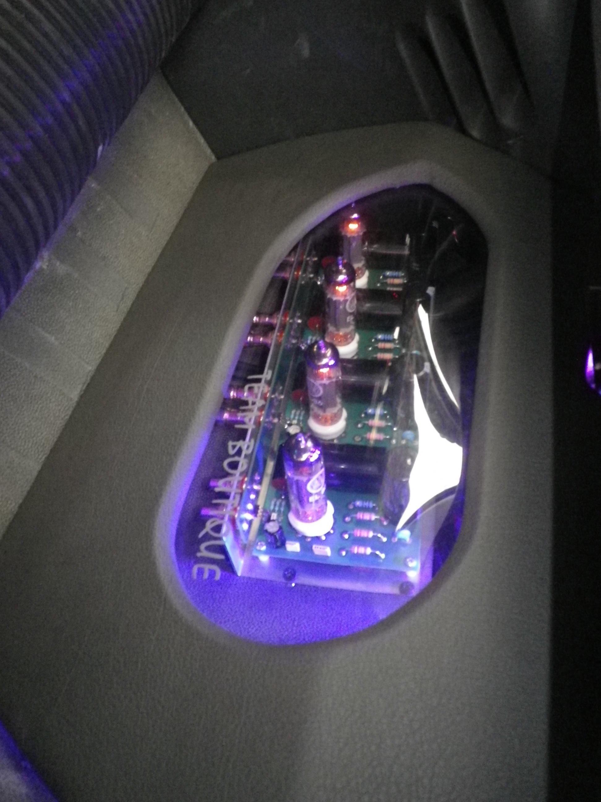

JEDY 4 Way Preamplifier with EL86 VALVO for DSD DAC
Dear Mr. NAUTIBUOY,
is very very important !!!
You separate the tension of +6.3 Vcc and his GND from the other tensions and GND of all the project !!!
I'm SORRY for all my "English error" :<(
JEDY

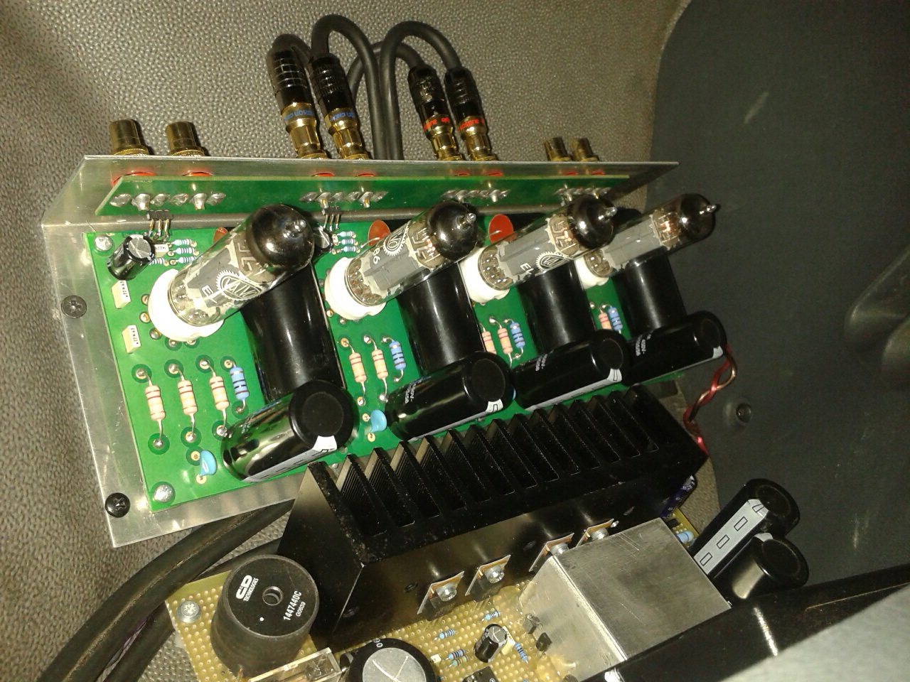

Dear Mr. NAUTIBUOY,
this is the 4 Way Preamplifier with EL86 VALVO.
I utilize this Preamplifier in important car audio audio demonstrations and with great success.
This Preamplifier have linearity from 10Hz to 150Khz with +/- 0.1 dB.
The DC/DC converter utilize the power supply that you see in this page ... with IRF840.
This sistem to make arrive to life of over 20000 hours of utilize.
Have a Nice Day to you and All your Dears,
JEDY

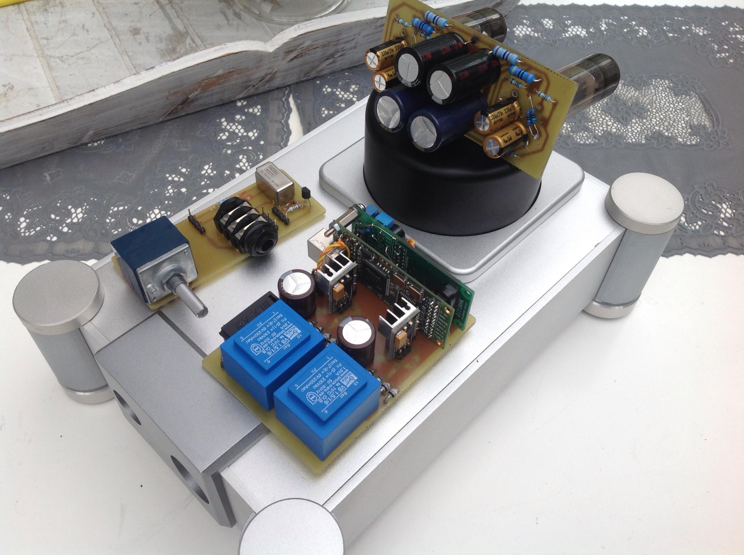

All the parts are arrived. I tested today the dedicated power supplies for the amanero board and isolator and it works great. No noise, humm or other sounds. Noise level is below -100db( that is the limit of my measure equipment ). So it is time to build everything together. I have now ready the USB to DSD board, tube headphone/output amp, volume and muting controll and a nice housing.
Summary:
- Amanero USB to DSD with dedicated tps7a4700 power supply.
- Isolator ISO7640fm with dedicated tps7a4700 power supply.
- 4th order lowpass LCLC filter.
- Coppling capacitor.
- ALPS volume control.
- 6n6p tube headphone/output amp.
- Relais muting circuit.
Thanks Martin.
Jambul, i can not answer your question because your message box is full.
But my answer is also interresting for other people.
Below a summary of the cost of the
Amanero board- €85,-
Isolator board and parts- €10,-
2 x tps7a4700 power supply, pcb and parts- €60,-
lowpass filter- €10,-
So for the basic setup capable of driving a preamp. Vout is 3,7Vrms. The cost are €165 without housing.
You are free to use any headamp and/or housing.
I build,
6n6p headamp,pcb and transformer - €80
Alps volume control and muting board - €30
Housing from ebay - €125
So my total of cost is €400,-.
There is a good alternative as headamp, the wire design. Or as i have written about in thread " just for fun".
