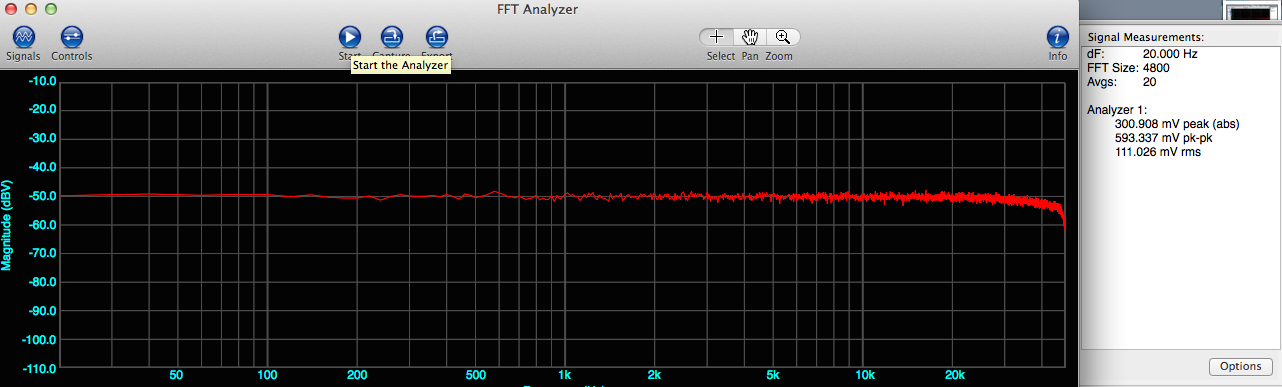

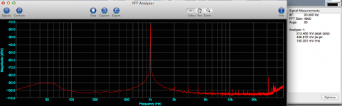

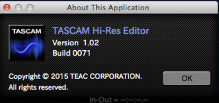

Hi Mterbekke, I found some amateur measurements of the initial circuit. (lap top input, software Electroacoustics Toobox.) I think that the circuit was with Beyer dynamics input transformer, and maybe with Single ended JFET buffer after the xfrm. No any filter (ecept xfrm transfer...)
I used Tascam Hi-res editor (osx version) software for playing different formats measurement files PCM and DSD. It is not bad at all. I think that only accepts WAV and DSD files? (Does not want to play AIFF od FLAC...)
Looking nice Zoran, thanks for sharing. I don't know what to make of the second pic though, any idea why the measurement signal isn't there yet should be there?

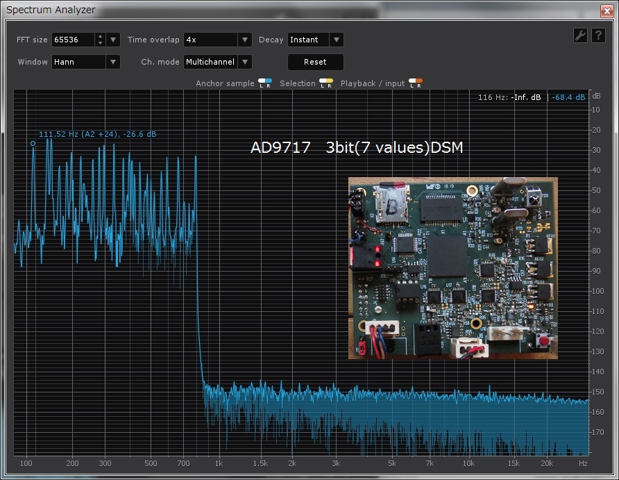

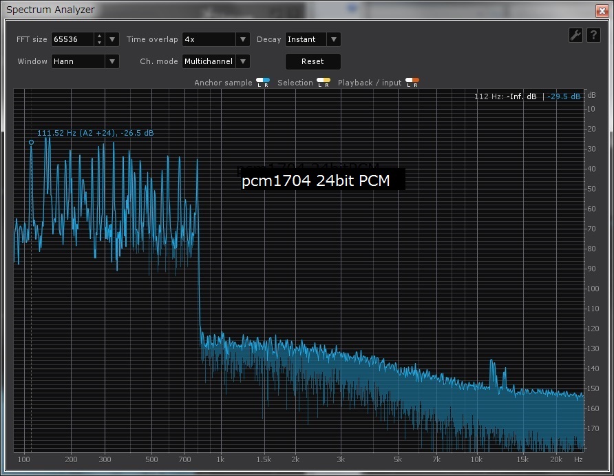

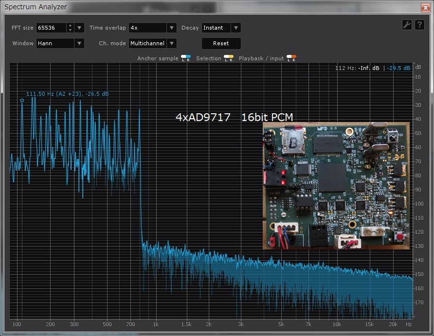

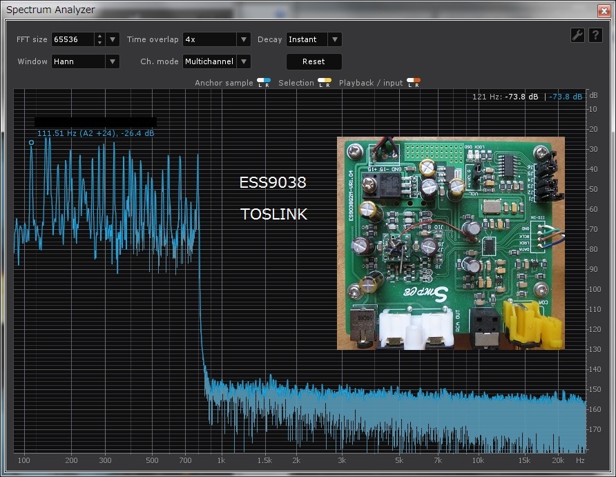

High sampling rate like 768kHz/24bit isn't the dominating factor to have excellent quality, IMHO. One reason is that my files are ripped from vinyl which doesn't mean wide range. I usually use 96kHz/24bit. SPs and monaural LPs are decimated into 48kHz/24bit. Stereo LPs are 96kHz/24bit. I don't have files deserves 768kHz, though my SD card reader can work at 192kHz/24bit. But even in PCM, OSR is the same as DSM(x64,x128,x256, and x512) because of the high sampling frequency of AD9717.
AD has many communication DACs for W-CDMA. AD9717 is one of them. The most powerful one(AD9747) is 16bit@250MHz and 32mA with RZ function. I, of course, tried it and failed. Besides AD971X, communication DAC is less SNR in the audio band. Their playground is RF, not the audio band. That's why AD971X has the less current drive(up to 4mA). Low current supply brings you high SNR in the audio band.
It's surprising to change my favorite chip since I have been with pcm1704 for 20 years. But now is the time to design 1bitDSM. IMHO, 1bitDSM lives in another dimension, where no DAC chip exists; in other words, no DAC chip related limitation exists. DAC chip(including AD9717) is inferior to OP-amp in SNR by almost 20dB, i.e., noise power of DAC is 3uVpp,OP-amp is 0.3uVpp. If your DAC consists of discrete transistors, you are free from the inherent limitation. It's worth designing, especially for a DIYer because monolithic DAC is impossible but discrete one(FPGA and transistors) is possible and very promising to have extraordinary high SNR for classical music.🙂
Here are some pics about noise floor modulation. 1st pic(AD9717 in 3bitDSM) is the best one so far. The input is band-limited music file(Toccata and Fuga in D minor). If your DAC is ideal, more than 800Hz must be the noise floor with no fluctuation. 3bitDSM is better than 2bitDSM. The 2nd is also AD9717 in PCM, where the noise floor gradually increase. The 3rd one is my previous pcm1704. The difference between DSM and PCM is audible for me, though it's subtle. The 4th is another champion made in eBay ES9038. TOSLINK is better than DSD because TOSLINK doesn't have inherent 6 dB degradation in SNR.
On the second picture is white noise. I forgot to say that I deliberetly did a sort of worst case scenario, with typical moderate power supply
