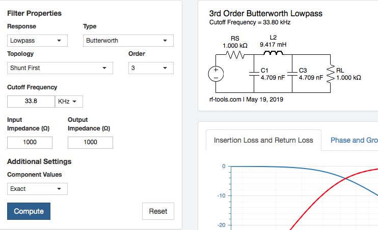

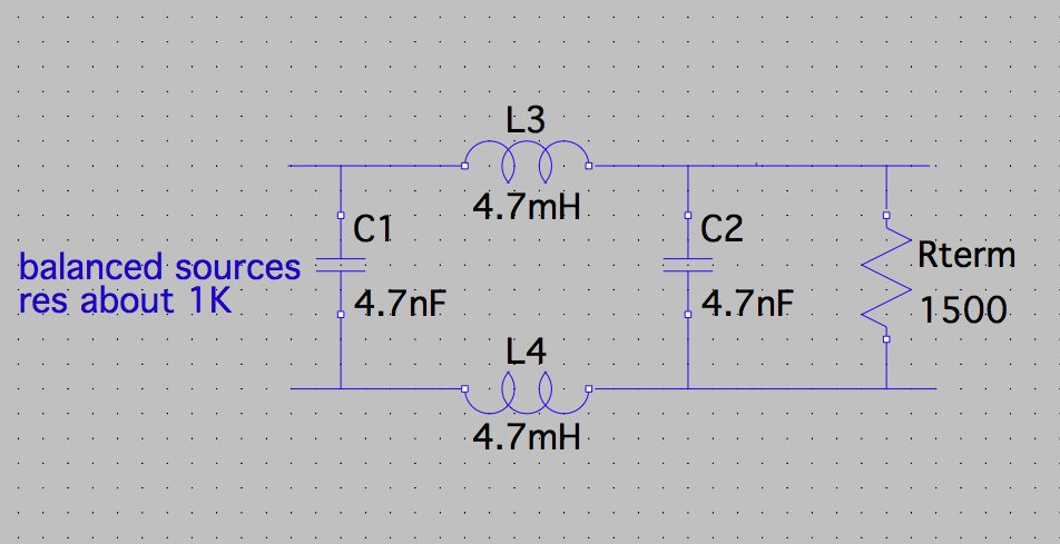

Koldby You said that You have issues about the noise. I have good results with ballanced filter quickly made with a help of these online calc.
RF Tools | LC Filters Design Tool
I used 3rd order simple butt (because of same values...) LC Fo about 33KHz Zo 1K cca.
shunt mode option. in balanced config L is the 1/2 value for the each line C remains the same value. Measured about just -16deg @ 20KHz shift (diskrete R2R balanced dac (Rout 1KHz cca), 4.7nF-4.7mH(in each line)-4.7nF 1.5K load - interstage transformer secondary load 1.5K

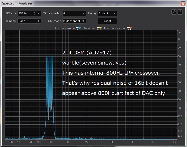

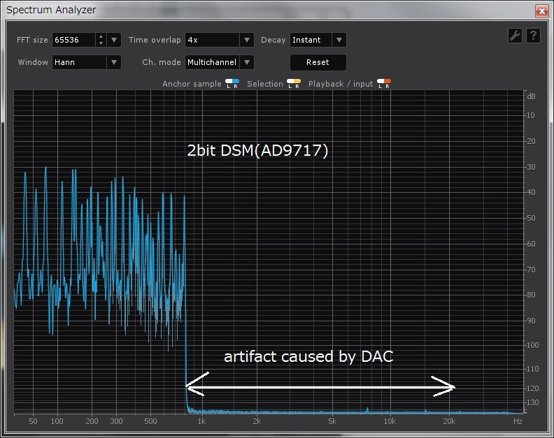

What I meant is residual noise in silence. The 1st pic is my music file ripped from vinyl released in the 50'. It has of course relatively large residual noise(-58dB). This is audible for me. But if you can decrease residual noise by 10dB(-58-10=-68), It's gone away, i.e., non-audible. That's why -93dB is completely non-audible for me.
But I have recently found human ear isn't so simple as you wrote. I have been a multibit lover for 20 years like pcm1704. After being obsolete, I managed to design an alternative one with AD9717 which can output both PCM and DSM. PCM is almost -100dB THD while DSM is -120dB THD. I thought DSM is an alternative of PCM mode because I'm a big fan of pcm1704.
Measurement data and listening test blew away my prejudice. DSM was way better than PCM mode and pcm1704 in my 20 years' memory. Pic.3(PCM) and pic.4(DSM) is distortion caused by DAC. The input is real music(pipe organ) with large spectrum in low frequency, where the bandwidth is limited to 800Hz. If your DAC is perfect, no spectrum exists above 800Hz. Real DAC outputs some distortion caused by real music. Both distortion levels are very small(PCM=94dB, DSM=108dB) but I can completely hear the difference. The lower, the better. If I can manage to have more than -120dB, I will name it a paradise.

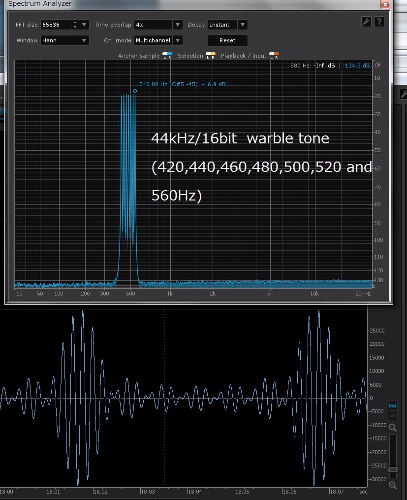

Yes, I'm sure THD+N highly depends on what is being replayed. From this point of view, a single sine wave means only measurement number, can't tell you something about SQ. If you use warble tone(420,440,460,480,500,520, and 540Hz) like the 1st pic, you can see the real performance of your DAC. This is "DAC killer," which is a challenging file for DAC to generate no artifact.

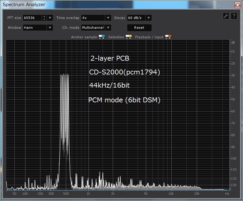

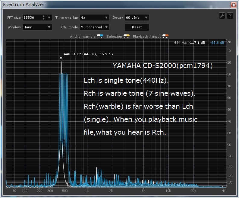

The 2nd pic is FFT of YAMAHA CD player CD-S2000. A single sinewave(L ch) is a standard performance of 44kHz/16bit. Rch(warble tone) has many IMD and harmonic distortion worse than Lch. This is probably poor PCB implementation. Warble tone requires stable ground and power, but two-layer PCB can't offer the optimum environment. Real music file wants further stability because it has much spectrum than simple warble tone. That's the reason 1kHz sinewave tells you nothing about SQ.

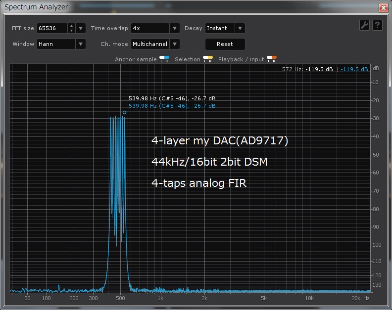

The 3rd pic is my DIYed DAC(AD9717) configured to 2bit DSM. It still has some IMD. I don't know "noise floor modulation" claimed by Chord in details. If it means fluctuated noise floor caused by the replayed file, I can agree with him. It strongly dominates SQ. The best DAC to achieve low "noise floor modulation" is 1bit DSM(DSD), the ultimate weapon to decrease it.

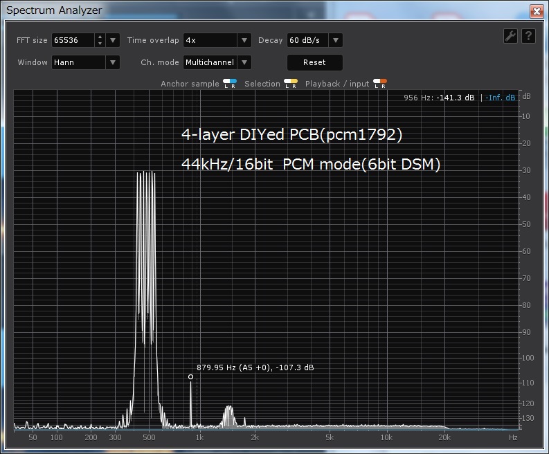

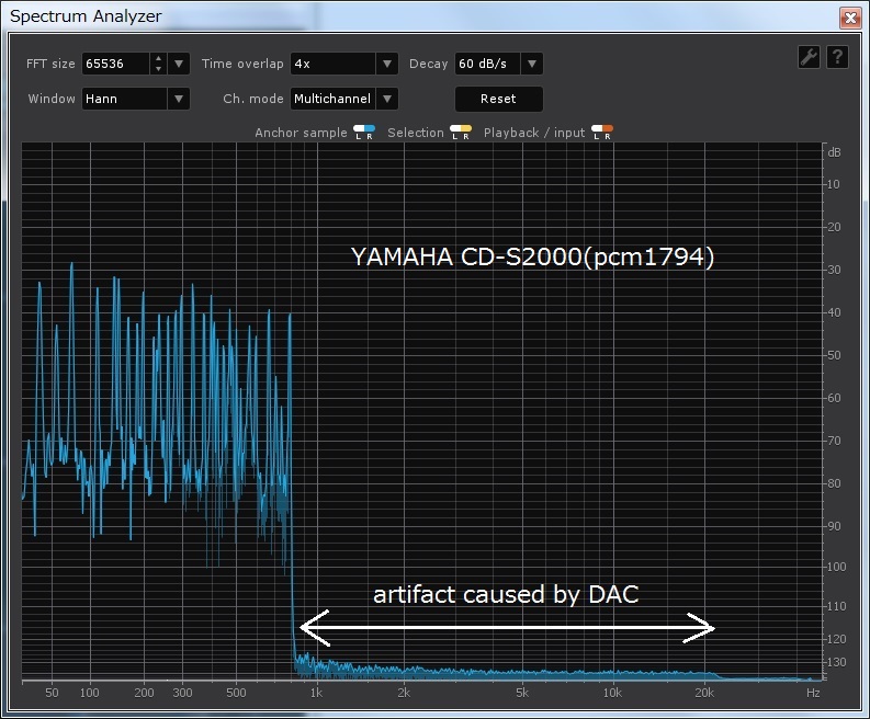

CD-S2000 with poor performance in warble tone generates artifact in real music playback, the 4th pic. My 2bit DSM(the 5th pic) is better than CD-S2000. Noise power of the artifact of CD-S2000 is -98dBFS. It was surprising to me that I could hear the difference between -94dBFS and -108dBFS. My listening test is always normal music, not bandlimited one.
I figured your listening test was with full bandwidth music but I had to ask, anyway. Yes, it is a bit of a puzzle as to why this is audible - either we are not seeing it's full measured effects when full bandwidth music is playing and/or we are using a simplistic understanding of auditory processing & assuming that -94 to -108dB is not audible?

Hi Zoran,
would you mind drawing a simple sketch of your balanced Filter?
Greets, Klaus
Hi Klaus
I used settings from picture butt, hat is for SE. And with 1/2 value of L added in booth lines for balanced. I use butt, but You can use Bessel. Try to get values close to standard. Will be useful to know the internal resistance of the source. For the termination I suggest to measure. IfYou are win user You have great soft called ELSIE for designing filters. I find this online calc tool very helpful
cheers

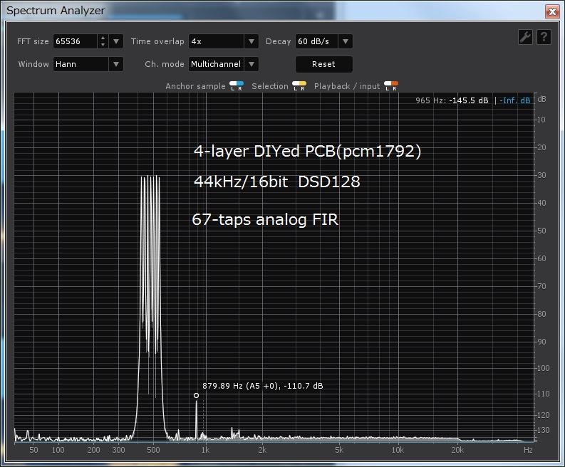

Artifact caused by tough input signal strongly depends on PCB quality and DAC technology. The ideal DAC doesn't generate artifact even if the input is real music, which has significant amplitude change in many frequencies, where ordinary one fails to output the same waveform as the input. The 1st pic is pcm1794 in PCM mode. The 2nd is pcm1792 in PCM mode. The difference is probably the PCB structure. Both are 6bit DSM. The 3rd harmonics around 1.5kHz is the consequence of accuracy error in 6bit DAC inside the chip. It's not easy for the chip to keep high accuracy to prevent 3rd order distortion even if it is well-designed.
The 3rd pic is pcm1792 in DSD128. Pcm1792 has dedicated converter from DSD to analog(67-taps analog FIR). It's superior to PCM mode because no accuracy error exists in DSD(1bit DSM) though some 3rd order still remains. I don't know where 879.89Hz(2x440Hz) comes from, maybe internal distortion inside the chip or external I/V converter. Anyway, DSD mode is usually superior to PCM mode in modern chips, ESS too. I guess pcm1792 can't make the best of DSD mode because of its architecture. Single low supply voltage forces pcm1792 to have a current output and a user to design distortion-free I/V stage. Recent high output current to ensure high SNR makes the design far difficult. I would recommend the best I/V is no I/V. No I/V topology, as well as no DAC, is the ultimate. Discrete no DAC topologies like Chord or PS audio, i.e., FPGA and discrete transistors.
The 4th pic is current my DAC, where FPGA and DAC chip(AD9717) are used for 2bit DSM with 4-taps analog FIR. It's not ideal because the best is FPGA and transistors in DSD(1bit DSM) to achieve low noise floor fluctuation. I'm now under construction what is the best conversion from digital to analog without I/V by transistors. FPGA has already finished successfully because the digital domain is easier to design than the analog domain. Once you have fixed it, you have no problem forever. Emitter coupled circuit like ECL with 16-taps, is a major candidate now.:)
