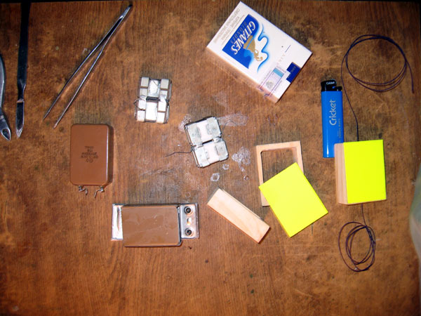

Russian silver/mica SSG-3 220nF 350V 5% the best sonic.
Stripped more better. Like any woman.... 🙂

stripping caps you expose them on open air with a moisture. Better wrap it carefully. For example, polyethylene is one of the best dielectrics, but it is underestimated because it melts in low temperatures, so is unusable for military purposes, but great for home audio insulations.

Anatoliy, that's correct. But we are not in the sea, are'nt we? 😀
Steel around cap is worse, but other dielectrics compromise sound too. It is not in spite people choose wood cabinets as I did on the picture. Sounds better - just devil knows why.
These caps I use aprox 1 year and didn't get moisture yet. Where from could it sneak in tube amp? 😕

From the air. When you switch your amp on, it heats up. When you switch is off, it cools down and adsorbs the moisture.
Ok, sure I know where from, just joking. But I prefer that risk. Simply change cap not a problem. As I told, have'nt got wet for a while. They was parafined very thick, i melt it down but could not avoid all stuff....
Souds very rich and deep, would advise to try silver & mica. Even in original boxes. Stripping add an air in sound, getting more space. Seems to be room expands. 🙂

Hi igormak, I share your preference for the SSG and bought a couple dozen 0.22 uF 0.3% before they disappeared from Ebay. Two questions, is the case aluminum or steel? The picture suggests aluminum. Also, did you mean the entire can is filled with wax?
One thing to watch, under high voltages silver can be prone to a phenomenon know as migration. It literally creeps across the surface of the dielectric and worst case short between layers. Seeing as the Russian Teflons maintain an air dielectric between cap and case if the silver micas are filled with wax I suspect it could, in part, have been to prevent migration. You might want to consider leaving a thin layer on the cap.

Hi, RDF.
SGS is in steel. I buy them in Moscow quite easy, never tryed EBay.
Yes, the entire can is filled with wax and very tought.
As about migration.. there is a thinest wax layer.
How could this effect reflect itself do u think?

They were in copper when I disassembled them being a kid. 😀

If you don't believe in Physics... Idunno.... But if believe a little bit, the silver is conductive...

Are you shure it was SSG? It done for war (as everything 🙂), and russian militaries always feared radiation. They are steel and
thick enought. 🙂
